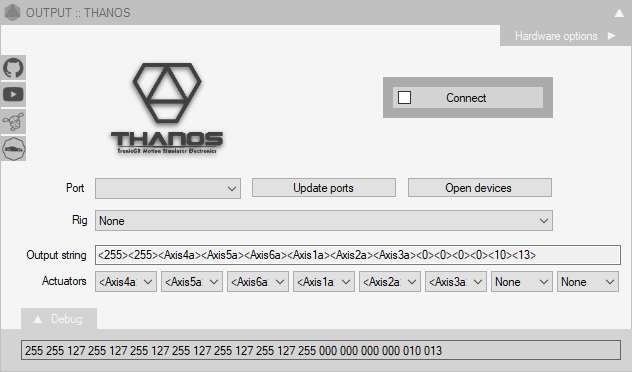

  8. C1500
    C1500 Active Member
    Nov 19, 2018
    165
    1,119Coins
    +86 / 1 / -0
    AC motor, 6DOF
    Hi

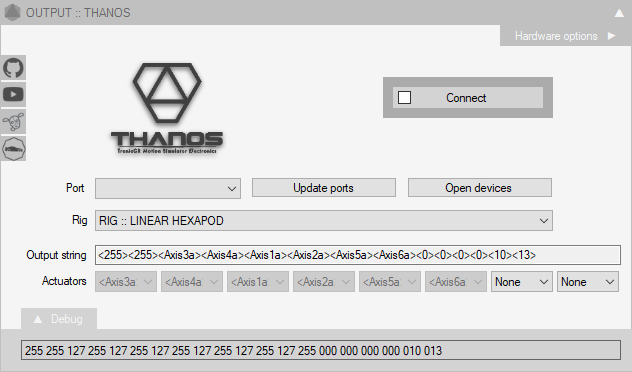

    here are my settings in Outputs-Thanos
    I have rised the spike-factor from ~4000 to ~10000 but still stuttering.
    It is now much faster but not better.
    I also tried to set all Filters in "pose - from motion" to "value" so there is no filter active. but still there is the stuttering.
    My last try was to deactivate "ground" as input but also no change during flight.
    I have never seen this stuttering in any racing sim like Dirt Rally 2 or F1
    Also in DCS i can´t find this stuttering with the same settings as in FS2
    Has anyone any idea what i can test or change?
    PLEASE HELP !!!! ;)
    Peer
  9. hexpod
    hexpod http://heXpod.xyz
    Apr 18, 2016
    1,203
    berlin
    7,738Coins
    +372 / 5 / -0
    DC motor, 6DOF
    I wonder how this string can work properly
  10. C1500
    C1500 Active Member
    Nov 19, 2018
    165
    1,119Coins
    +86 / 1 / -0
    AC motor, 6DOF
    Hi
    Do you mean the output string? It works perfectly.
    In the beginning i had the connection as shown in mover but Thanos used another counting.
    So i reconnected all that it works in mover 3.x.x
    Since 3.3.5 FlyPT chenaged the order so i reconnected all again.
    Motor 1 is now front left and then cw. (As shown in mover)
    I have a hunch.
    It runs smoothly in car-simulation. Here, however, the movements are also considerably less than in the flight simulator.
    I suspect that it is due to a filter setting that does not cope with the larger movements.
    But why does the stuttering occur even if I set all filters to "value"?
    Any other ideas?
    regards
    Peer

  12. hexpod
    Apr 18, 2016
    1,203
    berlin
    7,738Coins
    +372 / 5 / -0
    DC motor, 6DOF
    3-4-1-2-5-6 instead of 3-4-5-6-1-2 was a modification on demand or it’s a mistake ?
    shall we abandon the compatibility standard with BFF Software and rewire everything or revert back to 3-4-5-6-1-2 ?
  13. pmvcda
    pmvcda aka FlyPT
    Nov 3, 2010
    2,180
    Portugal
    15,394Coins
    +2,601 / 17 / -0
    Mover order is #1 front right and increasing to the right in clock order, so #6 is the front left actuator.
    What I want is to have the order used by Thanos, where #1 is rear left and increasing in the clock order also, so we have:
    Thanos -> Mover
    #1 -> #4
    #2 -> #5
    #3 -> #6
    #4 -> #1
    #5 -> #2
    #6 -> #3
    The default in Mover right now is:
    Number 1 in Thanos should be Axis4a. So it's wrong.
    Problem here, is that I', guilty of this mess, because some people started using the wrong order.
    In practise we can just swap the connections in the controller, but I will correct the order.
    I think it should be:
    Or am I looking it wrong?o_O
    I think Thanos uses the BFF order

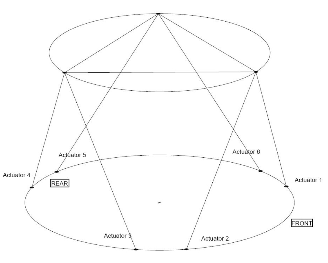

    To my knowledge nr.1 is back right, (or front left depending on how you position your cockpit front/back orientation) that’s why the conversion string 345612 from your numbering 123456 to @Thanos stuff makes sense. @benmax can maybe confirm my assumption.

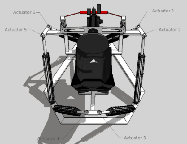

  15. C1500
    C1500 Active Member
    Nov 19, 2018
    165
    1,119Coins
    +86 / 1 / -0
    AC motor, 6DOF
    Hi
    On most rigs i know, the front is between the shorter distance at the lower mounting points (2 and 3 in picture above).
    In your description it is between lager distance (1 and 2)
    I used the counting shown in mover (The front is between 6 and 1):
    When i move the actuator in the menu, the correct actuator is moving at the rig.
    But this is not my problem, this is working for me
    I have no problem to reconnect if you change it once again.
    Back to my problem.
    I´ve tested it with sinus wave on "roll position" and "pitch position"
    If i reduce the period there is the pint where the rig does not go to the endpoints.
    It seems the speed is not high enough to reach the endpoint.
    The rig could go much faster, but somehow it seems to be limited.
    In this test I had deactivated the spike-filter in AMC.
    And still there is no stuttering.
    When i change from roll to pitch by clicking the checkboxes, the rig makes a heavy jump to the new position

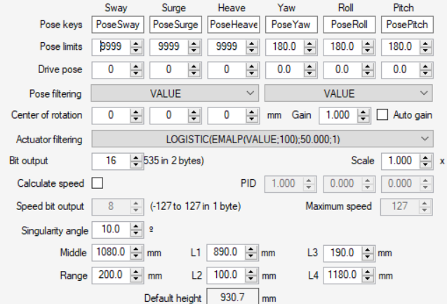

    but still no stuttering.
    Can someone with good knowledge of filter can pleas have a look to the settings?
    Maybe it is something in here:
    Regards
    Peer

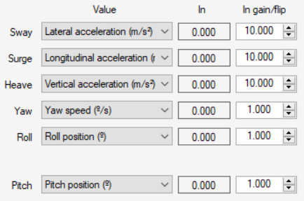

    Maybe i found something.
    I´ve tried once again the sine-simulation.
    When you start a new source:loop the following check-boxes are active:
    But as you can see in next picture, Yaw Position is not used in "Pose-from motion":
    Is this setting correct or should it be "Yaw position" in the Yaw settings?
    Sorry for the stupid question
    regards Peer
  17. hexpod
    Apr 18, 2016
    1,203
    berlin
    7,738Coins
    +372 / 5 / -0
    DC motor, 6DOF
    It’s perfectly logic to take the front “between the shorter distance at the lower mounting points” in @pmvcda counting act. 6-1.
    Achieving the same with Ian counting it is between act. 4-5. So the conversion should look like the following:
    1 flypt - 5 BFF
    2 flypt - 6 BFF
    3 flypt - 1 BFF
    4 flypt - 2 BFF
    5 flypt - 3 BFF
    6 flypt - 4 BFF
    So consequently the string for @Thanos boards should be 3-4-5-6-1-2
    I hope it makes sense.

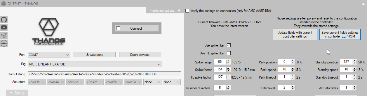

    First i made some tests with and without spike filter.
    If i deactivate the spike filter in AMC i can fell any stuttering anymore.
    BUT not caus there is no stuttering, cause the whole movement is in slow motion mode.
    Just like a always active spike-filter.
    I searched again in mover settings and i found that there was a difference between range in AMC and mover.
    In mover it was 200 and the stroke in AMC was 360mm
    So i measured the whole rig once again but found only minor differences.
    I had no idea why I set "scale" to this value (0.800) and set it again to 1.000
    That was the baddest or worst decision of the weekend.
    I made a short test and the rig moved out of its limits and the bracket for the pedals rammed into the aluminum sleeve that runs around the ball screw. Then the upper bracket tore off and the motor fell to the side. The falling rig tore off more parts.
    Just think positive: YES there is no stuttering anymore cause there is NO movement anymore.
    Live goes on - let´s go printing

    @Thanos @pmvcda
    Do any of you have any ideas on how I can prevent a crash like this?
    Is the scale possibly to blame for the stuttering?
    Why do the motors run so slow when I turn off the spike filter in the AMC-AASD15A?
    Can someone please take a look at my settings to see where the error might be?
    I know that the motors can run much faster. But what slows them down?
    please help
