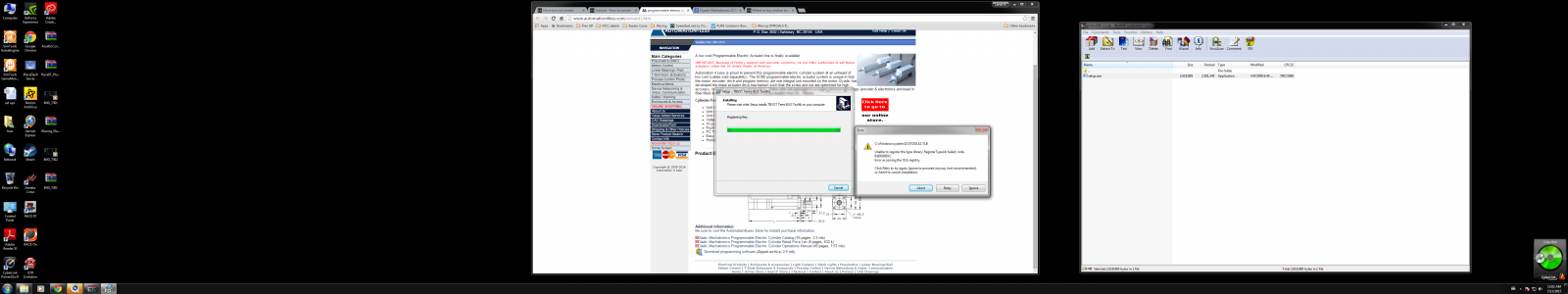

    Doesnt let me install mate

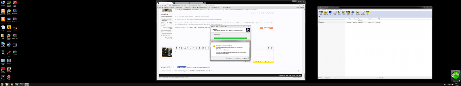

    It show this inn lower left conner
    And then show this
    Doesnt allow me to do it

    Sorry I can't read anything from the screenshot. Can I presume it is the SCN5 software that is not installing and if so are you running the installer as administrator, as per the instructions?

    The error said like this:
    "c:\Windows\system32\STDOLE2.TLB"
    "Unable to register the type library: Register TypeLib failed code0x8002801
    Error accessing the OLE registry
    Retry to try again or Ignore to proceed anyway (not recommended)
    Or Abort to cancel installation"
    Base on previous screen shots and videos, is there anything that i miss? I really do follow all the procedures that it shows.
    Im so so sorry about it.
