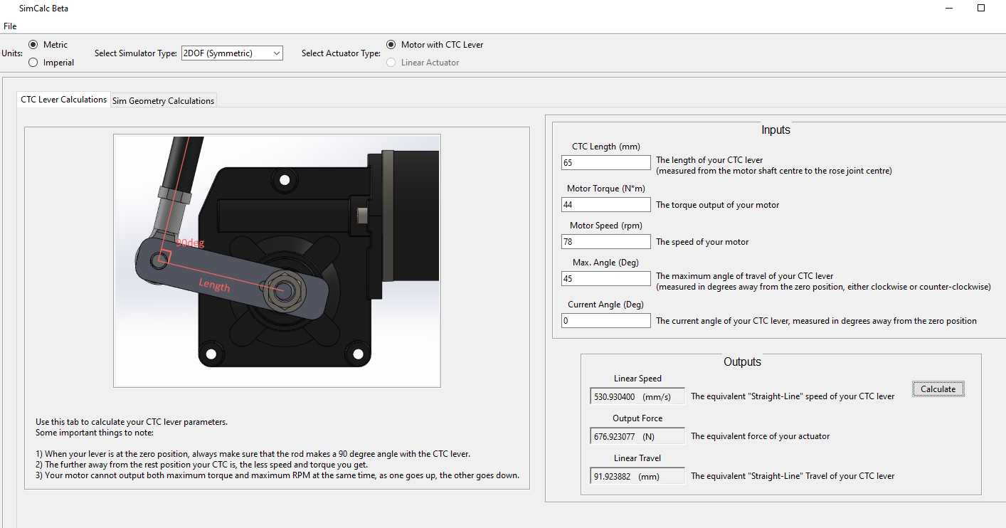

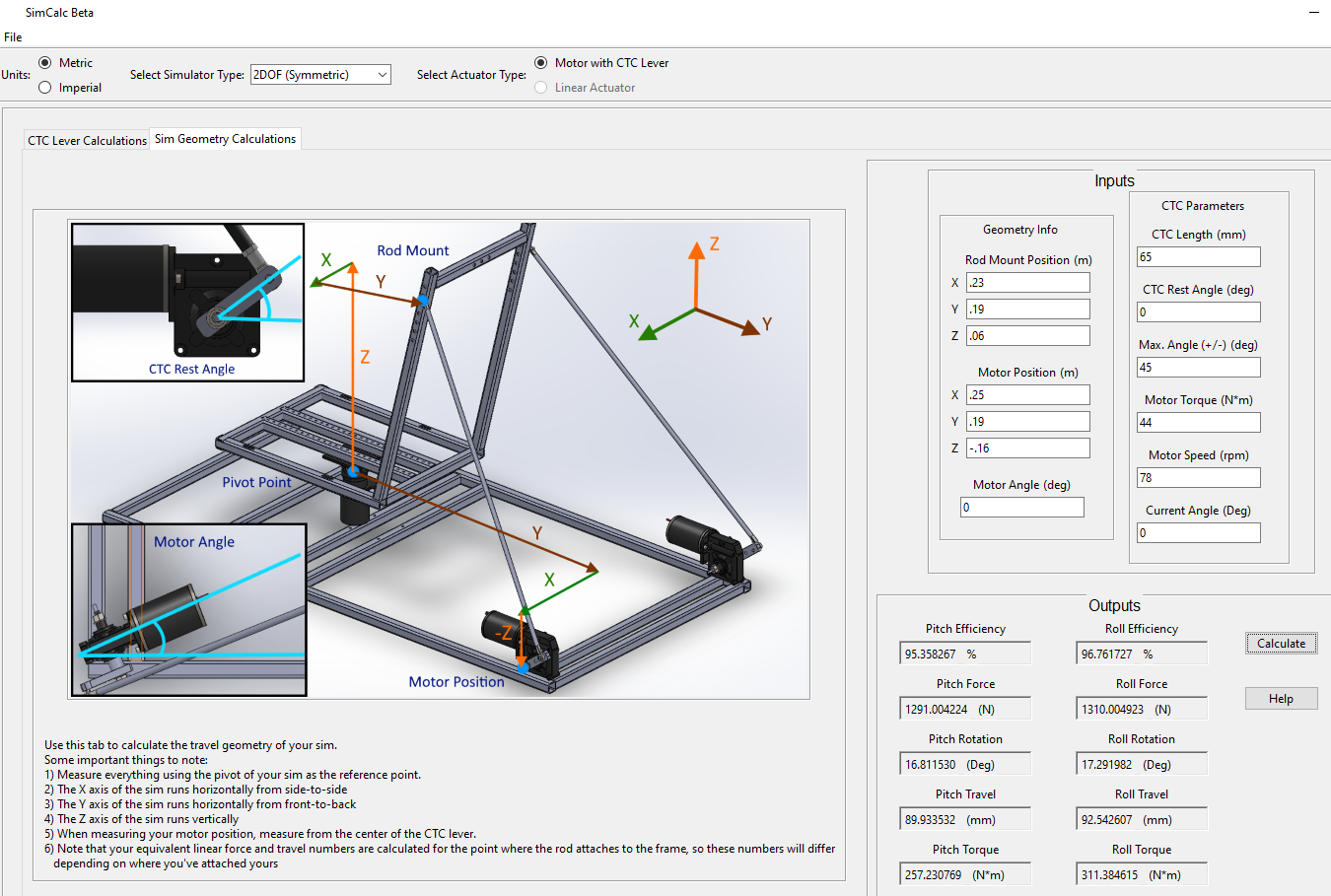

    Thank you for your suggestions. I am very much considering them, but I was hoping the knee position with full frame design would work with the motors I selected. In using SimCalc, on the first tab it suggests that my current motors, levers and positioning are good for 677 N of force. On tab 2 it indicates with my dimensions put in for the knee motors, I should achieve a Pitch force of ~1300 N. I attached screen shots. In your opinion, is this not enough force for the knee motor position given that the frame, wheel, pedals and driver load is approximately 125 Kilos? I also attached my motor specs. I would appreciate any feedback. Thank you.
  13. noorbeast
    21,514
    150,704Coins
    +11,018 / 55 / -2
    Disregarding mechanical loss, to know what Newtons it will take to move something it will be Mass (kg) x Acceleration (m/s) = F (N). So to move 100kg at 0.7 m/s needs 70 N. It takes 9.8N per kg to counteract gravity. Keep in mind there is significant mechanical loss in things like the gearbox, depending on the ratio you may want to allow between 10% to 50% loss for worm gears and the greater the gear ratio the higher the % loss is: http://www.meadinfo.org/2008/11/gear-efficiency-spur-helical-bevel-worm.html

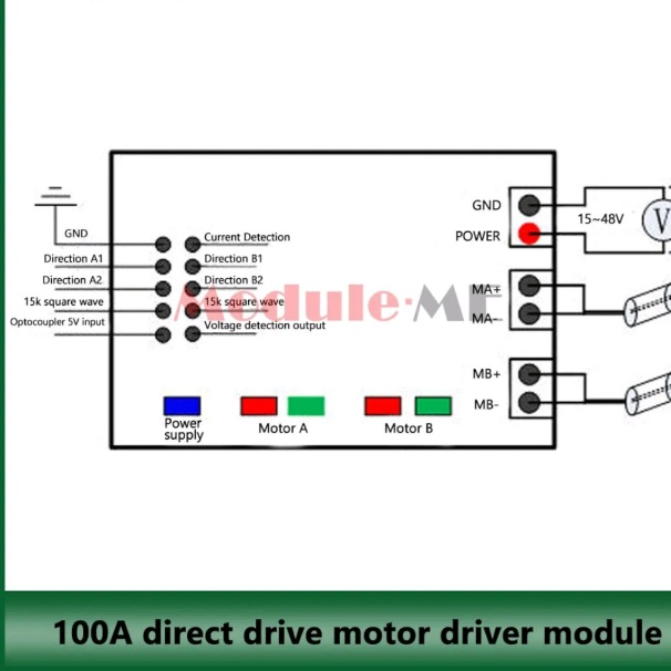

    Hi Gadget999, I purchased 3 of the 100A controllers at your suggestion and should have them in 2 weeks. From the pictures of the product I see the pinout is written in Chinese, did yours come with instructions in English? Also can you recommend how to wire them for a 3 motor 2 DOF with traction loss? I know they each can control 2 motors, so I bought a spare, or I could use all three and lighten the load on the controller. Right now my Arduino sketch is set up for Mode 2 because of the IBT2. I will need to change that to Mode 1, is that correct? Thank you for your recommendation and assistance.

    The advert shows the wiring pins
    It needs 2 direction pins and a pwm pin

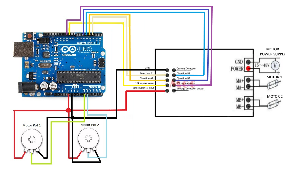

    Thanks! So for this 100A controller, do you agree that this would be the appropriate wiring diagram?
    Do you know what are the two unused pins Voltage and Current Detection can be used for?

    that looks good, i don't know what the other pins are for. I don't use them.
    I suspect these pins go high if the voltage is not between 12v and 60v and the current is too high
