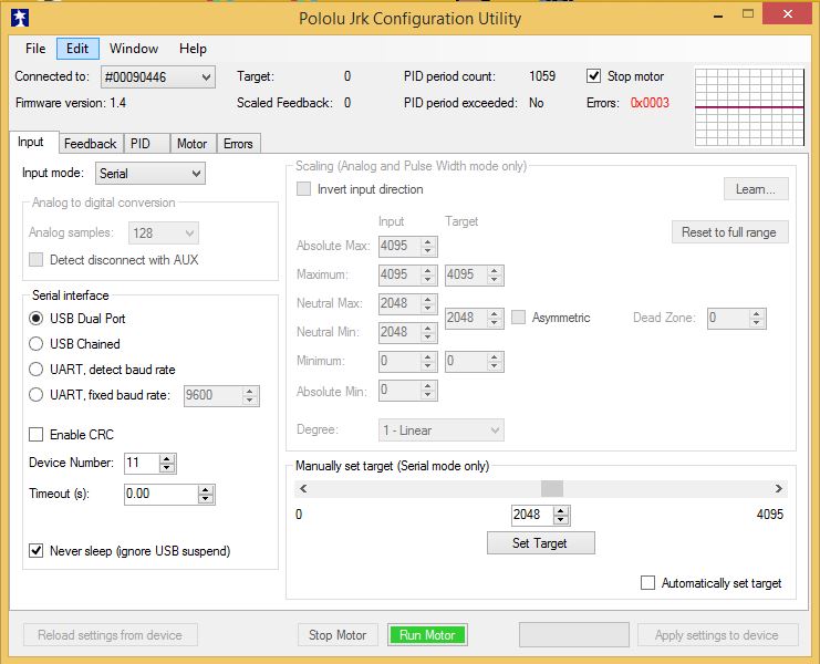

  2. bsft
    Can I see all screen shots of all the tabs in JRK utility please

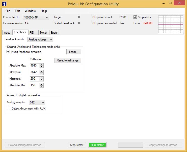

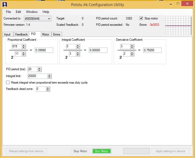

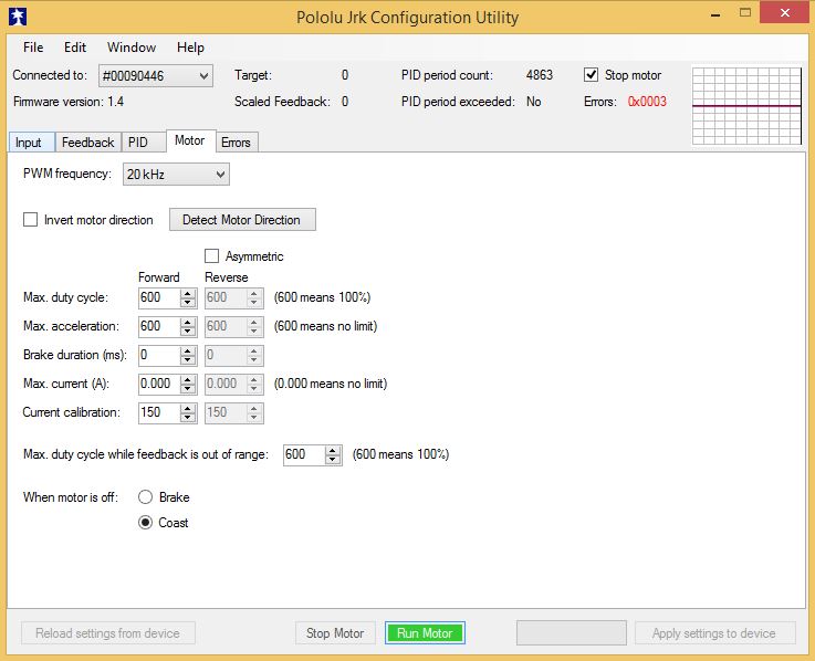

    Sure.
    This is the JRK/motor giving me the most grief. The other one is identical except for the Feedback values.
    INPUT

    MOTOR
    (Did not bother with Errors as SIM currently powered off, just USB connected.)
  4. bsft
    Bring max duty cycle and Max accell both down to 500.
    Turn current calibration down to 130
    Everything else sems ok

    When I set my JRK to 500 duty and accell, that actually made it worse, the JRK then became the bottle neck and the motor would stop as soon as the car was sat in the pits!!
    Set the JRK to 600 across the board and all good, but still motor would stop after a crash etc.

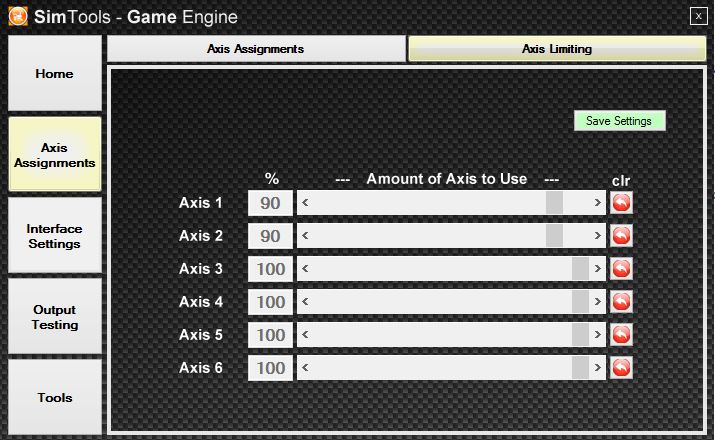

    In the end, I found what worked for me was dialling back the Master Output from 100% to 95%. (anything below 95% and sim feels too "wallowy")
    Then in the Game Engine, I limited the Axis to 90% for Axis 1 and Axis 2.
    Having Filters set or not, made no difference in my testing. I have removed them now though to account for the dial down to 95%.
    Tested in both AC and pCars and now no matter how hard I crash I can't get the sim to fail. Result!

    Screens so there is no confusion of terms:
    GAME ENGINE: (Per Axis Value)
    GAME MANAGER: (Master "Output" Value aka "Main Level")
