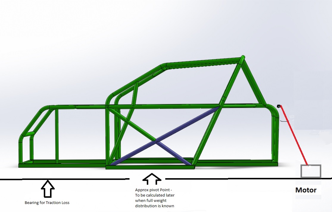

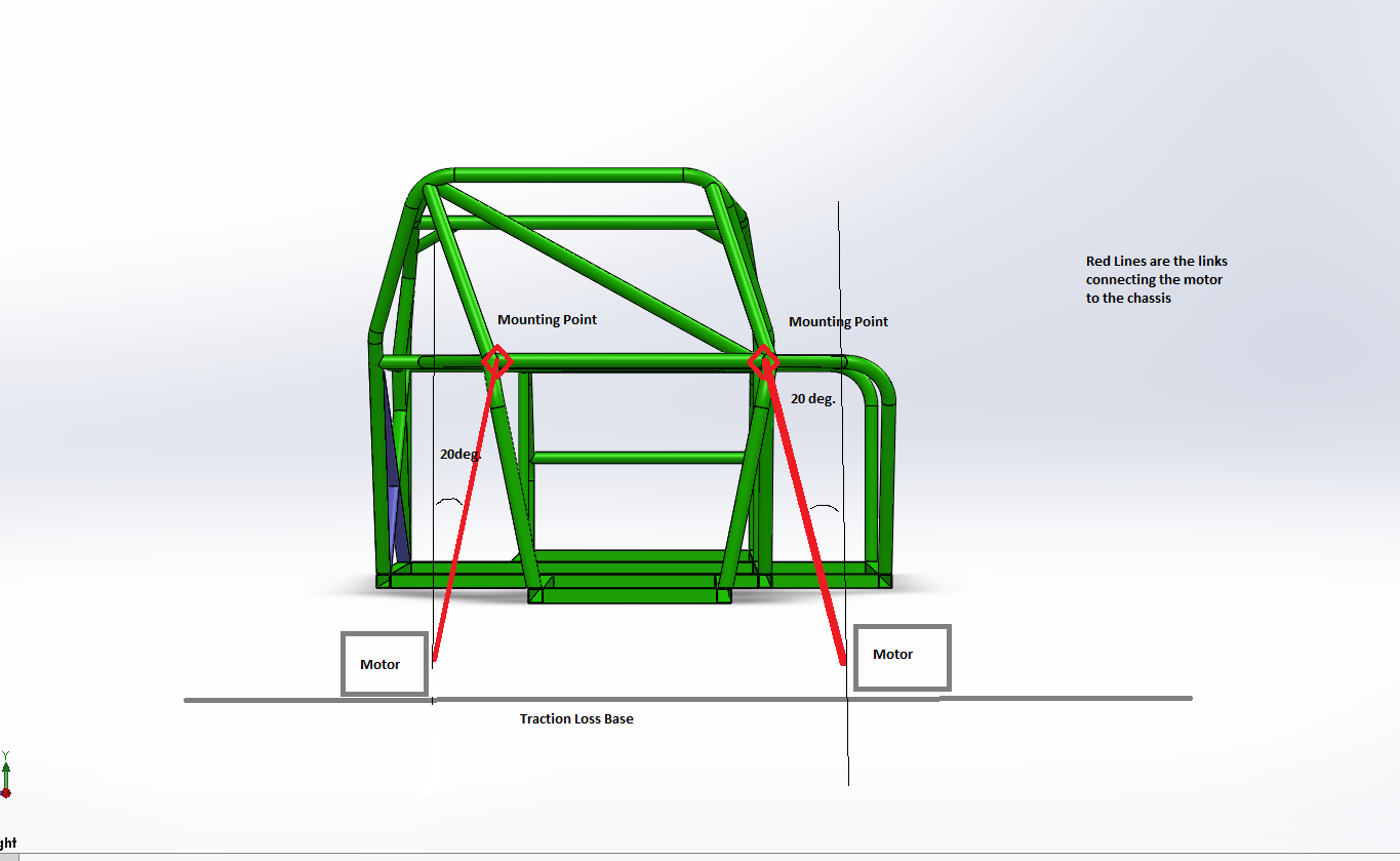

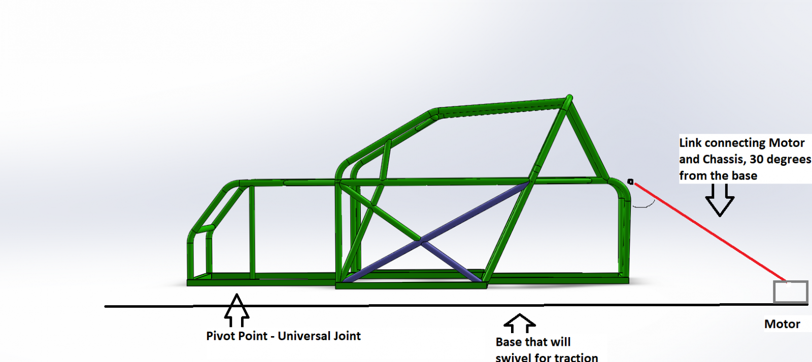

    Again, we are currently in the design phase of the simulator. We're just trying to get recommendations and opinions from people who have more experience with Simulators than we do. There is a good bit of information out there that we are going through, but not much on such a heavy rig. To get a rough idea of what our design with motion will be, we came up with these two quick sketches.
    We are placing the chassis on a swiveling base that will be used for traction loss. The chassis will be mounted at the front with a pivot point like a universal joint, possibly on a bearing to allow it to swivel. In the back, we will have two motors mounted to the swiveling base that will both attach to the chassis. The angle of the chassis to the link will be around 30 degrees.
    From the back of the chassis, this is what the setup will look like. The links will be at a 20 degree angle and mounted on the frame.
