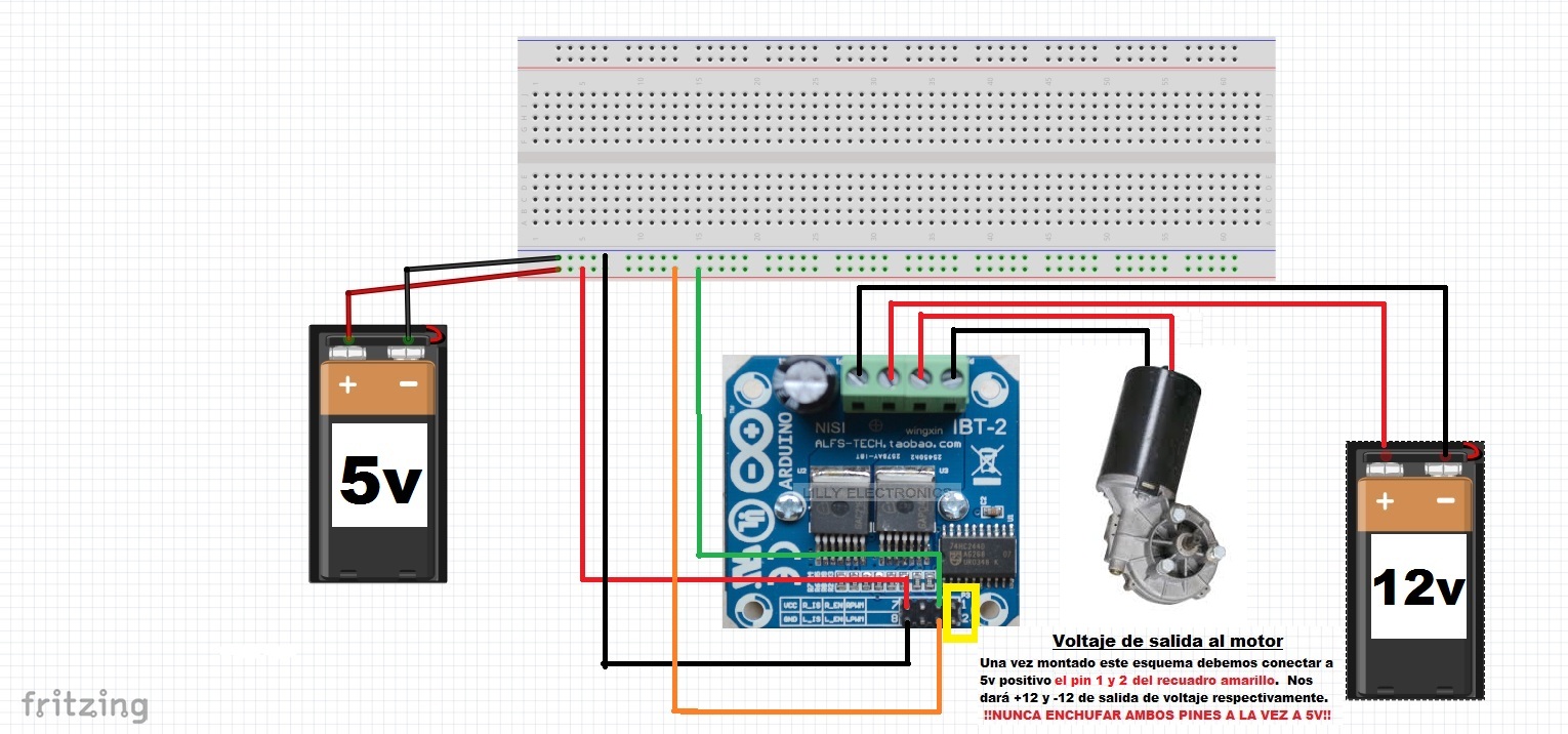

    Hello, sorry for not posting any progress.
    I'm with the 2Dof movement system but it does not work for me.
    I plugged everything in and did a test to see if it worked separately and lasted 1min.
    I need help from the community experience to see where the bug is and what solution there is.
    Used material:
    1- 24V 1000w Switched Power Supply: https://www.aliexpress.com/item/Uni...-Power-Supply-Transformer-110V-220V-AC-to-DC- For / 32729099271.html? Spm = a2g0s.9042311.0.0.nMBODL
    1- Arduino Uno
    2- H-Bridge BTS7960 43A
    1- Small reducer motor:
    https://en.aliexpress.com/item/Whol...12v-High-Torque-DIY-Robot-Rotating-Lock-Self/ 32358943700.html • spm = a2g0s.9042311.0.0.nMBODL
    1 - Reducing motor: 24V 150W Ratio 50: 1 60rpm.
    2- Potentiometers 10Kohm
    I worked very little 1 min and everything stopped, I bought two other Bridge-H BTS7960 43A and it has not come to work at all, only turn in one direction.
    I bought another H-bridge of more power http://www.ebay.es/itm/60A-High-Pow...er-Module/172015800469?ssPageName=STRK:MEBIDX % 3AIT & _trksid = p2060353.m2749.l2649.
    I can not make it work.
    I have connected the direct motors to the switched power supply and if I move the motor well.
    I do not know if the power supply has a protection for short circuit and is the one that protects when the polarity changes the H-Bridge.
    What is the problem? How can I test them directly?
    A greeting.

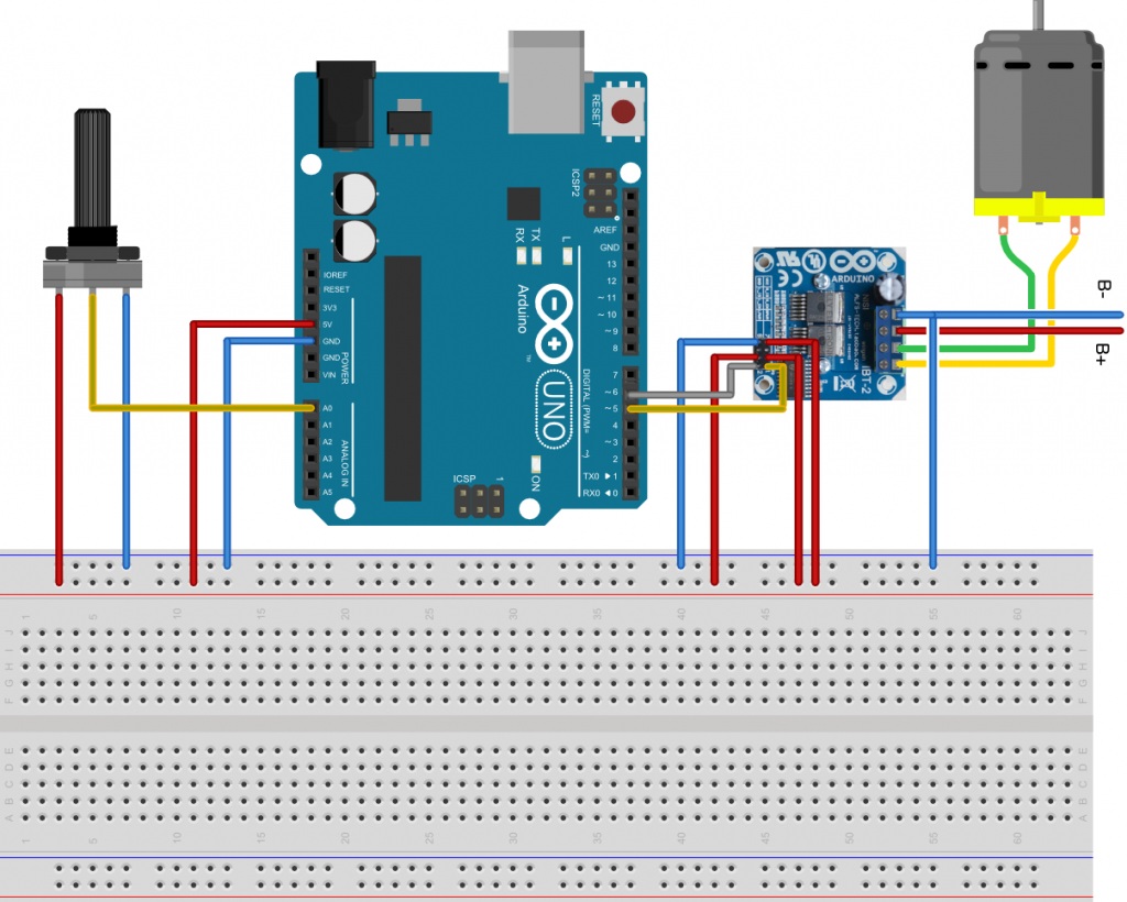

  6. Racing
    Racing New Member
    Jun 22, 2017
    27
    España
    305Coins
    The first test went straight to the power supply and it worked fine.
    The first two IBT-2s will last less than a minute.
    These second IBT-2 only rotate in one direction.
    The second test connected direct IBT-2 according to this scheme, guiraba everything in the same direction of rotation. According to reference page http://simulador-kaelh.blogspot.com.es/2014/08/un-simulador-tu-alcance-kaelh.html
    The third test was according to the IBT-2 page: http://www.hessmer.org/blog/2013/12/28/ibt-2-h-bridge-with-arduino/
    Do you recommend me a better H-bridge or that works better?
    What is giving better results?
    A greeting.

    Download the SMC3 to your arduino
    Your h-bridge will work on Mode2
    Just follow the instructions
    Regards

    Hi, I've already got the H-bridge ibt-2 to move the gear motor with the help of this community.
    I have configured simtools to receive the movements and parameters of the game in "Virtual Axis" in "Output Testing". I need the arduino code to communicate the h-bridge with the simtools and in turn with the simulator.
    In this post https://www.xsimulator.net/communit...-and-2-pins-direction-hbridge-motomonster.67/ is the code for another h-bridge, but not for mine, the ibt-2.
    The motor which is connected to the h-bridge, is thus connected to the potentiometer:
    Thank you very much for the help.
