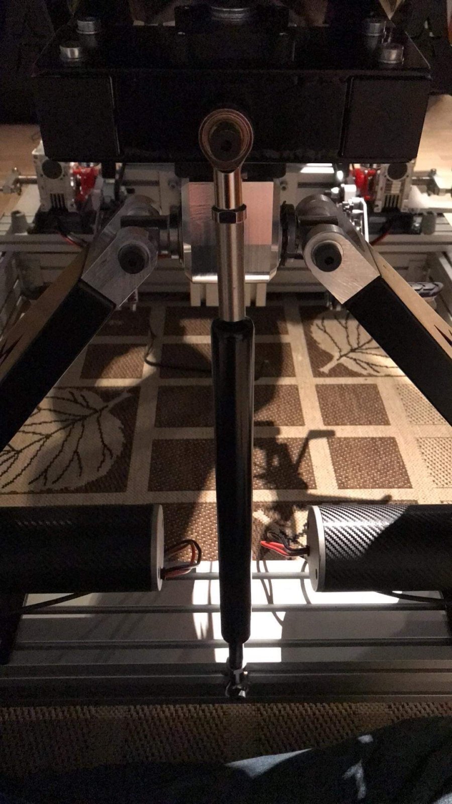

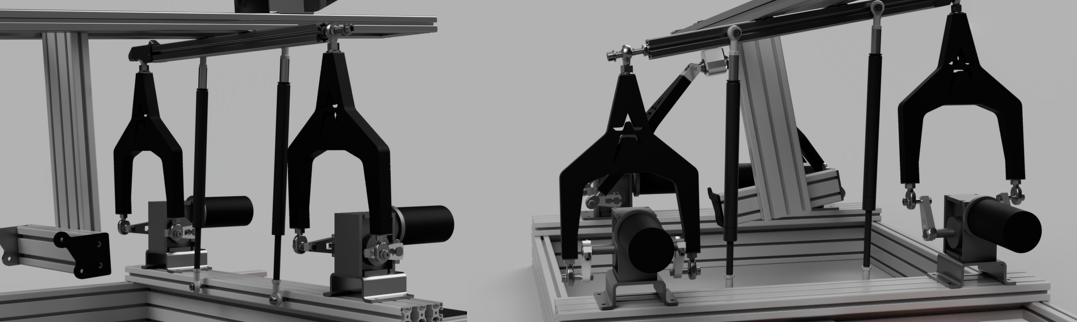

    Fixing the front meant that the struggle in the rear became more noticeable. So I bought another strut!
    The struts are called LMS2815230 and are pretty much springs in a tube.
    Mine are something like 420N per spring fully compressed.

    I ordered them from fjadrar.se , a danish company.

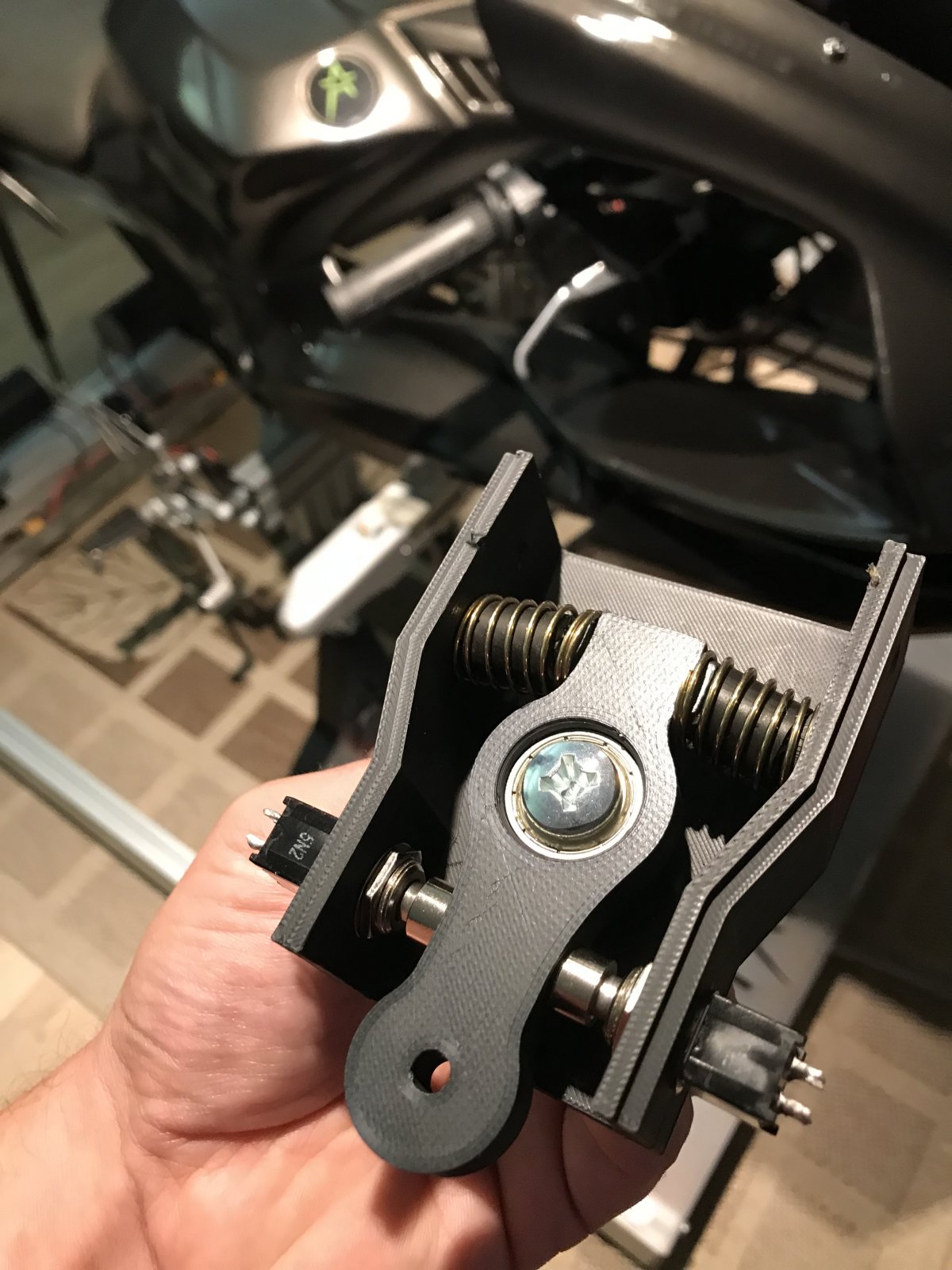

    Had a friend over the other day to try out the rig. His reaction to the full VR experience was great!
    However the current gear shifting mechanism, which is a carryover from one of my earliest projects that has survived unexpectedly long failed in turn one. So I finally took the time to test one of my ideas. The linkage still needs to be sorted.

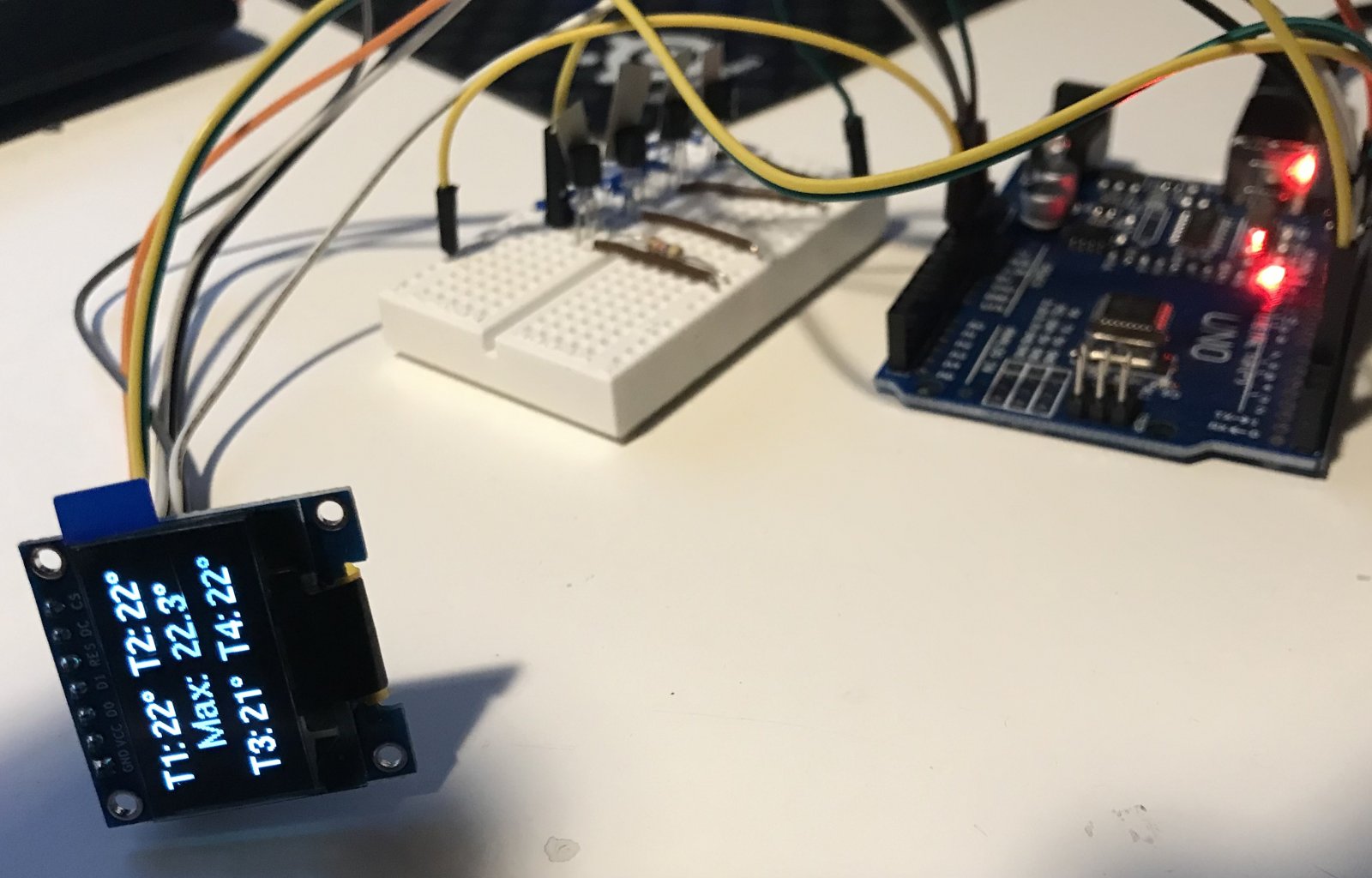

    I also took the time to write make a lite motor temp monitor system. The problem has been pretty much solved with the springs, but I thought it would be nice.
    It shows the current temperatures and the measured maximum.

    does the temp recorder use themisters ?

    It has DS18B20 sensors.

    The gear switch thing worked great! The wiring side could have been a bit more tidy though, and the mounting was a pain. The coolest part was the print-as-one ball joint for the gear lever. Fun!

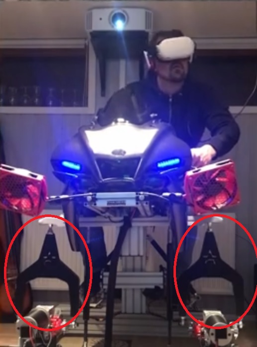

    Shot a short video of the rig in motion. Nothing fancy, but gives you an idea.
    The leaning, or lack of it and why leaning the right way is wrong, I'll try to explain in another video.. ;)
