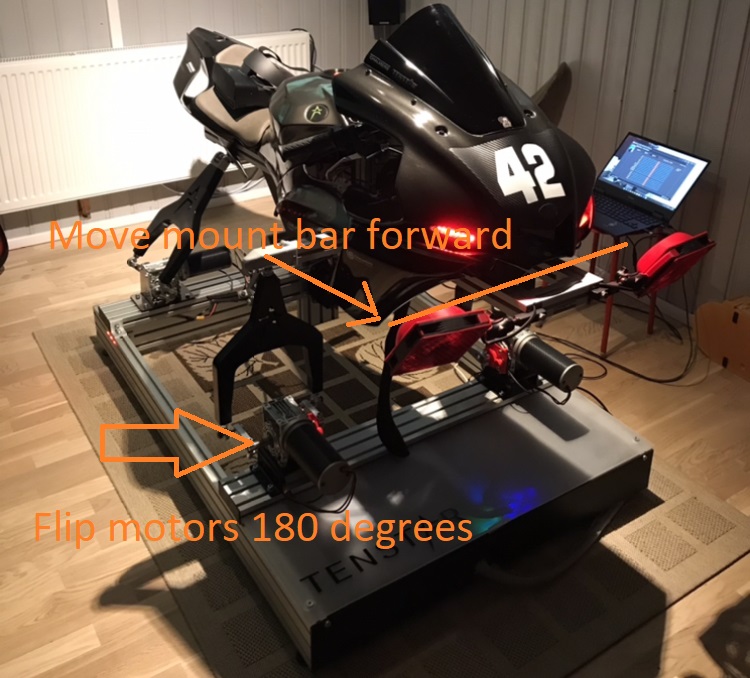

    what ratio are the gearboxes ?
    how many amps / watts are the motors ?

    1:60, 440W@24V
    Two 40A PSU’s, one front one rear,
    It does lift me in the end but very slowly.

    Perhaps you can try turning the front motors around 180 degrees and move the upper connection bar forward, to increase the inherent design leverage:

    When the front motors work together, like pitch or heave it works perfect.
    When the rider leans left the rig leans right to simulate g-forces somewhat. The leaning is done by the front motors only, since the rear motor connections are free to rotate in that axis. This means one motor will bear all the lean load by itself, and moving it forward will reduce pitch and not affect the roll at all. The front motors would have to be moved further apart, but I don’t want to reduce range. I’d rather put a spring to unload and keep range.
    22,185
    154,750Coins
    +11,196 / 57 / -2
    When leaning both motors are still involved, but the load is unequal .
    While moving the motors around and relocating the mount point forward will reduce pitch a little, it may not be as much as you may think, you could use SimCalc to work out exactly how much: https://www.xsimulator.net/communit...e-linear-speed-and-forces-of-your-design.270/
    Spring assist can help in one respect, counteracting a given load, it can also work against the motion fidelity of a rig. I use an adjustable spring on my rig for heave, made from an inverted DX office chair tilt mechanism, the benefit is that it can be dialed in to suit a specific mass, which may be radically different for different users.

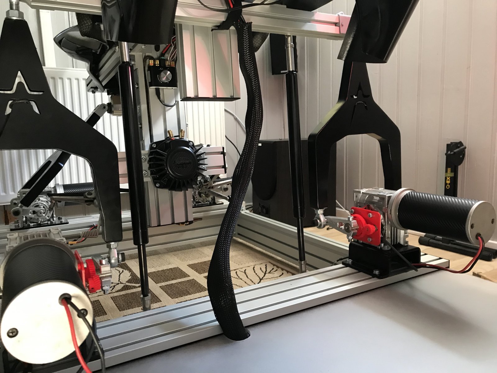

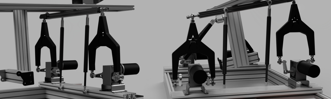

    So after designing a few solutions and scrapping them for lack of suiting springs, I just took the plunge and ordered two "M-struts". Something like a gas spring without the damping and an actual spring inside. So nothing like a gas spring.. ;)
    If two is too much, I'll just put a single one in the center. This will be interesting!

    That was quick shipping!
    I’ll try to get some testing done this evening!!

    The added reality of physics really did the trick!
    Now I can finally start tweaking without worrying about burning stuff up! :D
