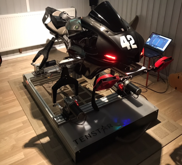

    The rig has now landed where it belongs, my basement!
    And it is mechanically finished. Still lots to do with the motion profile and controller but great to have it as a test bench.

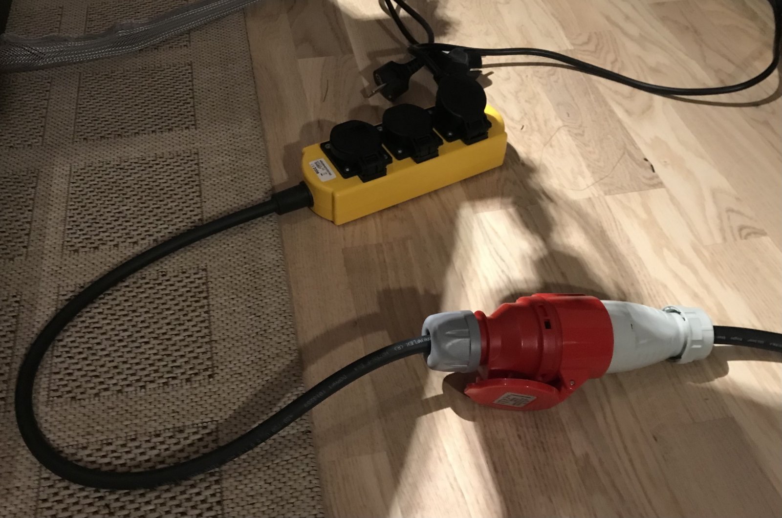

    Had some time to get it setup yesterday, so it's getting closer!
    Turns out I don't have enough juice in the outlets in my mancave... 1x10A is less than 2x12A apparently..
  13. Chris_Beeves
    May 31, 2019
    332
    1,910Coins
    +232 / 3 / -0
    Had a three phase outlet installed so I’ll have a 16 amp 230V fuse for each motor pair. That should do it! Hoping to get some time to play around with it Monday.

    Had a little breakthrough yesterday with the motion profile. Finally got the surge/sway/heave working in the plugin and that really opened up possibilities!
  17. Chris_Beeves
    May 31, 2019
    332
    1,910Coins
    +232 / 3 / -0
    After some time testing it turns out the front motors are struggling with the roll motion.
    A slight miscalculation on my part, so I’m looking at ways to unload the front. Right now I’m looking at some kind of spring just holding it up in the middle. Lots of movement going on there though so the design is not really clear right now..
  18. Gadget999
    1,897
    11,610Coins
    +458 / 9 / -0
    can the joints pivot correctly ? are the motors jamming with the movement ?
    can you measure the current with a clamp meter ?
    try shorter lever arms to see if it helps
  19. Chris_Beeves
    May 31, 2019
    332
    1,910Coins
    +232 / 3 / -0
    Everything moves just fine. The problem is I’m just putting too much weight on a single motor. I don’t want to reduce the range, it’s already on the low side.
    So either I lose 40kg or so real fast or get some springs ;)
