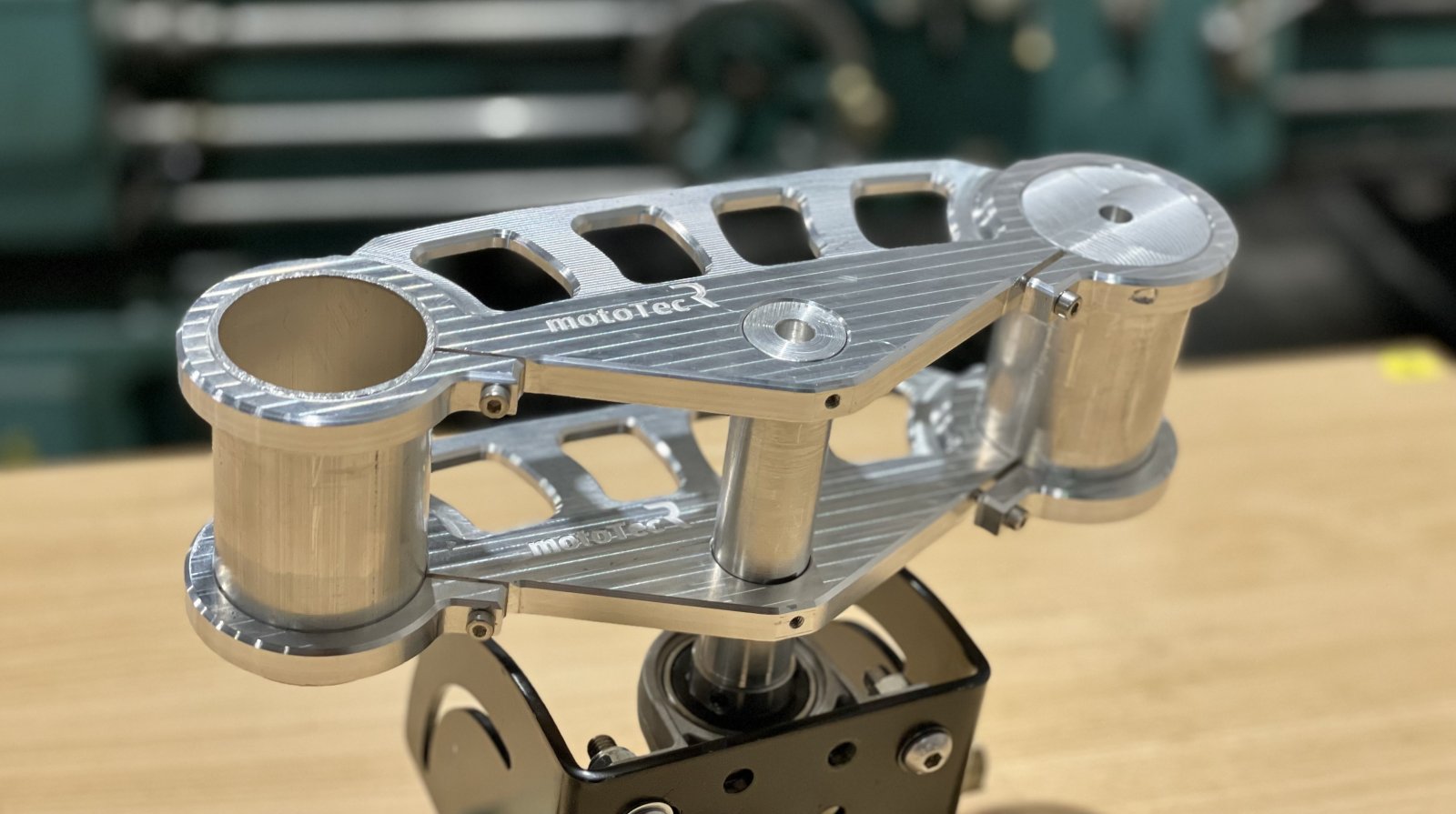

    Yesterday I picked up the aluminum clamps from the workshop. Feels really cool seeing the design come to life!
    Looking forward to mounting and testing, but first, vacation!

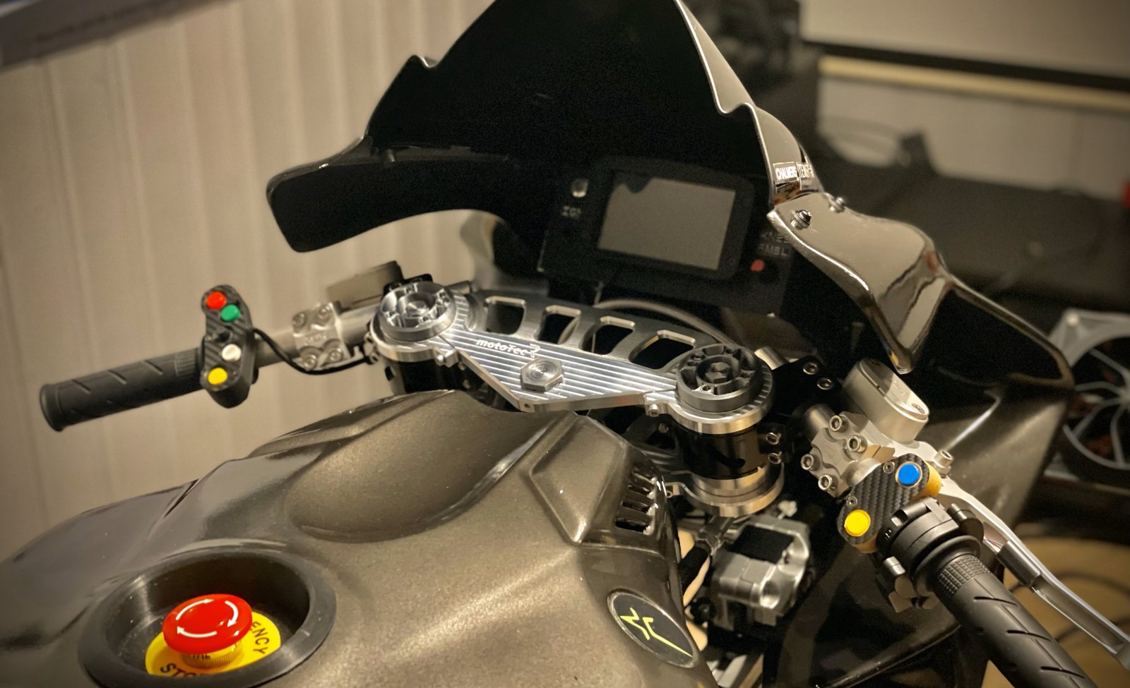

    Mounted the new clamps to the rig. Great fit!
    Haven't really done the full force test yet, but they feel solid enough. The rubber mount for the steering actuator is working itself a little loose though so I have to do something about that. Maybe just solid mount, the motor doesn't seem to be making as much noise as I expected.

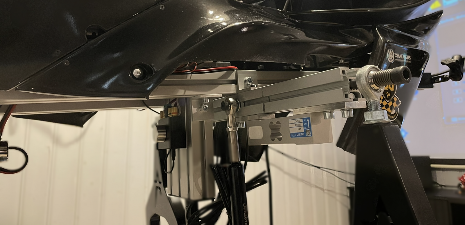

    Finally got my ass out of the wagon (is that even an expression?) and mounted the load cells to the upper platform. This will allow me to use the riders physical movements as steering input in a better way.
    Hopefully it will make it easier and more intuitive to use for more people.
    Well, I do need to connect them and write the code still, but at least steps were taken!

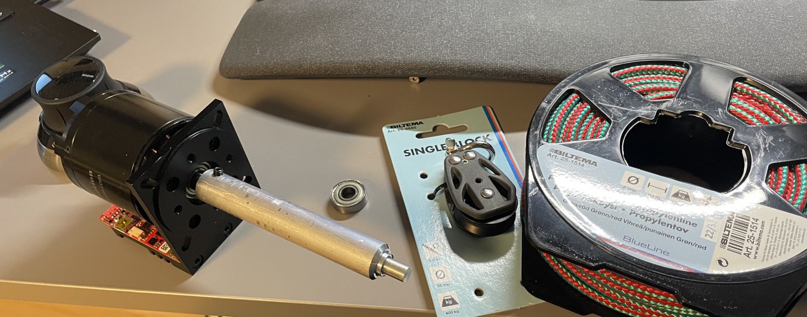

    Now the weight shift sensors are in place and code has the functionality somewhat where I want it.
    Yesterday I realized I’m starting to feel “finished” with this sim. Just one more technical solution going on there, then I don’t have more plans. Feels strange. I have learned heaps that I hopefully will bring with me in the next version platform not too far in the future.
    These are parts of the last function. Can you guess?
