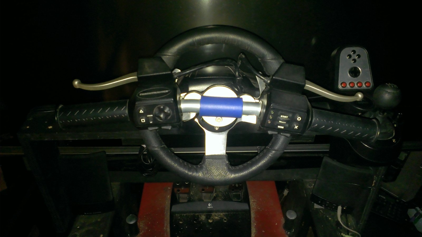

    I vote good idea. :thumbs But not like in the posted video from value1. I would vote complete fail on that design except for the motorcycle itself.
    One big problem I have found though is finding a motorcycle controller that you don't have to make yourself. Thrustmaster made a motorcycle controller years ago but I can't find anyone manufacturing motorcycle controllers for the masses anymore. Here is a video of it. The presenter claims it is of good quality but in actually it is a piece of junk! Especially in the roll axis.
    The roll axis are so loosey goosey it is worthless. However, the throttle and brake on the handlebar, while bad quality, are usable. So if you can manage to get a hold of one, it can be modified into a force feedback GP bike controller. I removed the handlebar portion of the controller and modified it so it could be bolted on to my G27 racing wheel. I had to drill a couple of extra holes in my G27 to line up with the handlebar mounts. It works great. You just have to set up both controllers for your game. The idea is that on a GP type bike, you will turn more by leaning your weight, then by turning the handlebar right or left. Here is what it looks like.
    If you noticed at the bottom of the picture, I also put two fold out foot rest for more realism but I forgot to put them down for the picture. Also, if you want to use your G27 with a handlebar for motorcycles, you need to set the wheel to 70 degrees rotation or there about.
    And while I haven't incorporated it myself, it would be even more realistic by using a motorcycle seat where a sensor(s) is used to obtain the position of the rider on the seat. Right now I must use automatic front to rear weight shifting.
    ps After looking at the picture, it looks like its time for a spring cleaning!
