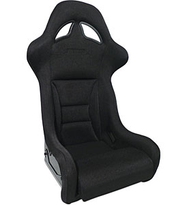

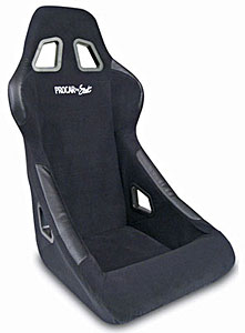

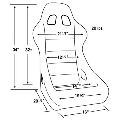

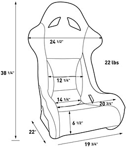

    I want to use either Procar Pro Sport series 1790 seat ( $140 shipped )or the Procar Drifter seat ($180 shipped )since it's a decent budget fixed back seat.

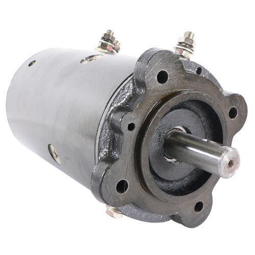

    The motors I am looking at right now.

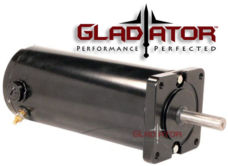

    Ramsey 12v Winch Motor 2 Ball Bearings 6HP MBJ4409 MBJ4410 $87 Shipped
    Unit TypeAlternator
    Part TypeUNIT
    Voltage12
    Free running Speed2100 RPM
    RotationBI
    KW6.0 HP

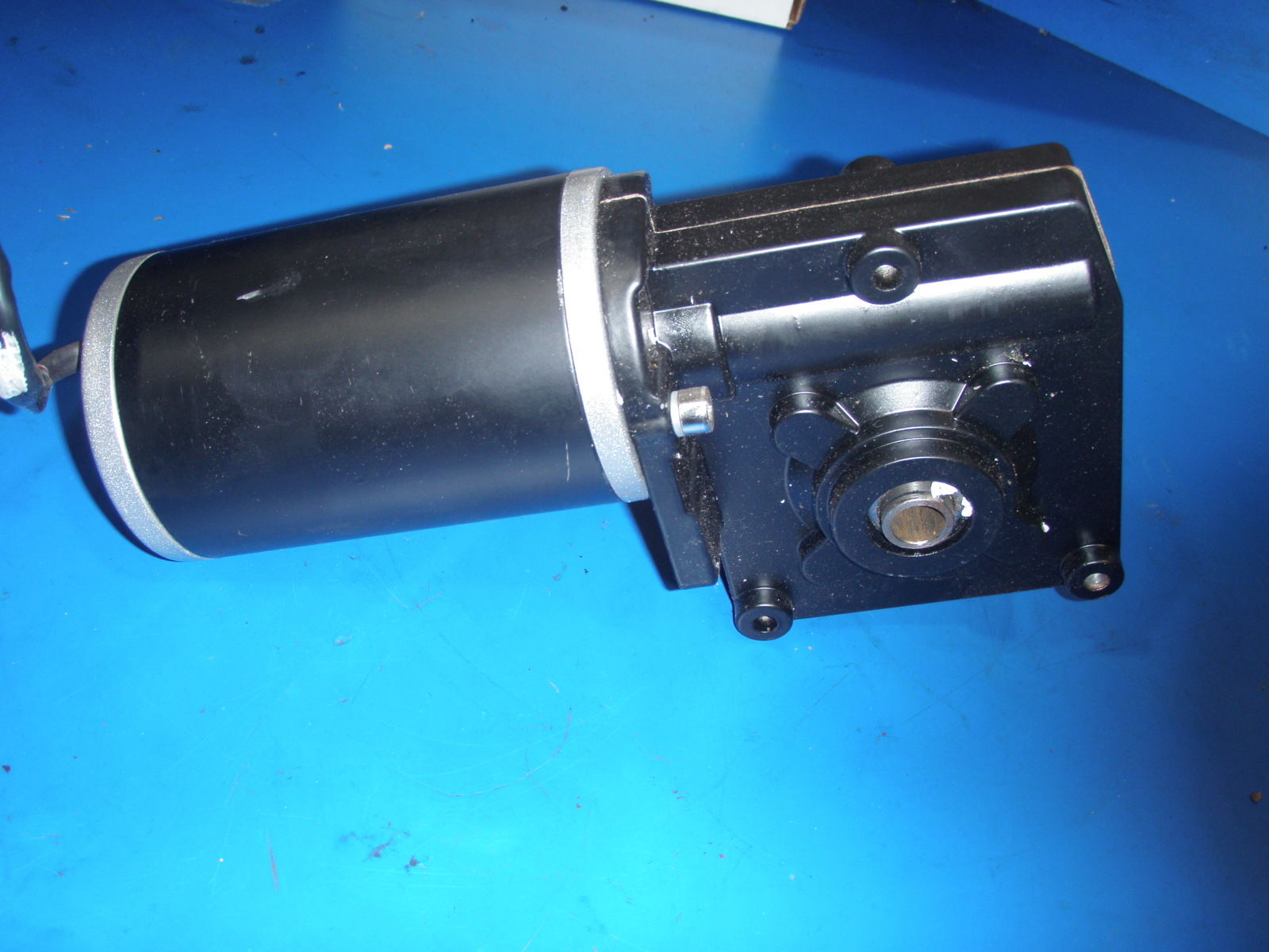

    12V Gear motor with worm gear $108 shipped
    180Watts
    25:1 Ratio
    150-160RPM
    Hole through the double sided shaft
    Load 30-40Nm

    From experience I can say that the 180W 25:1 motors would not suit a full frame compact design with a 100KG user and heavy peripherals, but are great for a shoulder, knee or foot mount designs where there is more leverage.

  6. Pit
    3,012
    30,480Coins
    +3,097 / 31 / -0
    Hi I am very busy and on the way so only a short comment: the Ramsey 12v Winch Motor 2 Ball Bearings 6HP are way tooooooooo strong, to drive this bitch of a monster you need 12 MotoMonsters........IMO :)

  9. Pit
    3,012
    30,480Coins
    +3,097 / 31 / -0
    one you should know already my 750 W winches (~1 HP) at full load they would draw 120A continuous current. Second not only the needed current could be a problem, think about the PSUs or batteries you will need to power them.
    At least the heat will be a very big problem (winches under full load will be very hot like other big motors) and at ultimata your wall socket is limited by 10A (220V), I am running 3 winches, one gear motor, PC and other stuff and I am already at 6 A (continuous!), 9A peak.
    If you will plan to build a 3DOF IMO you have to implement a spring to reduce vertical weight. Please inform yourself about approved 3DOF concepts, and before that please read why a seat mover (and only the seat will be moved) is very immersive and tricks the brain in a very impressive way. You have to decide what you would like to do more: racing or simmering. If both, a 3DOF would be mandatory, if racing is not so "important".

  11. Pit
    3,012
    30,480Coins
    +3,097 / 31 / -0
    My winches do not make any troubles, IMO they are strong enough to lift 100 KG, and I am speaking about only one motor which lifts the weight. I would like to underline that 1PS meets all requirements and is easy to manage.

  18. noorbeast
    21,592
    151,215Coins
    No, most 3DOF platforms are AC.

    358Coins
    Winch motors can produce amazing torque - as long as you have HUNDREDS of amps to dump into them. I looked into them for another project but gave up due to this problem. 200 amp h-bridge is no small task.
