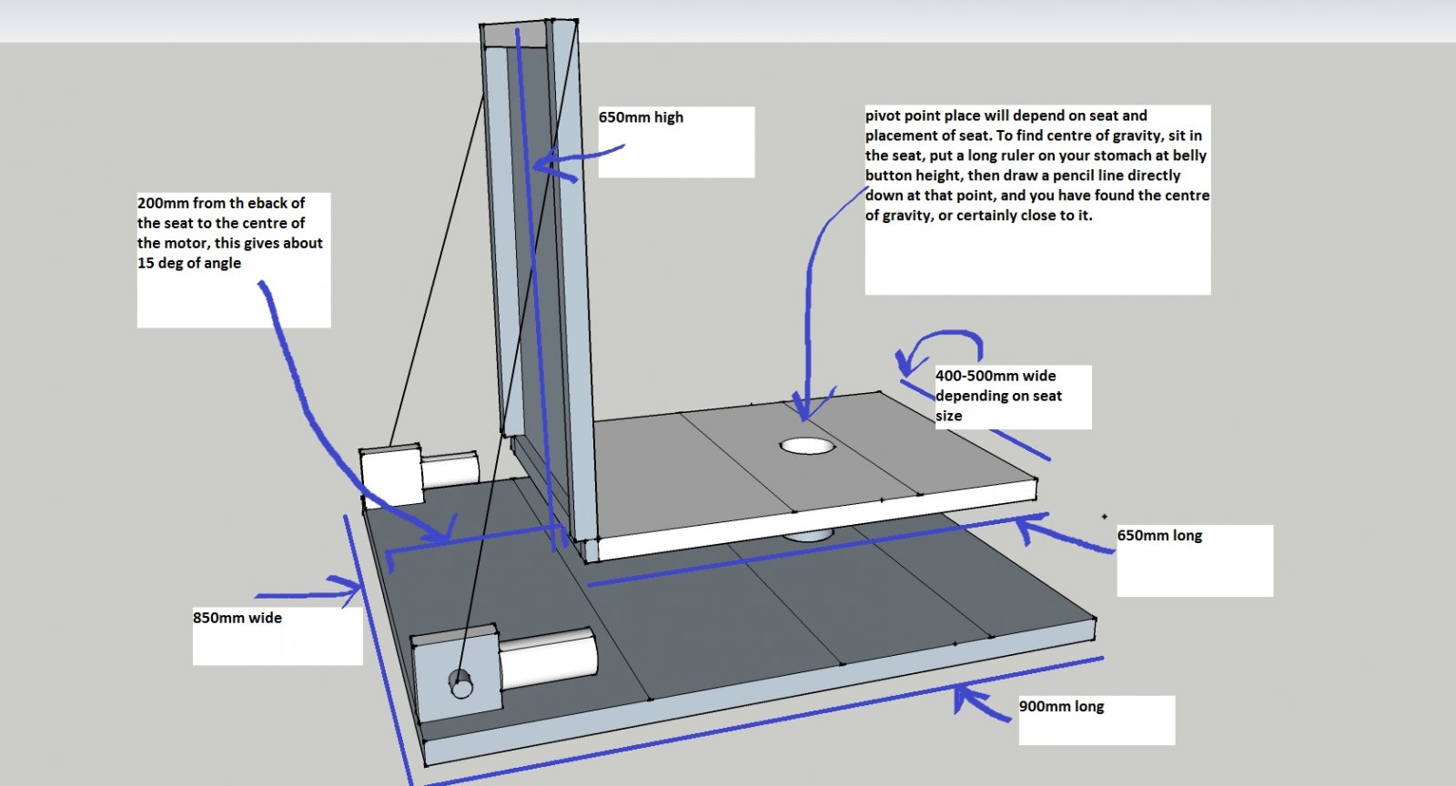

  5. bsft
    I dont have plans as such, but a basic sketch to start with for a shoulder mount seat mover
    With your weight Id suggest set motor rod arms back at 20 deg and 20 deg to the side. @Nick Moxley , but chance do you have a sketch to share?
    Just make a frame for the seat and add extra size for the bottom
    The motors and gearboxes will survive if properly put in place. @eaorobbie and @Nick Moxley has been thrashing the crap out of their motors and I used them on simulators for commercial use and since I sold the simulators, they are still going.
    Anything will fail if incorrectly used, as several people found out.
    The motors Nick linked you to will do the job just fine. Set them up right and thrash hard.
    Dave.
    EDIT, once a seat is found suitable, a frame design can be worked out from there. Its not complicated, just the right measurements.

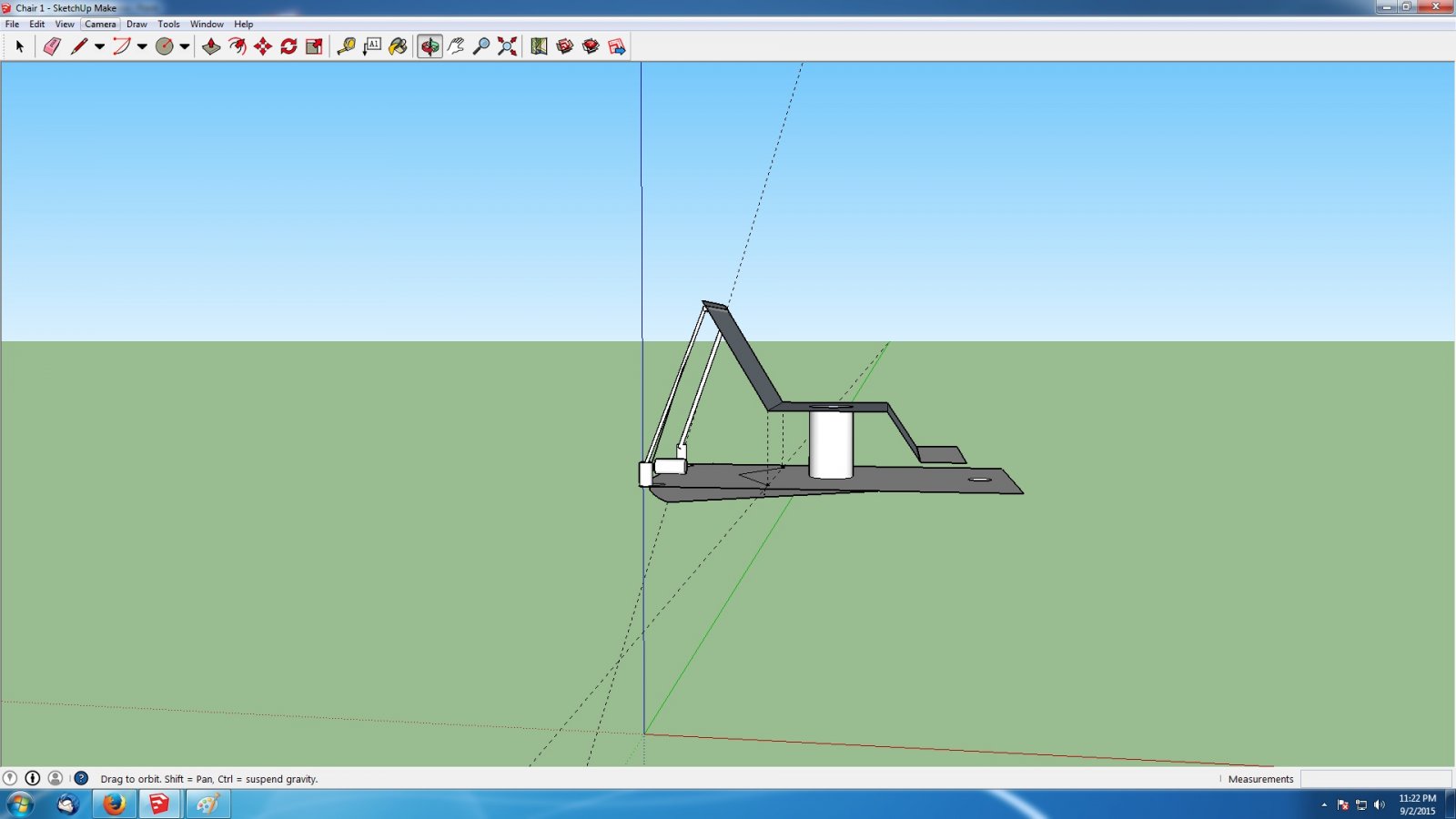

    I just finished a model in sketch how can I post it here to get some input on design. I would like all to see so I can make some changes and such

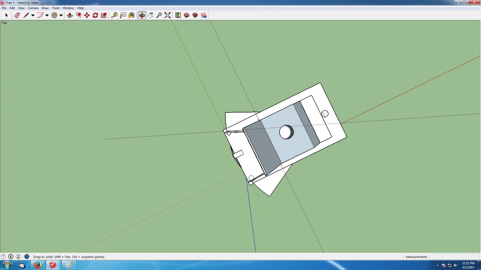

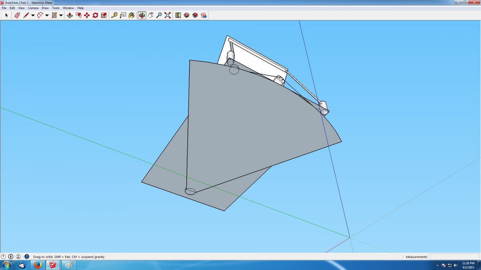

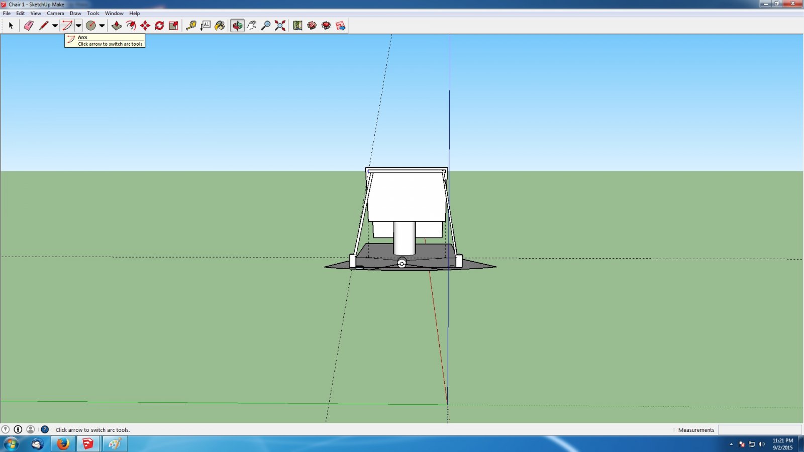

  11. Jason Currington
    Jason Currington Member
    Mar 1, 2015
    33
    537Coins
    Motion platform
    First attempt at using drafting program but here is the general idea of the chair
  12. noorbeast
    22,230
    154,849Coins
    +11,228 / 57 / -2
    That is a very useful start.
    Can I clarify what you have in mind to connect the motor to the bottom platform for traction loss, is it a cable, chain, rod or something else you have in mind?

  14. Jason Currington
    Mar 1, 2015
    33
    537Coins
    Motion platform
    Yes. I was thinking chain. Seems you can get more travel out off it than a linkage and level setup
  15. noorbeast
    22,230
    154,849Coins
    +11,228 / 57 / -2
    What travel are you planning, others have gone for 300mm total or less?

  18. noorbeast
    22,230
    154,849Coins
    +11,228 / 57 / -2
    Follow in the footsteps of what others have done: http://www.xsimulator.net/community/faq/traction-loss.174/
    It is a seat shaker design if the controls are separate and a full frame design if the controls move with the sim. Both designs have their advocates, see here for a current discussion on the topic: http://www.xsimulator.net/community/threads/what-the-ideal-motion-system-for-a-racing-sim.7298/
