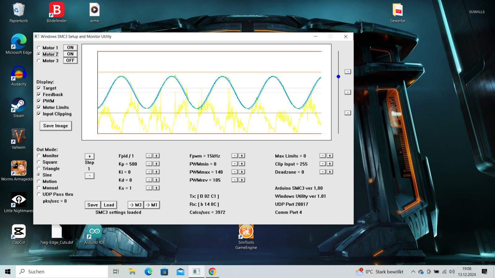

    Iver tried 300 and the Same result.I can drive for a while, sometimes longer, sometimes shorter, and at some point both engines will run continuously or they will both simply stop.
    It also has nothing to do with whether the engine is under load at the time, it can happen on a straight stretch or sometimes in the menu.
  6. Stahlwolle
    Stahlwolle Member
    Nov 28, 2024
    54
    268Coins
    +11 / 0 / -0
    Here is a short video, again on a straight road, before that everything was working fine. It is also strange that both motors show the same behavior. There must be something wrong with the transmission to the Arduino.

    Try raising the Max Limits:
    Max Limits Used to create a band at either limit of the feedback range beyond which if the motors move (typically through inertia) the SMC3 will automatically shutdown the drivers and keep them disabled until reset. This is essentially a safety mechanism if something goes wrong. The value can be between 0-255 (however can’t be greater than the current clip setting).
    And Fpwm at 25.

    22,202
    154,675Coins
    +11,209 / 57 / -2
    Max Limits is set to 0 in the picture you posted:
    My suggestions are aimed at systematically establishing what I would normally expect as base SMC3 setting, before then considering SimTools settings. So can you please confirm what your Max Limits settings are.
    Then please post pictures of all your SimTools settings.

    I began with the Standards, ki,KD,KS :0
    Pwm min 0, pwm Max 0, Max Limits and clip Input 255. When i raise the Max Limits, the engines will fail even sooner.

    As already mentioned:
    Hence it sounds like the hardware may not have adequate control and exceeds that Max Limits safety setting.
    Try lowering your Clip Limits.
    And also consider that the most effective torque utilisation is at 90 degrees and that degrades in a nonlinear manner, rapidly so after around 38-40 degrees up and down. So try and limit lever range to a max of 40 degrees up and 40 degrees down.
    What I mean is τ = r F sin(θ): https://www.omnicalculator.com/physics/torque

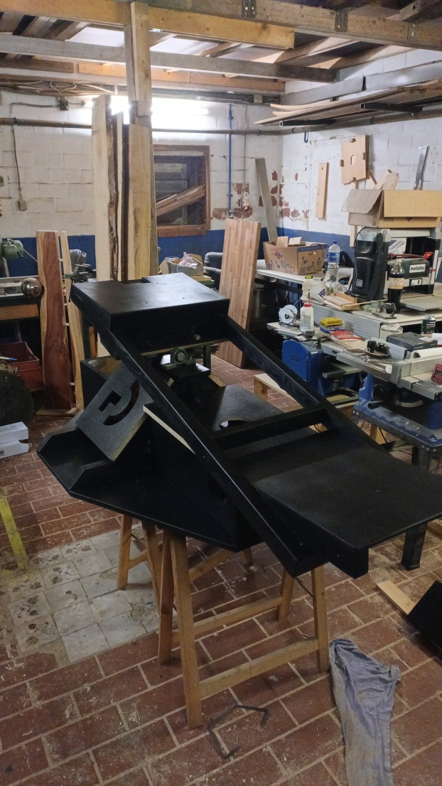

    I have now disguised the simulator a little and forgot to mirror the logo when milling I am expanding it directly with a drift axle...

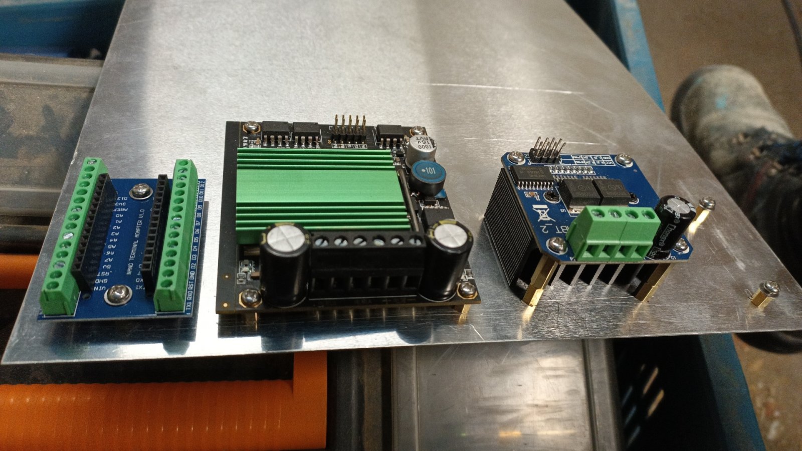

    Do you think it is better to use two IBT2 for the front motors and the 100A controller for the drift axle or the 100A for the front and IBT2 for drift? I would have to control two Arduinos in both cases, since IBT2 runs in Mode2 and the other controller in Mode1, right?

  17. Attyla.pl

    The 100A for the front and IBT2 for drift is better :)

    Did you connect just one power supply to the 100A controller or two?
  19. Attyla.pl
    Attyla.pl Active Member
    Oct 1, 2023
    308
    Polska
    1,348Coins
    +93 / 2 / -0
    I connected two 24V 25A power supplies in parallel to 100A bridge, it works without any problem
