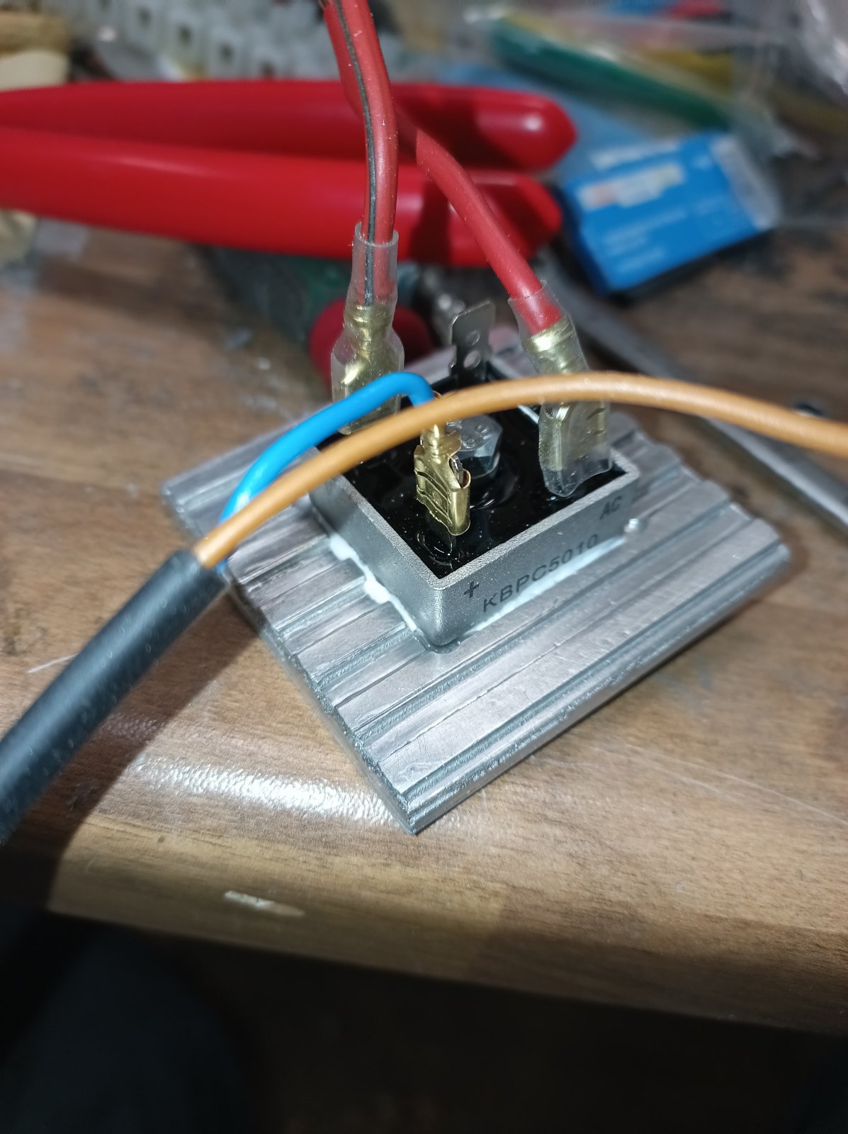

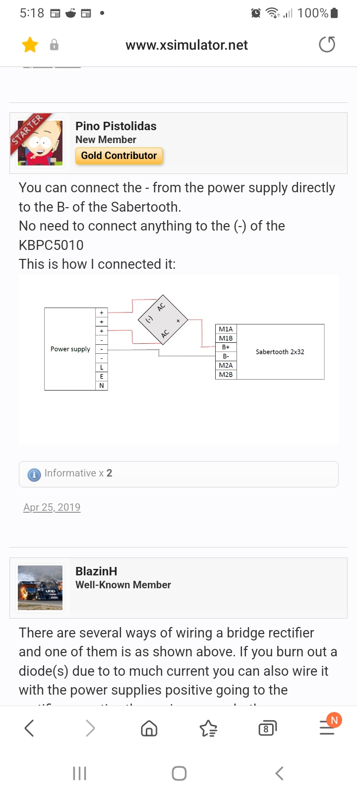

    Of course, the heatsink should be tightened to the diode.

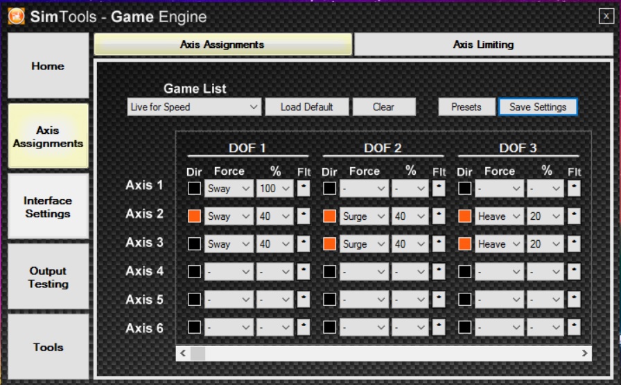

    But how do i select a Game and setup configurations then?
  9. Stahlwolle
    Stahlwolle Member
    Nov 28, 2024
    54
    268Coins
    +11 / 0 / -0
    I cant show up a screen Like this, it only shows up as a preview when i press alt+Tab, and wont open if i click on the preview screen, it stays in Background.

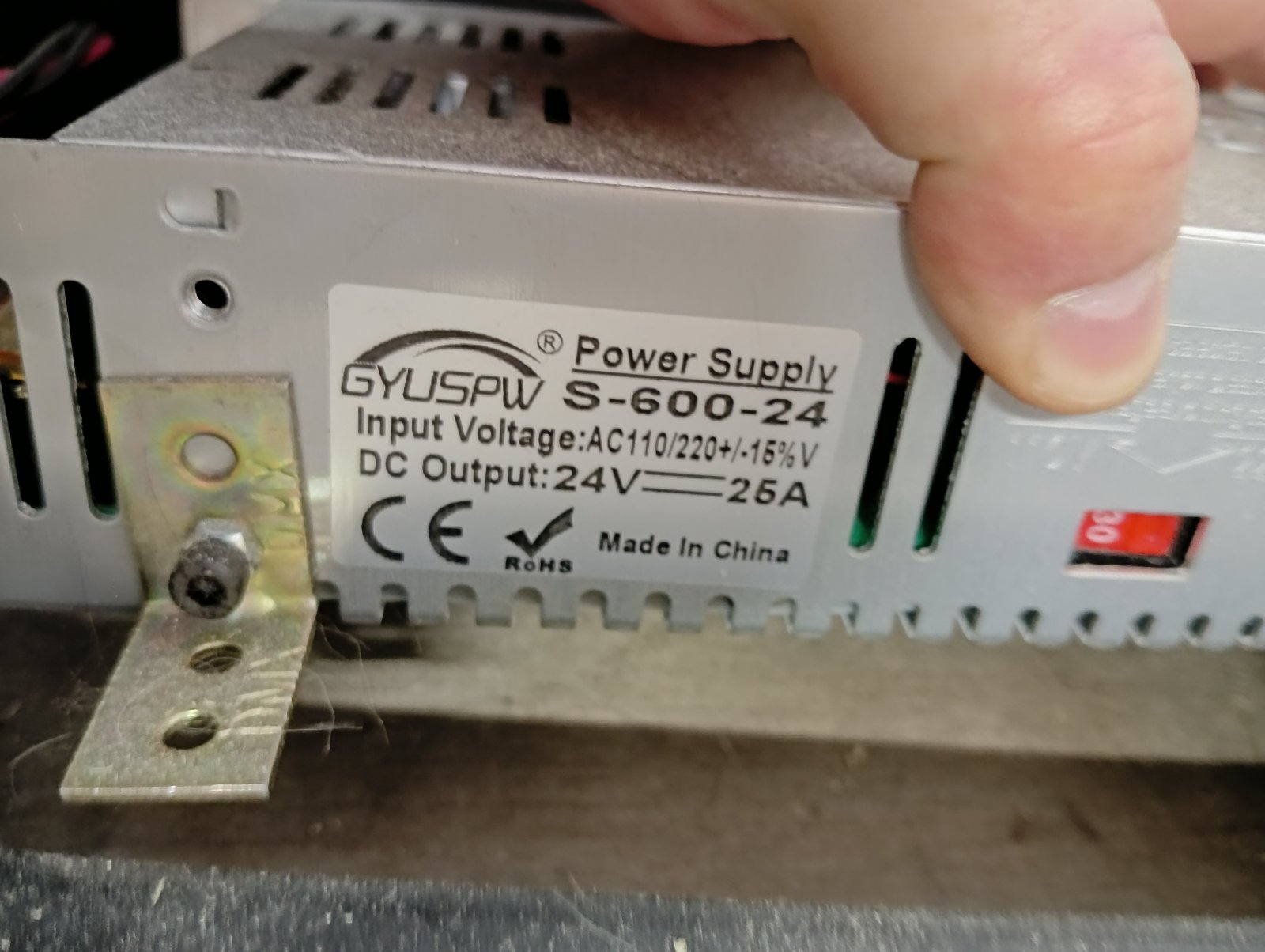

    I got the two new power supplies today, 600W this time...
    The bridge rectifiers are also there, I milled a couple of heat sinks, I hope everything works now.

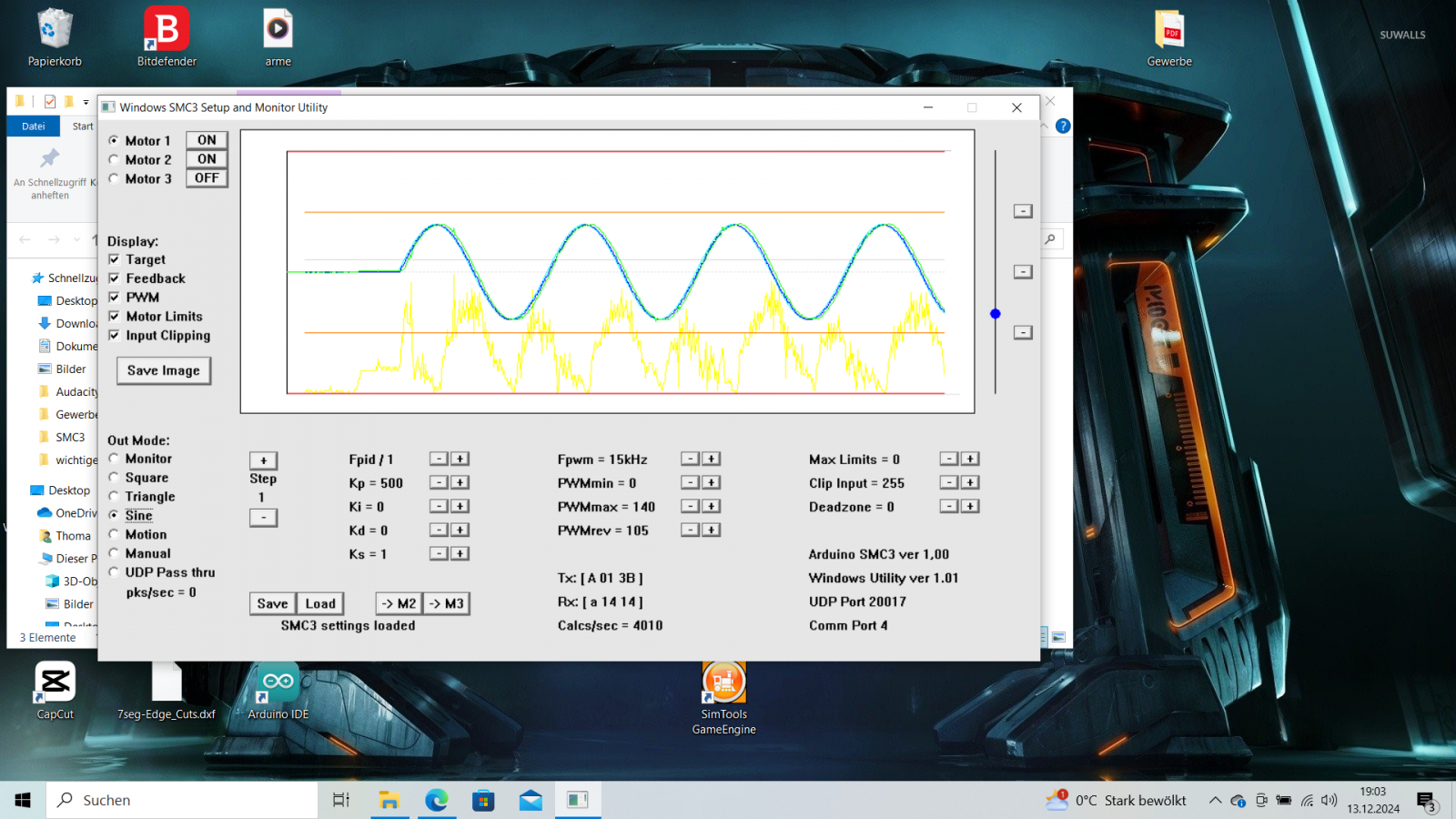

    I have now tested again with sine and motion in smc3. The left motor constantly stops when turning downwards, and then the motor is switched off by the program.
    This happens when the other motor leg turns upwards. As if the motors are only designed to rotate in one direction.

    1,348Coins
    +93 / 2 / -0
    I understand there is a left engine in the video ?
    The movement looks correct, you write that the motor is switched off by the program, do you mean SMC3Utils? and the fact that with the motor number the button changes from ‘ON’ to ‘OFF’?
    If it changes to ‘OFF’ it means that the range of the signal read from the potentiometer/hall sensor has gone beyond the safe limit, show the video from SMC3Utils.

    It looks to be exceeding its limits as a result of inadequate power, which could relate to settings, hardware chosen, and/or design factors.
    Please post pictures of all of your settings, including running the Sine test.
    Keep in mind a lever's most effective torque utilisation is at 90 degrees. and that degrades in a nonlinear manner, rapidly so after around 38-40 degrees up and down. What I mean is τ = r F sin(θ): https://www.omnicalculator.com/physics/torque

    I think I made it through the settings yesterday, the motors now have more power in both directions... I'll post my settings later though. Thank you!
