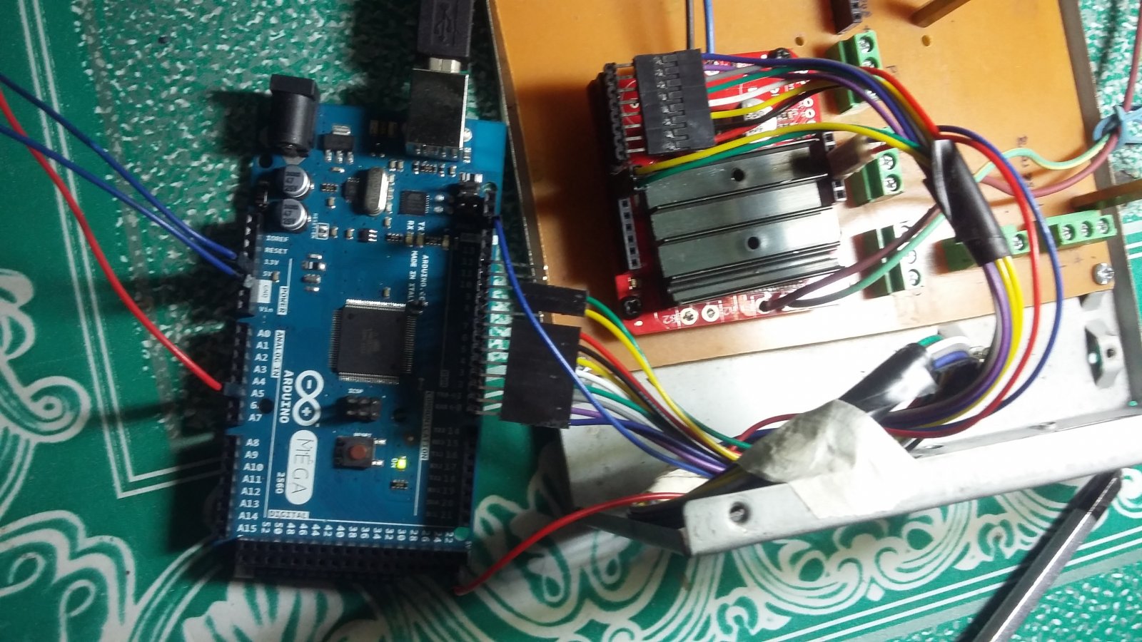

    Hi! I'm currently facing a problem where when the motor is connected with the monster moto, the motor can be stopped by a hand but when I directly connect a power supply to the motor, I cant stop it. I think monster moto reduces the power of the motor. What do you think?
    Here is my hardware:
    -12V 30A PSU
    -wiper motor
    -Monster Moto
    -Arduino Mega

  9. RacingMat
    2,234
    20,895Coins
    +2,084 / 21 / -2
    hi!
    there is something weird here :confused:
    motomonster should not "reduce" the motor power
    can you give us more details about your setup?
    - I guess you didn't connect the potentiometer yet... it's fine for the first tests
    - did you try with only 1 motor running?
    - did you change anything in the code?
    - my guess would be a wrong wiring... can you share some pictures?

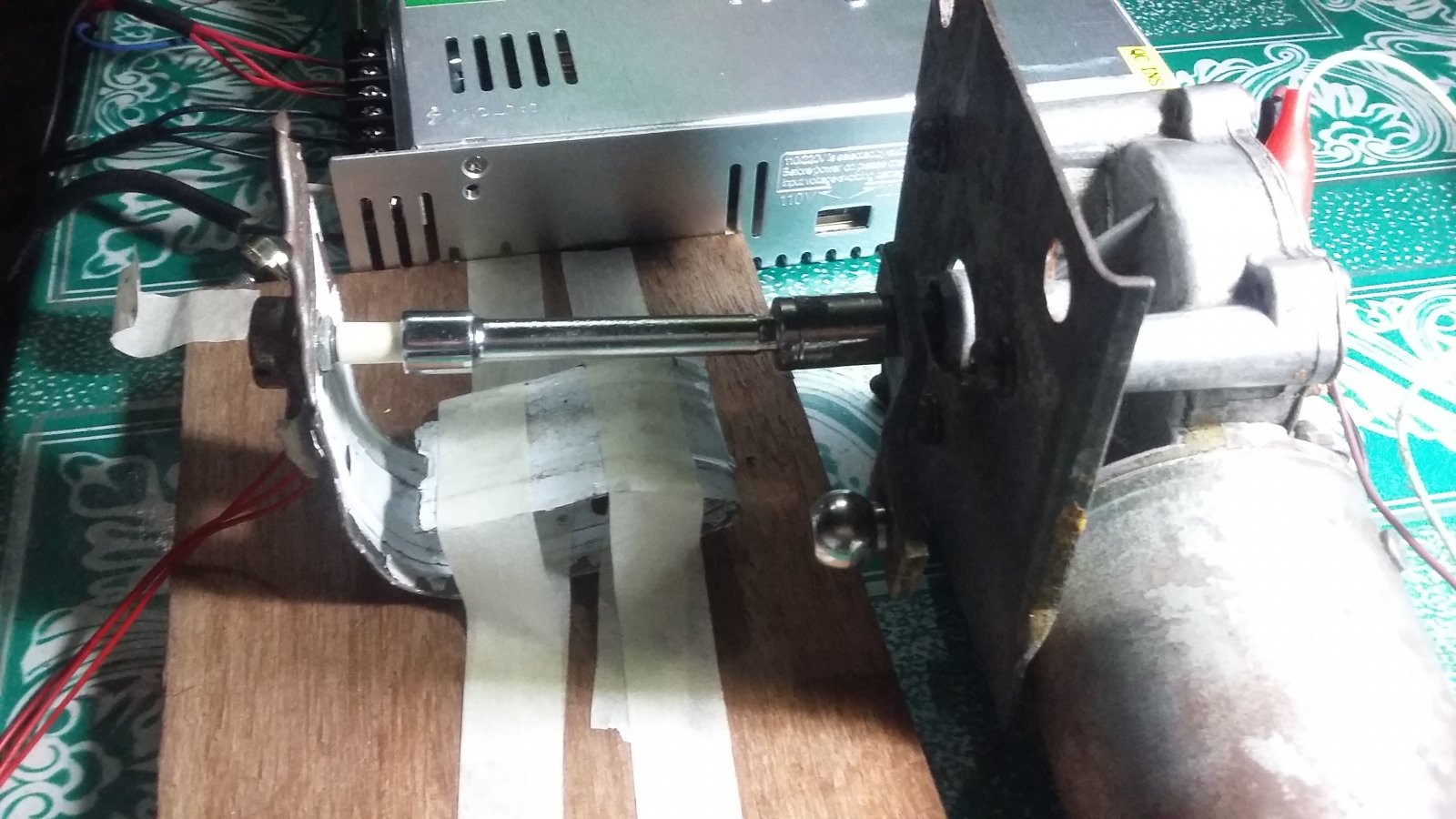

  15. Ralph Manuel
    Ralph Manuel Member
    Aug 8, 2014
    50
    600Coins
    +17 / 0 / -0
    Hi! Here are some pictures and videos. Kindly check it out.
    As you can see, every time I stopped the motor, the PSU fan is noisy because the PSU has a built-in control circuit according to working to temperature. So, stopping the motor adds some load to the PSU.
    I don't have materials needed that's why there are tapes, plywoods and recycled materials. LOL
  16. Scratch
    Scratch Active Member
    Apr 23, 2014
    170
    281Coins
    +181 / 1 / -0
    Very strange. I cannot help much, but I have identical psu and I'm using it for both motors through Monster Moto. It starts it's cooling fan rarely and for a short period of time when rig is in use. So it seems that something shorts when you apply pressure to your motor and it quickly heats up your psu. You could go through your wiring with a multimeter and track voltage/current while pressing/releasing the lever. Does your Monster Moto heat up? Have you opened your Wiper motor and checked the wiring inside? Or checked that no wires coming from your motor are connected to the motorcasing?

  18. Scratch
    Apr 23, 2014
    170
    281Coins
    +181 / 1 / -0
    Hey, looking at your pics, if you have not isolated your wiper motor casing from the ground wire, it could be possible that it shorts through your pot connection, if you don't have multimeter, try to remove pot from the axle of your motor and try to run it that way!

  20. Ralph Manuel
    Ralph Manuel Member
    Aug 8, 2014
    50
    600Coins
    +17 / 0 / -0
    Hi, MM does not heat up when the motor is running.
    I did not open yet my motor and I dont know how to isolate earth ground in motor.
    I will do some research about it. That maybe the cause of my problem.
