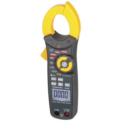

    Time for a more technical evaluation - what current are the motors drawing at peak load?
    I use this for measuring-
    it can measure DC and has a min/max mode to capture fast transients.

    the motors definitely draw more than they are given for. Even with 2 MM per motor I had to limit the Pmax to 220 in Smcutils in order to prevent from overheating... I'm pretty sure we have good amps meters at work, I'll try to borrow one, good idea. ;)
