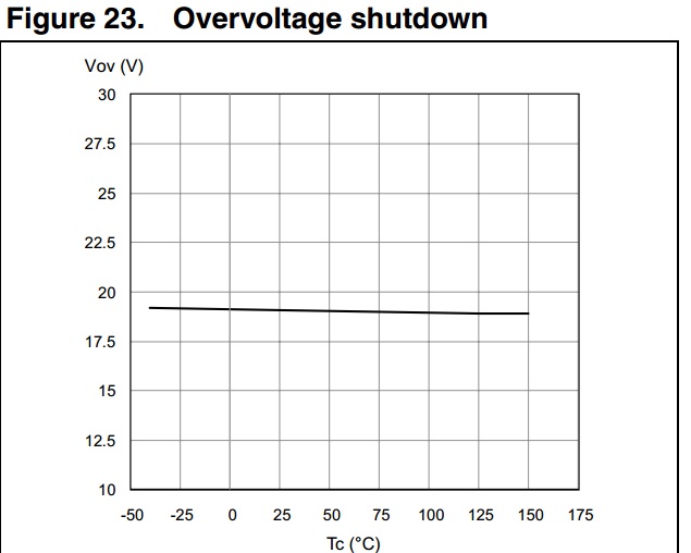

    I 24V motors. Moto Monster voltage max: 16 v. What can you advise what to do?
  6. Pit
    3,007
    30,510Coins
    +3,098 / 31 / -0
    Hi @Nur let me explain what I I have found so far from SparkFun ( I am NOT a electronic guru, other know it way better than me ;) ): the nominal working voltage of the VNH2SP30 is around 12 - 13.8 V (automotive use). The 41 V limit is an “absolute maximum rating” specification for VCC, that is the maximum sustainable supply voltage by the internal H-bridge. As you can see in the data sheet, the shutdown protection voltage is pretty much lower. Normally the driver is going in protection mode already by disabling the output when VCC raise over about 16 V.

    Withstands 24V. Do I understand correctly?
  8. BlazinH
    BlazinH Well-Known Member
    Oct 19, 2013
    2,145
    Oklahoma City, USA
    16,691Coins
    +1,839 / 32 / -1
    No. Maximum voltage is 16v.
  9. Pit
    3,007
    30,510Coins
    +3,098 / 31 / -0
    Here you go: http://users.elite.net/runner/jennifers/no.htm
    Along to the specs - as far as I can read and understand - not possible.

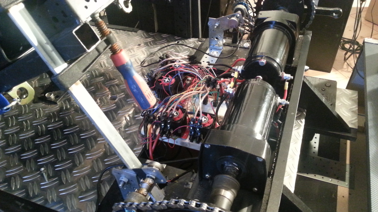

    @Pit & @RacingMat Thanks for the advise! I read the T&C´s and it states to test and claim within 3 days after receiving the shipment. I am travelling a lot so that will be impossible to comply with. However the price of $12,00 a piece if I need 8 order 10 and find 2 failing it will still be cheaper than the Sparkfun MMs á $69,95 a MM. Just started to compile some parts to build 4 12Vdc 640W servo controllers containing 2 meanwell 320 12 PSUs (parallel with schottky diodes (40CTQ150)) connected to a "DC busbar", which will supply the MMs... t.b.c. on a new thread but like to have you guys on board for further advise and ideas? :thumbs

    My expecial thanks for the great job..thanks to you i could made my first dinamic seat...compliments
