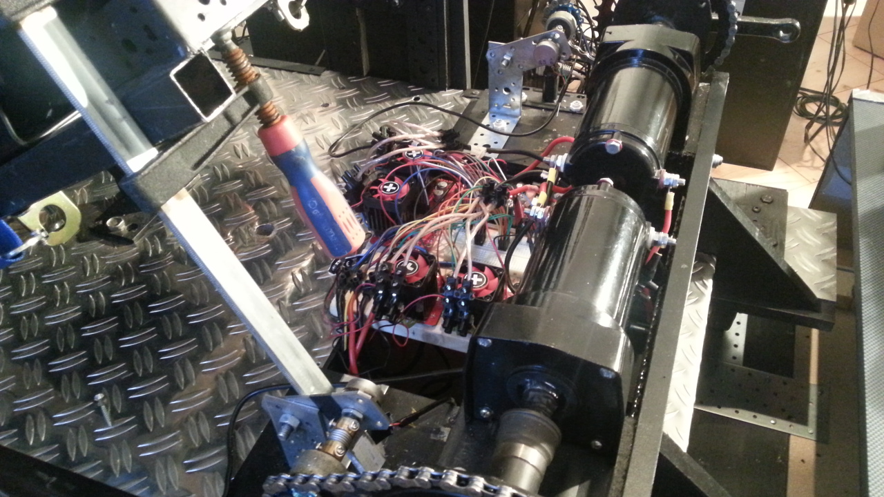

    only (Edit) 60$ including the Ard (wiring and cooler extra) and you get an insane motor driver for two motors on a high level -> 60A/120A - what else!!!!!!!!!!!
    The durability of the half bridge has been successfully tested, as a dual half bridge driver the durability is not yet known.

    I did a test run.....
    What do you mean happened?
    Nothing, only
    WWWWWOOOOOOOOOOOOOOOOOOOAAAAHHHHHHHHHHHHHHHHHHHH, HOLY SHITTTTTTT, WT**** the the world is coming to an end :) Cannot explain it better, my winches are now at full speed and full load, no issues, no stops, no nothing only body destroying turns ...video follow soon ASAP.

    @Bobsyouruncle187 yesterday all my car fuses (directly after the PSU) have been blown, I have no replacement. Today I will go to my local dealer to buy some fuses and in the afternoon I will "shoot" the video.

    Uploading, from now you have to wait some minutes until the video is uploaded an rendered by youtube.
    One round Nord, BTW Snoopy Nord has not the same surface like the laser scanned tracks but the biggest bumbs...

    This afternoon I will upload a laser scanned track, there is a different shaking due to the detailed surface.

    Same car Pagani Zonda R now on Nurburgring track. This track has some nasty bumps and holes. Cant wait to drive Nord, I believe after 2 or 3 rounds my rig will be destroyed (probably some weld seams will be broken)

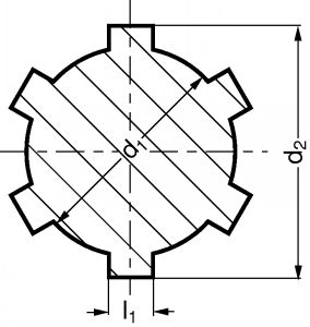

    Can you tell us how you plugged into the motor of the winch?
