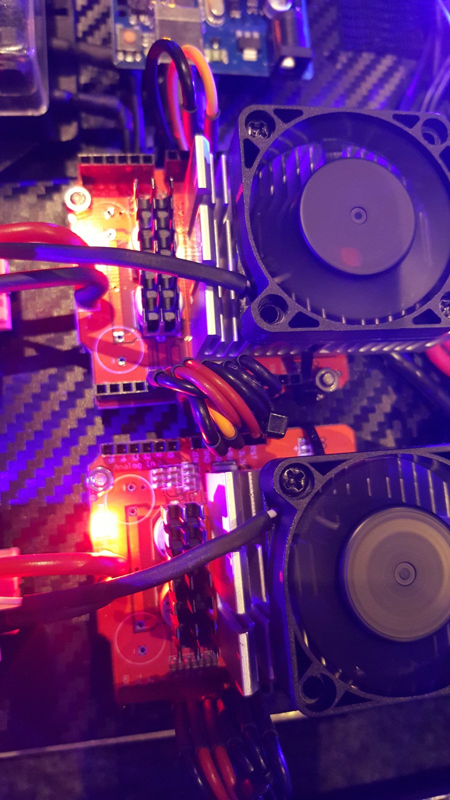

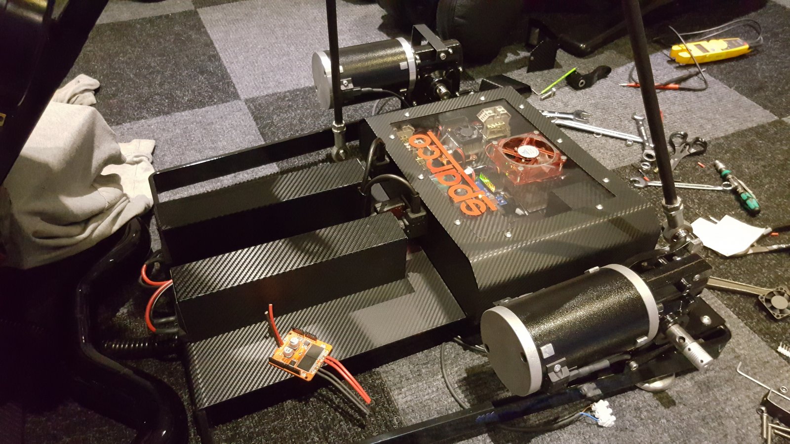

    I'm having some serious trouble about my new build.
    A year ago I builded a 2dof with the racingmat program on a Arduino R3 and some cheap H bridges with wiper motors.
    It has worked just great.
    BUT there were a lot of sound inteference from the motors.
    So I have now converted it to the SMC3 code with some motors from motion control products. Some 90ZYT 155 12v 50:1 ratio.

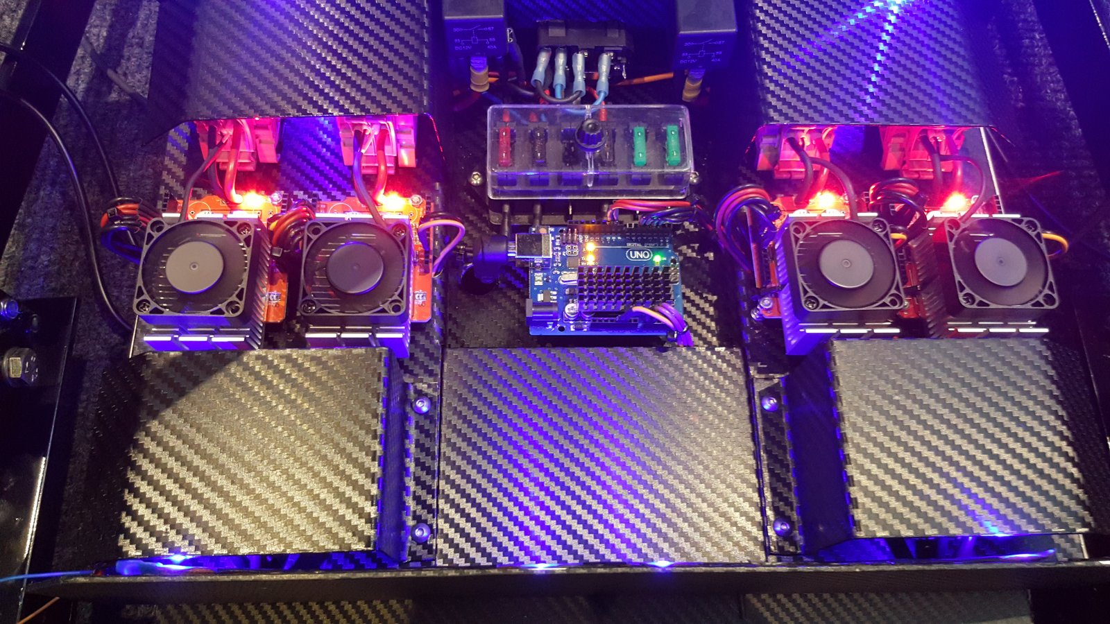

    4 moto monster shield for controlling the 2 motors with 2 47a HP PSU's
    There is something besically wrong.
    I have now fryed 3 Moto monster controller cards.
    They all die on the same motor.
    So I really believe that it has some kind of defect on that!
    But the other motor still get the 2x moto monsters heatsinks very hot at a PWMMax at only 100.
    And only after 2 minutes of use they are around 60 degrees hot. (Uses thermal pasta between MM and heatsink and some cable strips to keep them together.
    Starting to believe there is something fundamental wrong.
    I can drive with the wiper motors at 215 PWMMax for several hours without any heat more or less.
    Really starting to consider switching back to the wiper motors :confused:
    Thanks in advance :)

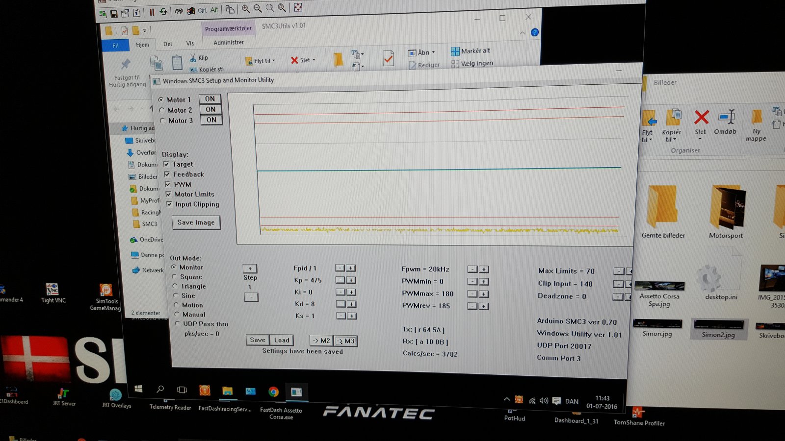

    P.s. The settings in the picture is as present. But ran the wiper motors with the high PWM settings. With the 90zyt motors it is at 100.

    Dunno if this may help but set kd=0.

    Thanks Pit..
    What outcome do you think that would change?
    Mayby less heat?

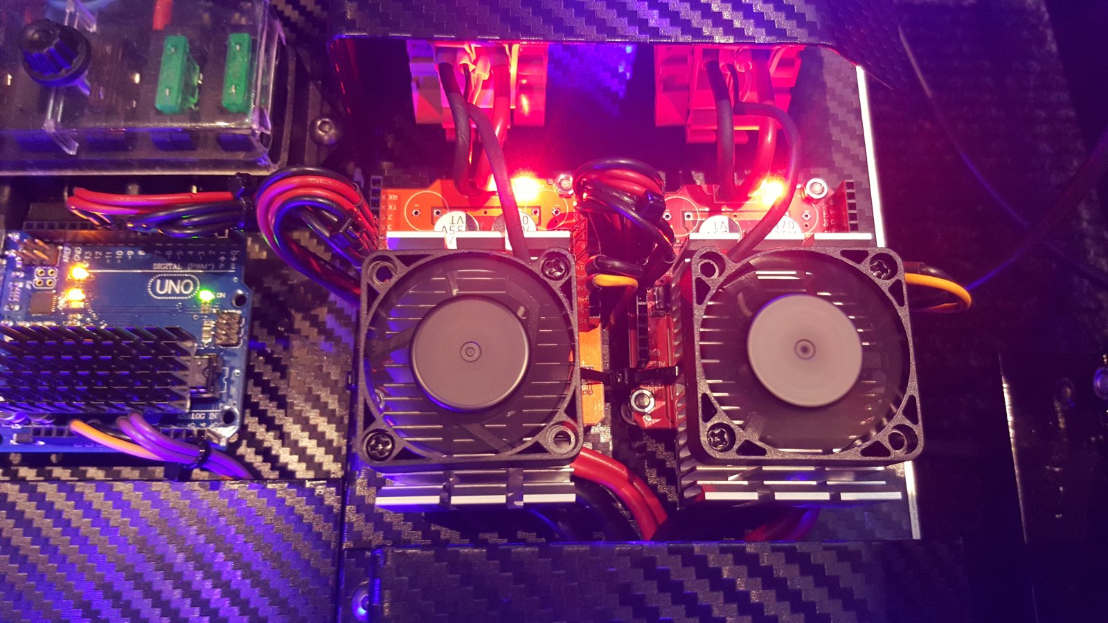

    After adjusting the deadzone to 2 my MM's doesnt get warm anymore when it is "ready to go" (Asume it must have been my pots which have made some inteference so the motors was confused and all the tine tried to adjust and therefor heated ud the MM's chips.
    It is now durable to use. But have adjusted my PWMmax to 145 and PWMmin to 0.
    My kP is only at 360 at the moment. The chips doesn't get too hot anymore.
    But the resistors (Or what the 2 small round ones in front the chips is called ;)) are still getting a bit too hot.
    Have now mounted a heatsinks on them. They are getting around 70 degrees hot.
    Is that normal??
  7. Pit
    3,013
    30,417Coins
    +3,088 / 31 / -0
    I never had any issues ever with the resistors, even I did not determine if they got hot or not...cooling the chips is mandatory but not the resistors at all. Congratulations that you got it and in future you will fiddle out the best settings but this needs time.
