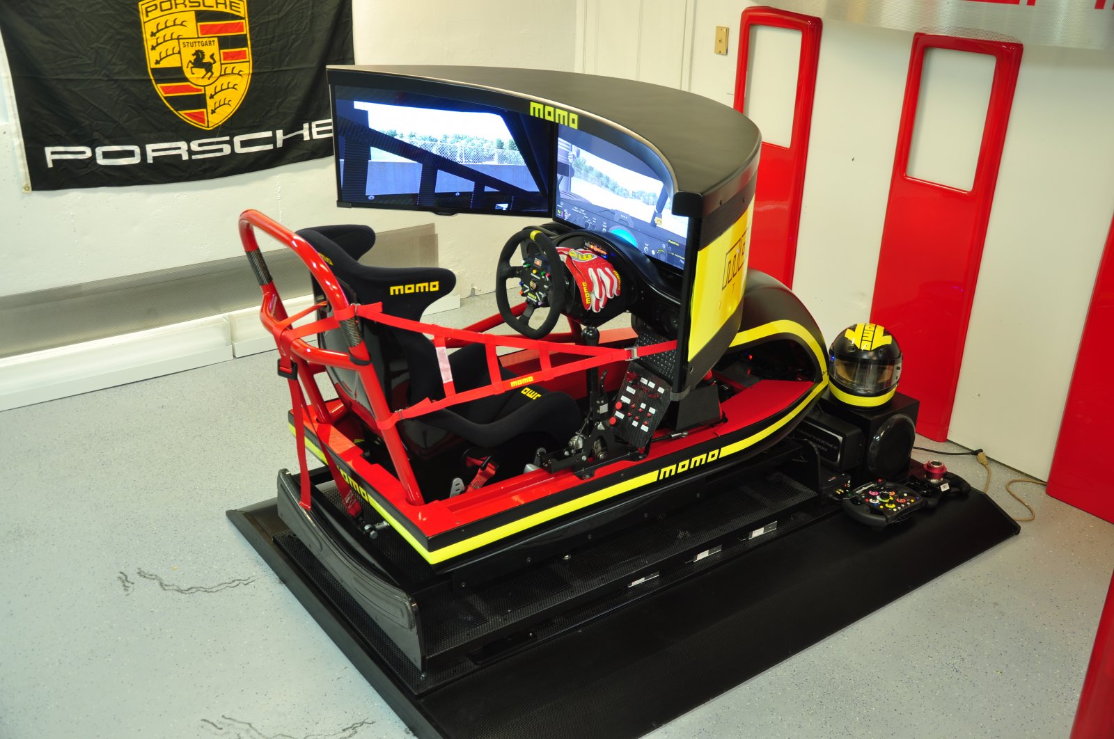

    after many week of testing and tweaking . simtools is now compatible with scn6 Actuators .
    tested my rig . with simtools . an compare with my other motion software .simcraft . simxperience . with the same rig and hardware . definitly simtools is on par with my other comercial software . but you can tell simtools run faster.
    all the motions run very fast and accurate . and no need to use any smoothing filter . simtools run smooth out of the box . also to mention i can now mix ac and dc motor with CNC5 and 6 . who is not possible with the other comercial softwares
    Again Thank you very much to
    yobuddy for making SCN6 compatible with, the wonderful motion software .
    aslo thx to eaorobbie and bsft for some help with simtools guide . and technical assistance .
