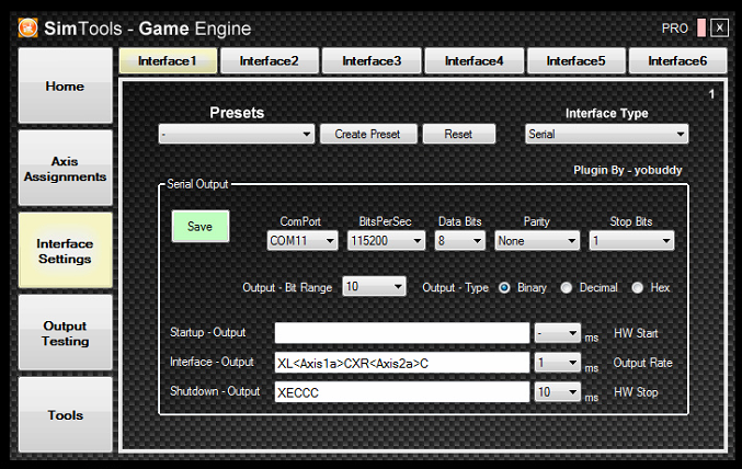

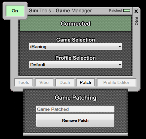

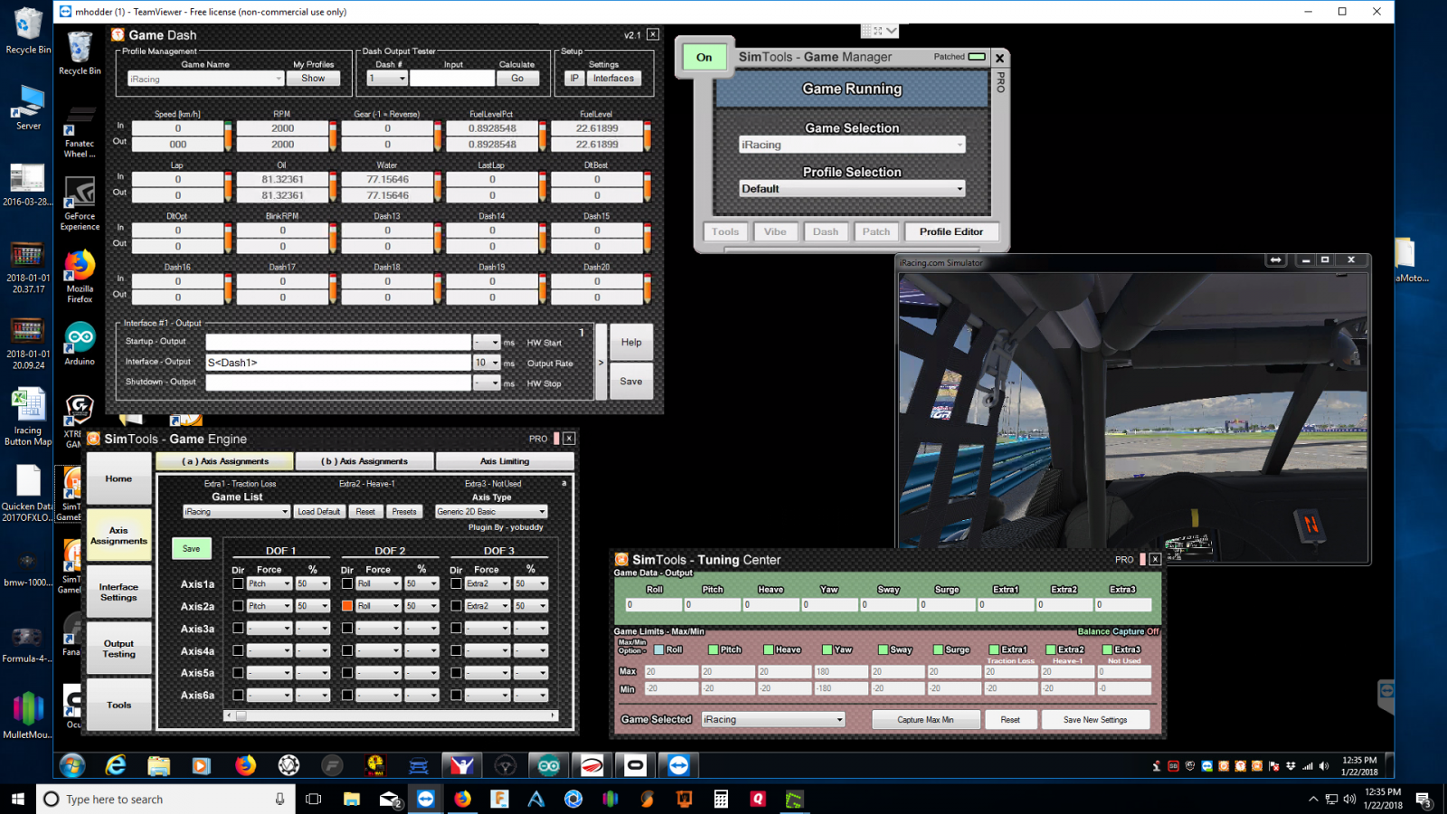

    I am running Iracing and every time I launch iracing game engine crashes. I can start it back up after iracing is already running, but i'm not sure if that is allowed. I am trying to get motion working and I get no value in the game data output of tuning center when running iracing. I dont know if that is due to simtools crashing when iracing starts or if that a whole other problem. Dash is still working even with a late startup.
    game engine also seems to be crashing whenever I enable and disable the game manager.
    any help is appreciated, I am so close to getting everything working.

    It's easiest to select "-" for force to temporarily disable the output.
    @Hoddem
    I don't recognize the interface settings at all.
    What are you running buddy?

    +717 / 2 / -0
    Hey @yobuddy, I am using @vthinsel's XPID for arduino mega and sabertooth. The interface settings are working great, I have everything moving when I have output testing turned on, but nothing coming through when I am in iracing.
