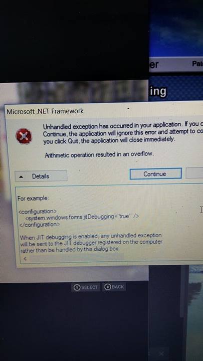

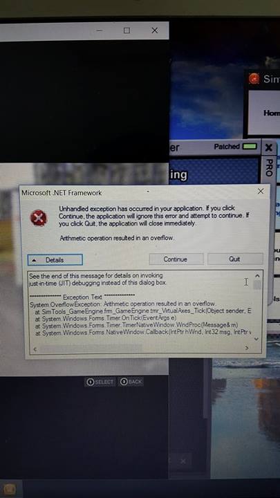

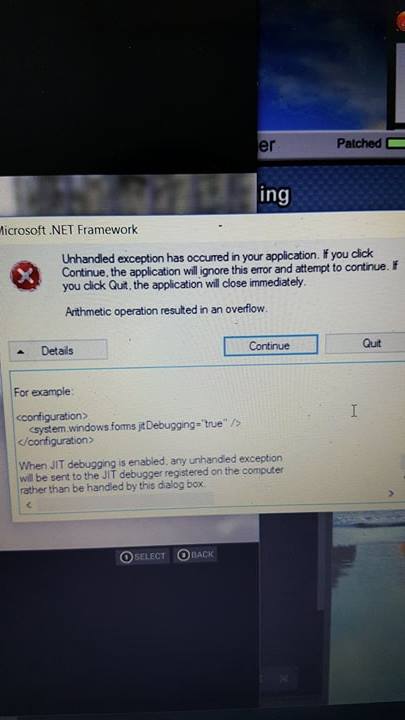

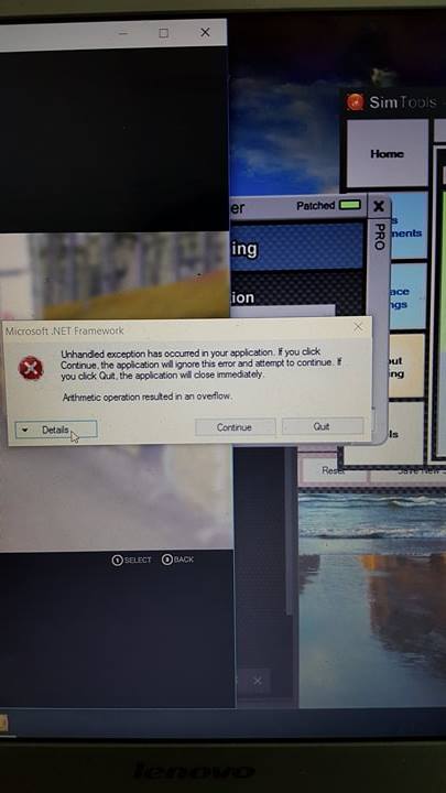

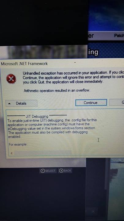

    Help me ..... when run dirt 4 game there is error information like picture below

    @Faldri the path for patching Codemaster games for motion differs, depending on it being a 32bit or 64bit version of Windows.
    32bit is patched to the game install path.
    For example 64bit Dirt Rally is patched to C:\Users\Your_User_Name\Documents\My Games\DiRT Rally: https://www.xsimulator.net/communit...-32-bit-install-path-for-motion-patching.260/
    Also make sure your computer language is set to English local: https://www.xsimulator.net/community/faq/simtools-language-setting-bug-change-to-english-local.233/
    If the problem persists reinstall .Net

    You have what system, 32 or 64 bit, and which path did you patch?
    Did you run the game before patching?
    Have you changed your language settings?
    Have you reinstalled .Net?
    While the game can install elsewhere it will store some information on the C drive.

    I have system 64bit....
    I've been patching......I've also run games before patching.
    How to reinstall net.

    Thank you very much.....It turns out the problem is because the language I used before korea Now it can be without problems.....How to set the correct tuning center (MAX/MIN
