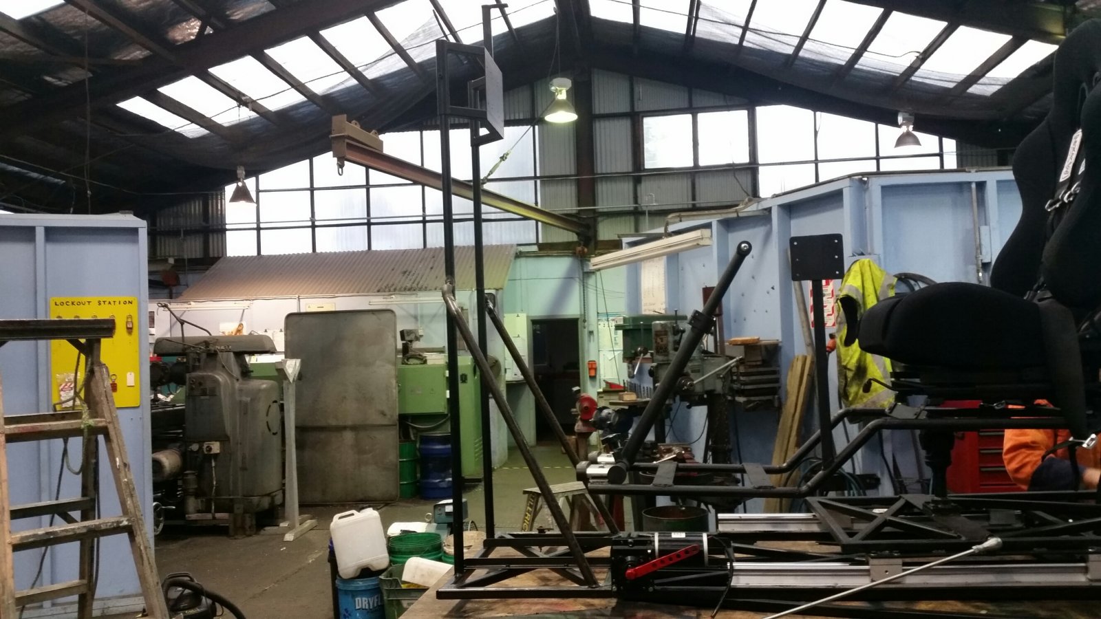

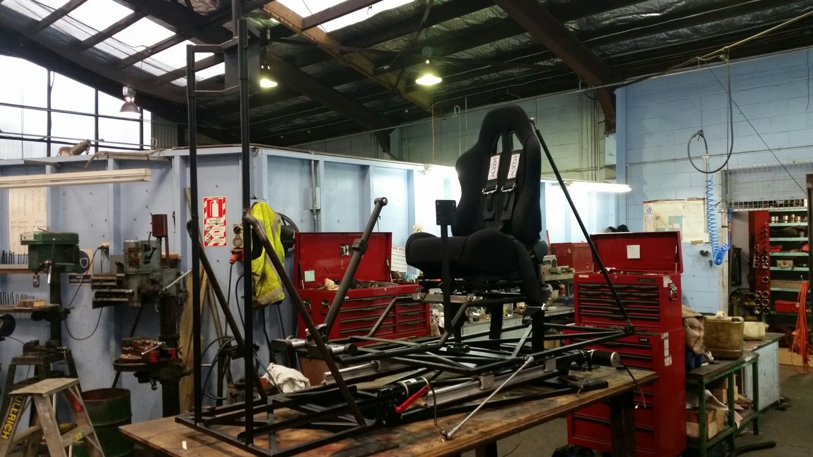

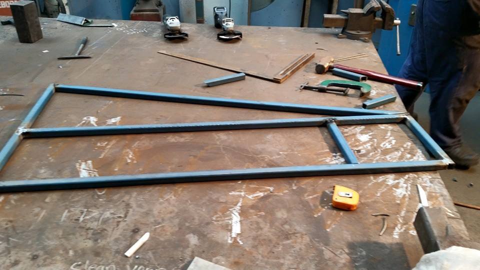

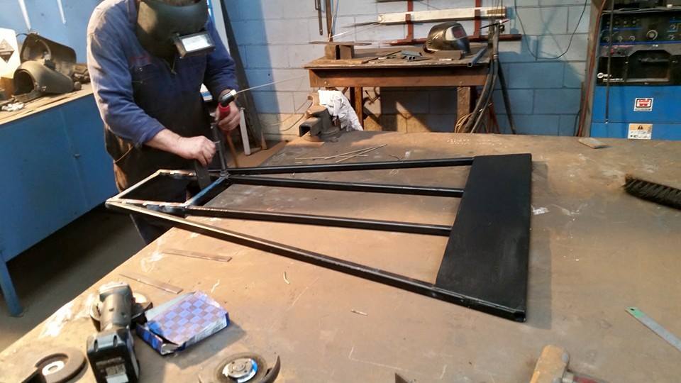

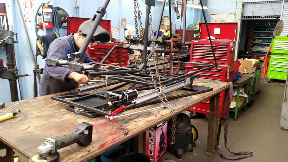

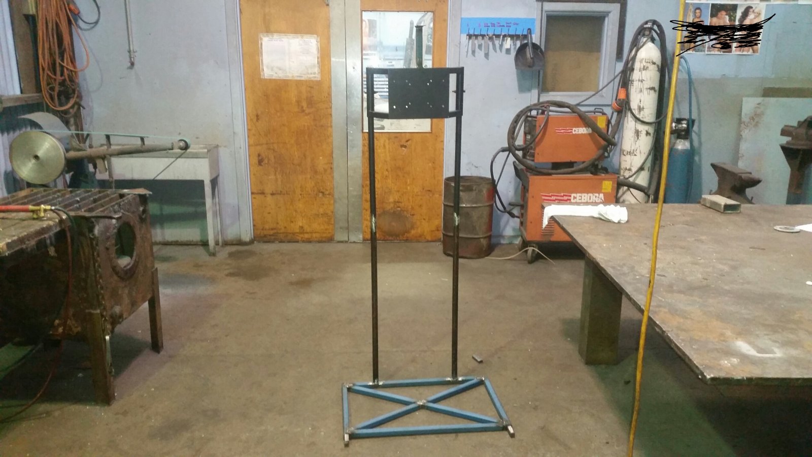

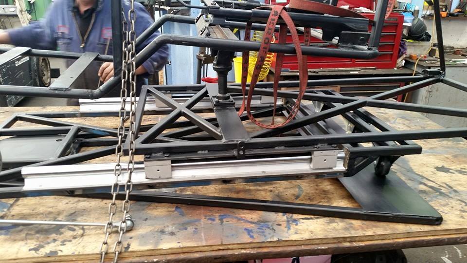

    Back home now after 4 days of work on simulator. Unfortunately the motor mishap means I couldn't get it running this weekend as we didn't have the arms made for the 50:1 motors yet however we did finish building the frames. Ill be back up in 3 weeks and hopefully get a bit more done!
    Pics show current state

    You have had one hell of a productive weekend @Boomslangnz, great work and thanks for the video, I really wanted to see the linear rails in action!

    Really professional craftsmanship, I would be happy if I could do at this high skill level :)
    The only one remark (which is no criticism really, only an opinion of my impression at all) depends the design, I wonder about the relationship of surge - traction loss. If the seat moves [EDIT] back [/EDIT] (eg. while braking) the TL radius will get wider. Dunno how much this will result effectively. Further surge reduces/extends the distance to the screens if the latter is not mounted on the rig, ergo this has a influence of the FOV.
    Please do not misunderstand my intention, I would do it the same if I could do so :) Mostly our sims are compromised designs, advantages and disadvantages have to be gauged to each other or better said: we have to balance pros and cons

    No worries at all. We discussed how to do the design for awhile to be honest and alot of it is trial in error I guess. Fov shouldn't be affected really as I'll be using oculus rift as my main device
    and yes there was some talk about the surge affecting TL but hopefully it works ok, seems too at the moment

    My setup uses a seatmover and not a full frame, so it is not quite the same. Originally I had my monitor moving with my surge/traction loss - so obviously no change in FOV. When I went to Oculus - due to the flexing/shaking of the frame I had to mount the camera off the rig, so you do notice a slight change in FOV (like you are moving your head forward and back) with surge, but I don't notice anything with traction loss. I like using the Rift so much (especially now with sweetfx) that I have got use to it. Haven't bothered upgraded anything on this sim to fix it, as I am building a whole new sim.

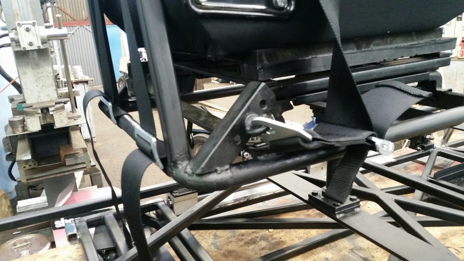

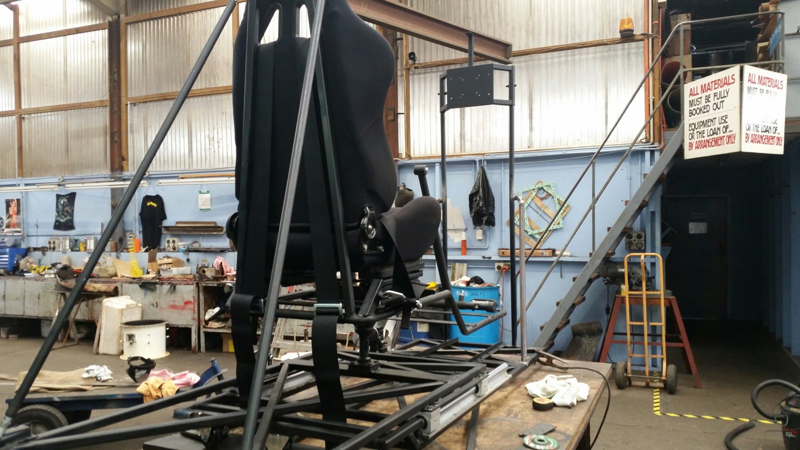

    made another trip up and did a little more work. Still hadn't made the ctc lever etc for the 50:1 motors so couldn't get it running still however spent the time adding some stuff such as a harness and a monitor mount and camera mount for oculus with ability to remove off rig if needed. It slides into front of traction loss frame.
    Last bits and pieces are being made while im away and it will be ready for me to finally wire everything up when Im next up so pretty happy to finally have everything basically built now. Im pretty tired after the weekend, a lot of work has gone into it now so hopefully its worth it in the end
    Ill upload pics later if ive got time

    Pics uploaded

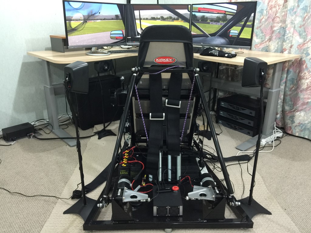

    Looking good @Boomslangnz.
    Once you get it moving you should try attaching the shoulder belts to the base via something with a little give, like springs as seen here: http://www.xsimulator.net/community...9qa.jpg&hash=e33232bdb1aa5181e52cc6461429519f
    That way the movement of the seat adds additional motion cues via the harness. You don't have to get fancy to try the effect. My temporary arrangement on my sim is a couple of bungy cords, as I am stil messing with other aspects of the harness. Try it and judge for yourself.

    I am not sure. I am only guessing but a trampoline spring may be a bit too firm.

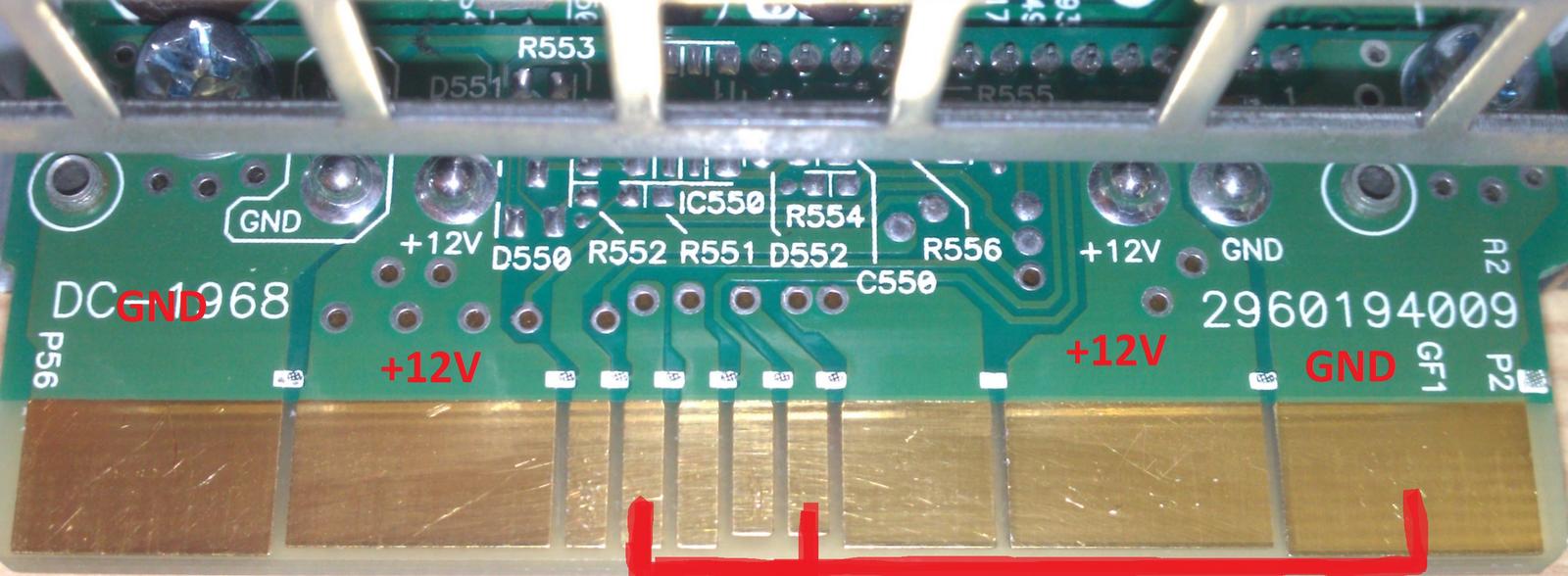

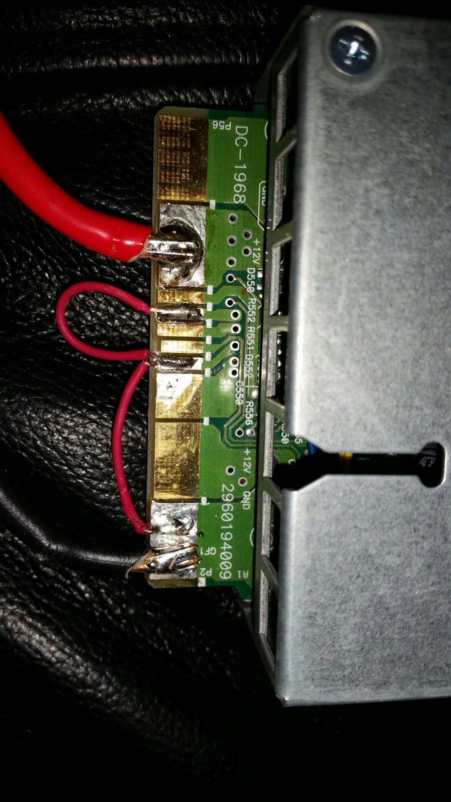

    new question fellas, just to make sure on these
    This is all I have to do on these HP 700w server power supplies?
    Just a jumper between those points and run my main 12v as per soldering
  14. Boomslangnz
    Oct 26, 2014
    346
    4,167Coins
    +243 / 1 / -0
    nevermind found info on it and yes I was all correct.
