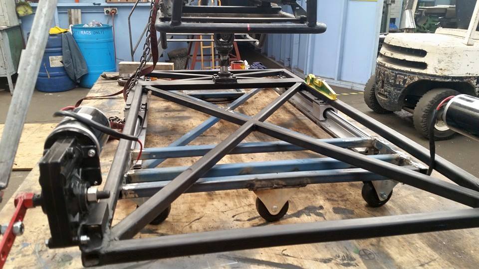

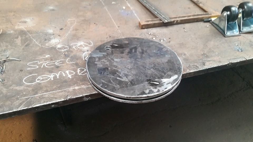

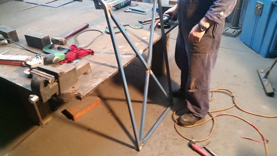

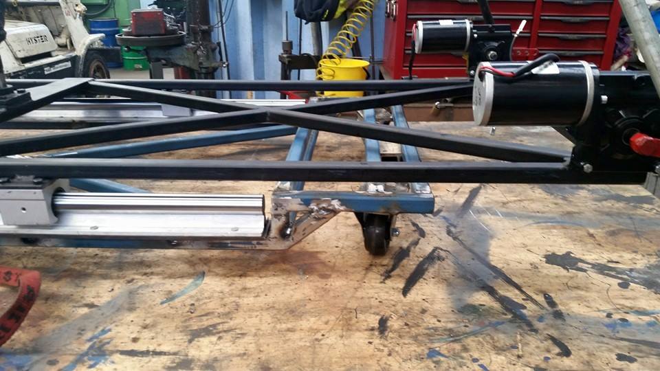

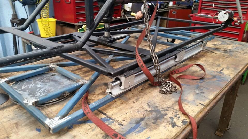

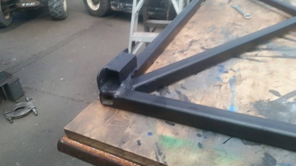

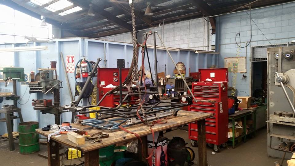

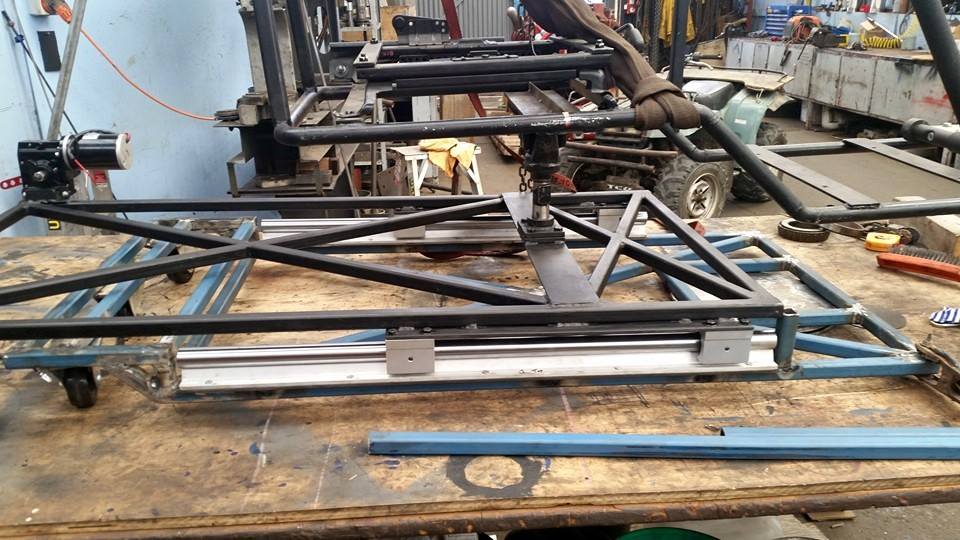

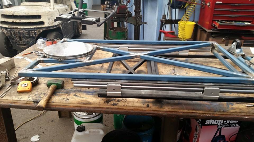

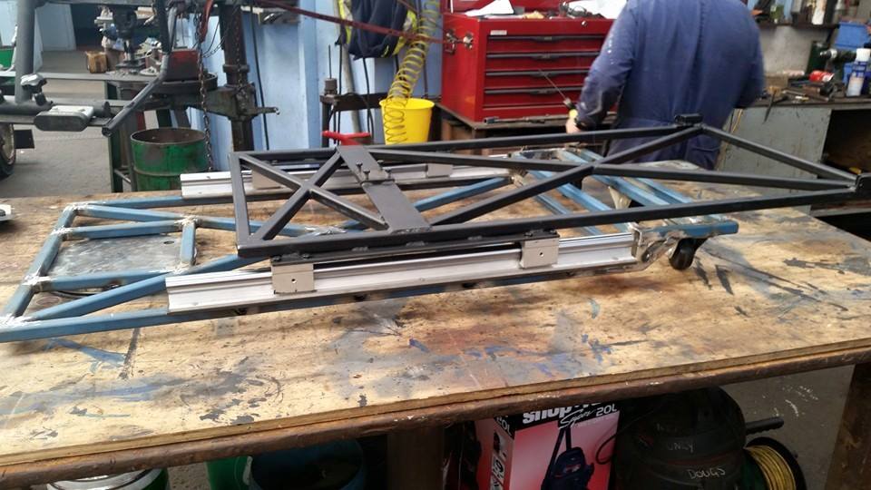

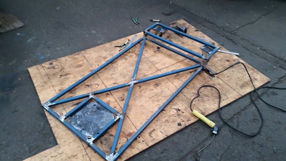

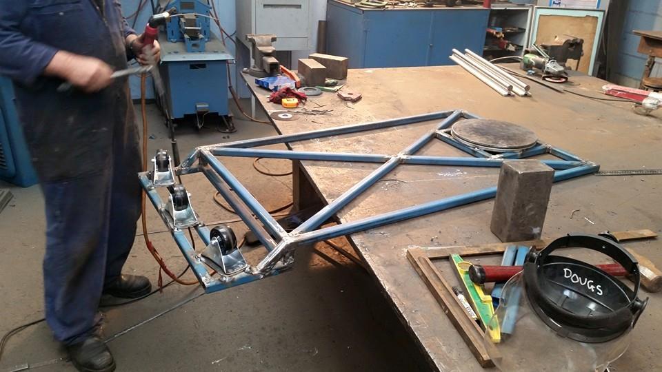

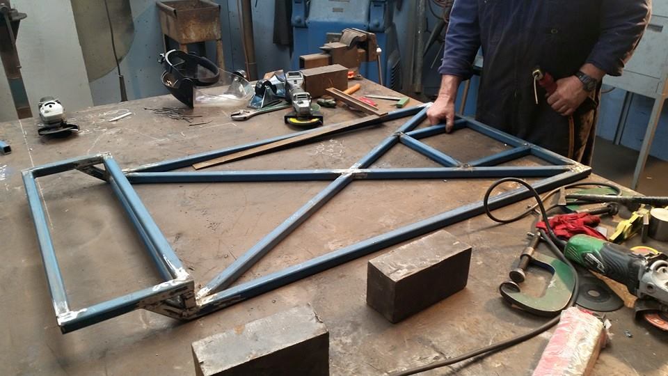

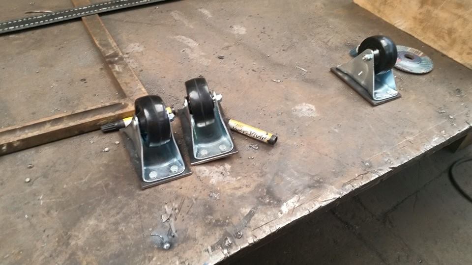

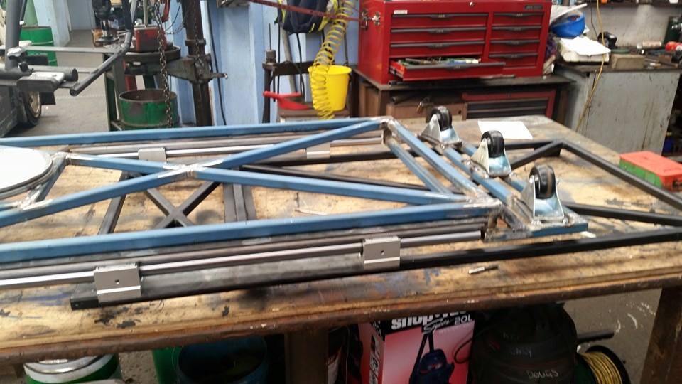

    sorry I didn't take too many photos but a few I did take so here they go.
    10355803_10152890661363335_5590145357077848672_n.jpg 10983380_10152890661468335_3994129360127253809_n.jpg 11088402_10152890661208335_717068792952857974_n.jpg 11099989_10152890661313335_9208686782488420177_n.jpg 11133723_10152890661403335_3638266183232875026_n.jpg
    22,049
    153,890Coins
    +11,154 / 57 / -2
    Thanks for the pictures...I figured you would be making the most of the Easter weekend.
  8. Boomslangnz
    Oct 26, 2014
    346
    4,172Coins
    +243 / 1 / -0
    as you can see from pics im using the linear bearings same as yours but mine will be doing the surge itself. I got a 880mm long one but im only gonna have 340mm total travel max (may not even go that far) so a big thanks to you dude for showing me the way! I was a little worried how they would go to be honest but they are awesome, moved the rig with ease although I haven't tried it with myself on it plus the very top frame yet. Hopefully we can finish the frame building tomorrow as traction loss frame is mostly made so far but haven't shown pics of it yet, just got to get it all sitting level with my 99mm high rubber castor wheels at back and the lazy susan bearing up front which is maybe 10mm high max but we are hopefully onto that.

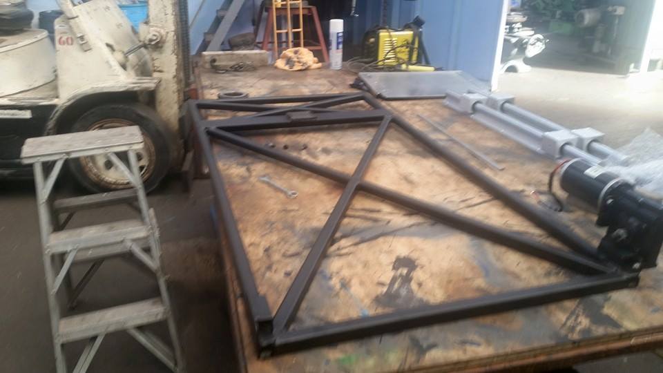

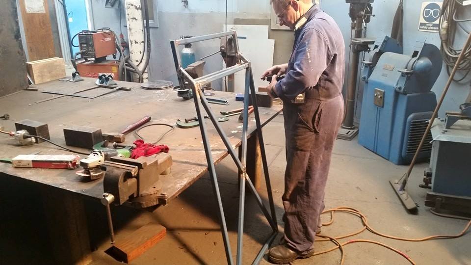

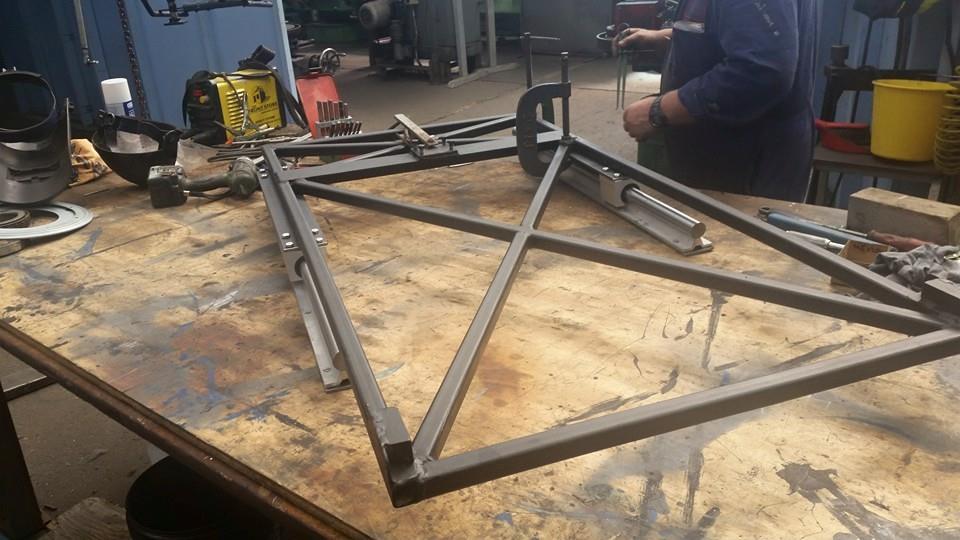

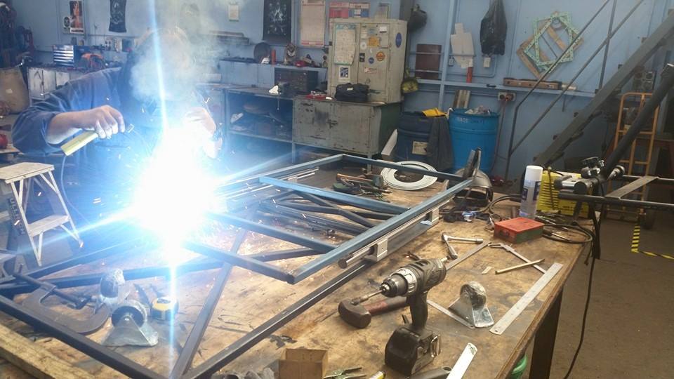

  9. Boomslangnz
    Oct 26, 2014
    346
    4,172Coins
    +243 / 1 / -0
    another day done, traction loss frame basically done except for motor mounting positions etc and hall sensors need to still be added. Put it all together at the end of what we have made so far and seems really good. Both surge and traction loss can be moved around with a single finger. Bottom and final frame still to make which should be the most simple really but lets see how it all plays out, dropped into jaycar and grabbed the bits I needed

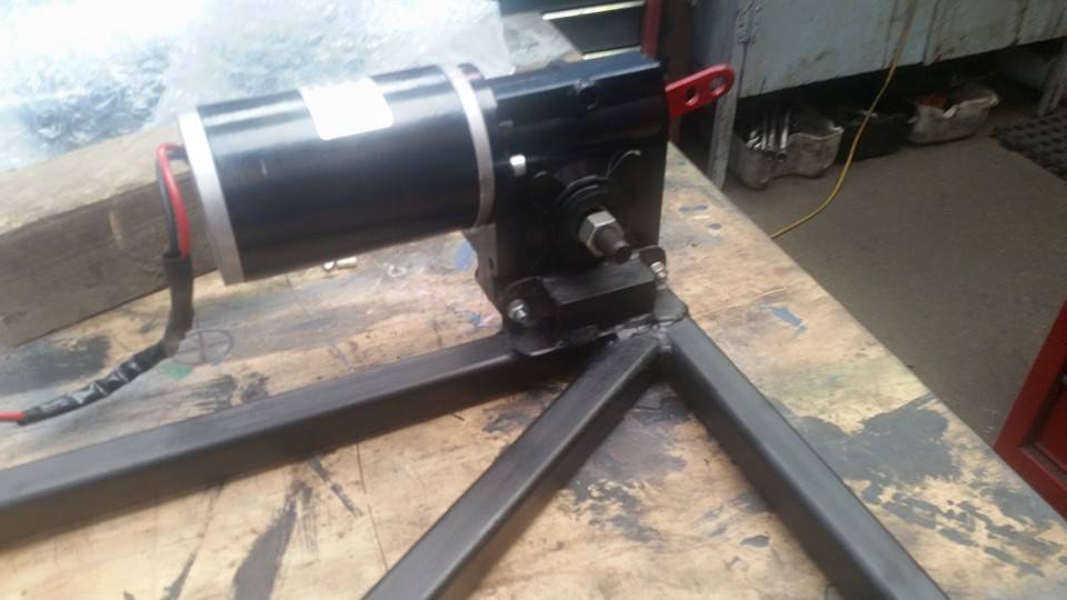

    any tips on how best to mount the hall effect sensors? at the moment we just had a threaded bolt basically going right through to other side of motor and im not sure how best to mount the sensors onto it
  12. bsft
    If they are like a pot, just do it the same way

    So relised I was an idiot and had my motors around the wrong way today eg 25:1 and 50:1 ratio motors so that was cool........
