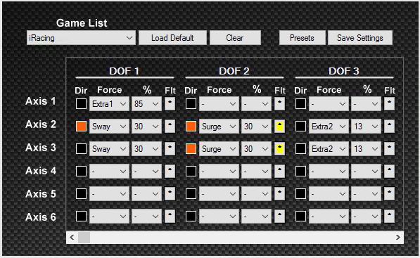

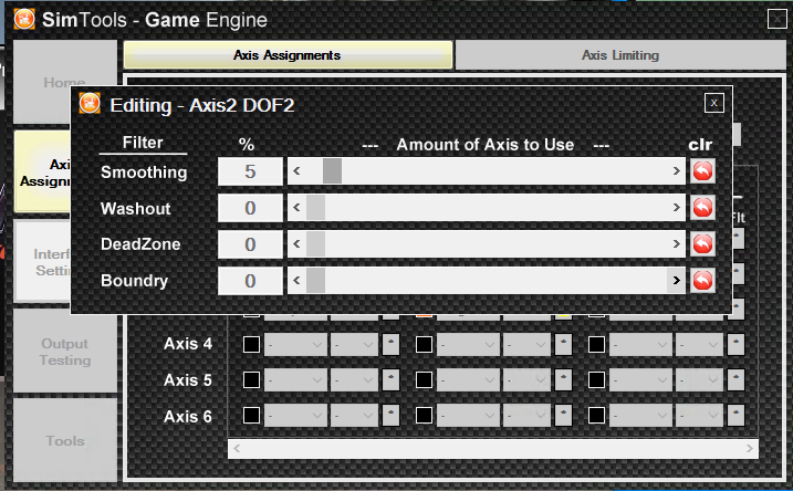

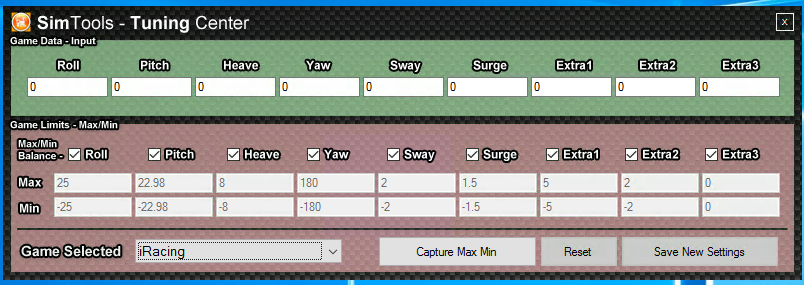

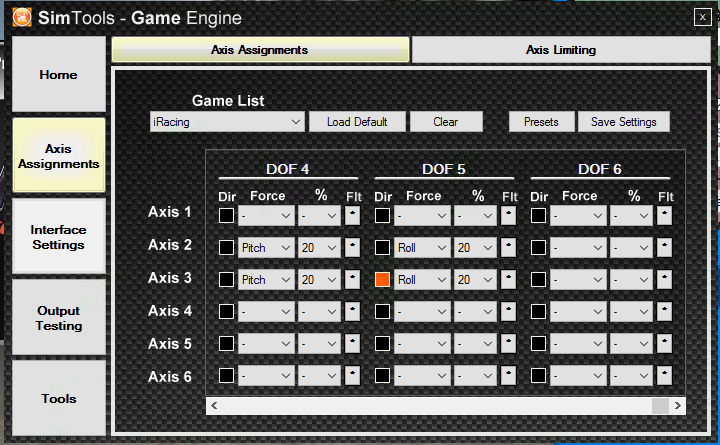

    I plan on making more tweaks to this tonight, but this is what I've been running for a while. @rundmg could also send you his pics of his setup for iRacing, he runs a hotter setup than mine.
    Do you have the Ruf in iRacing? Gear shifts in that are wicked so good to test with.. haha
    Ignore Heave, I'm using Extra2. I've had a way better experience in iRacing with that.
    Screenshot 2015-11-11 15.19.58.png Screenshot 2015-11-11 15.19.46.png Screenshot 2015-11-11 15.19.38.png Screenshot 2015-11-11 15.19.07.png
