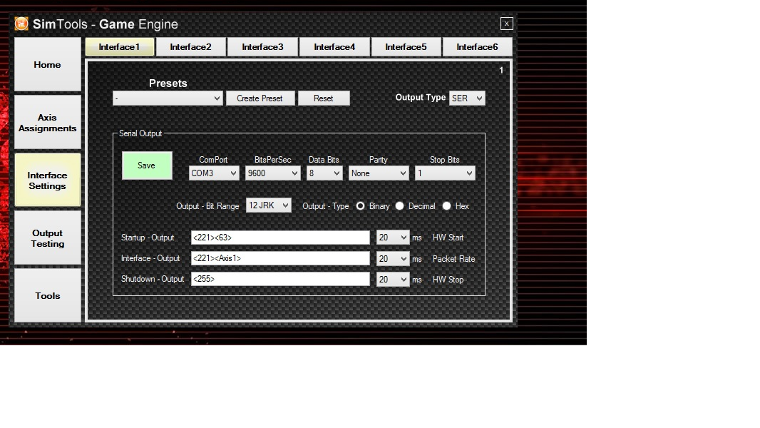

    would there be any reason sometimes game engine seems to stop seeing one motor occasionally and requires restart of pc to get it working again?
    motor still works fine under jrk config
  15. bsft
    Whats the settings in game engine?
    screen shot please
  16. Boomslangnz
    Oct 26, 2014
    346
    4,172Coins
    +243 / 1 / -0
    every interface is setup exactly the same just different axis

  17. bsft
    raise bits per second to 115200 , and can you link me to a page if you have it, for your JRK settings please?
    Kids are on the net here and its really slow

  19. bsft
    thats right, seems ok, but did you try to set the PID individually? Or are you just using the standard numbers?
  20. Boomslangnz
    Oct 26, 2014
    346
    4,172Coins
    +243 / 1 / -0
    Oh yea sorry I did set them individually since those pics
