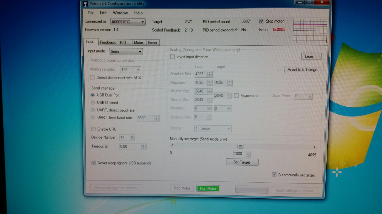

    I probably asked already in the past, but do you have screen shots of each of the utility tabs for the JRKS, so I can check settings please?

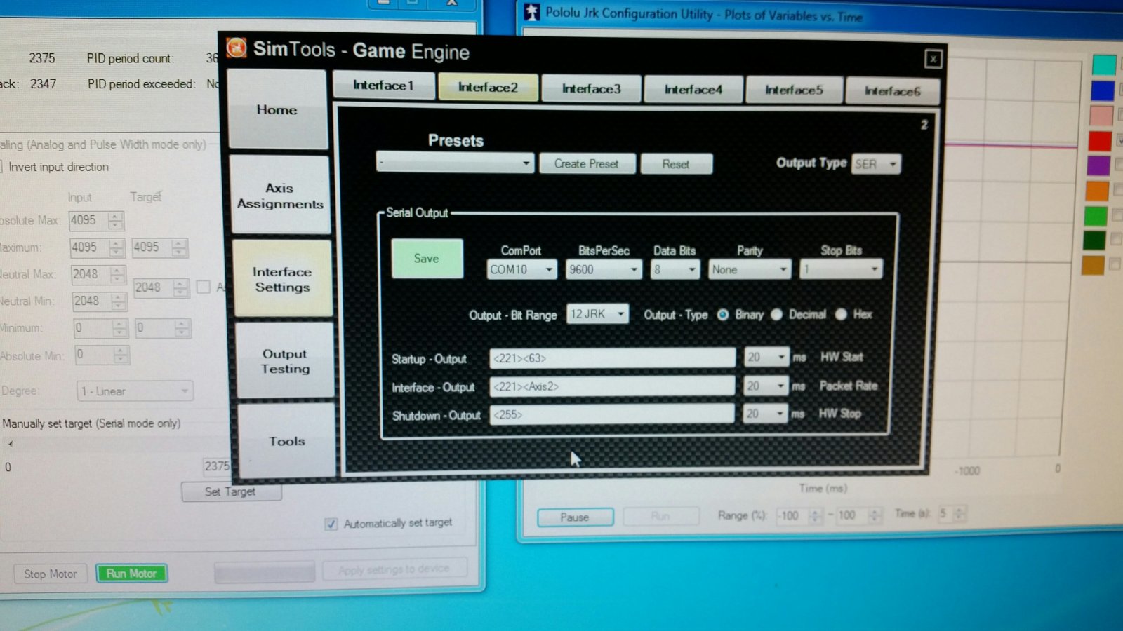

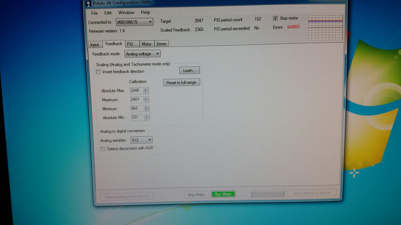

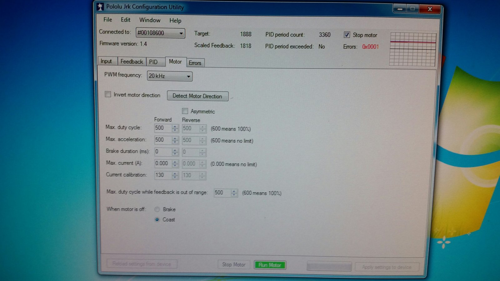

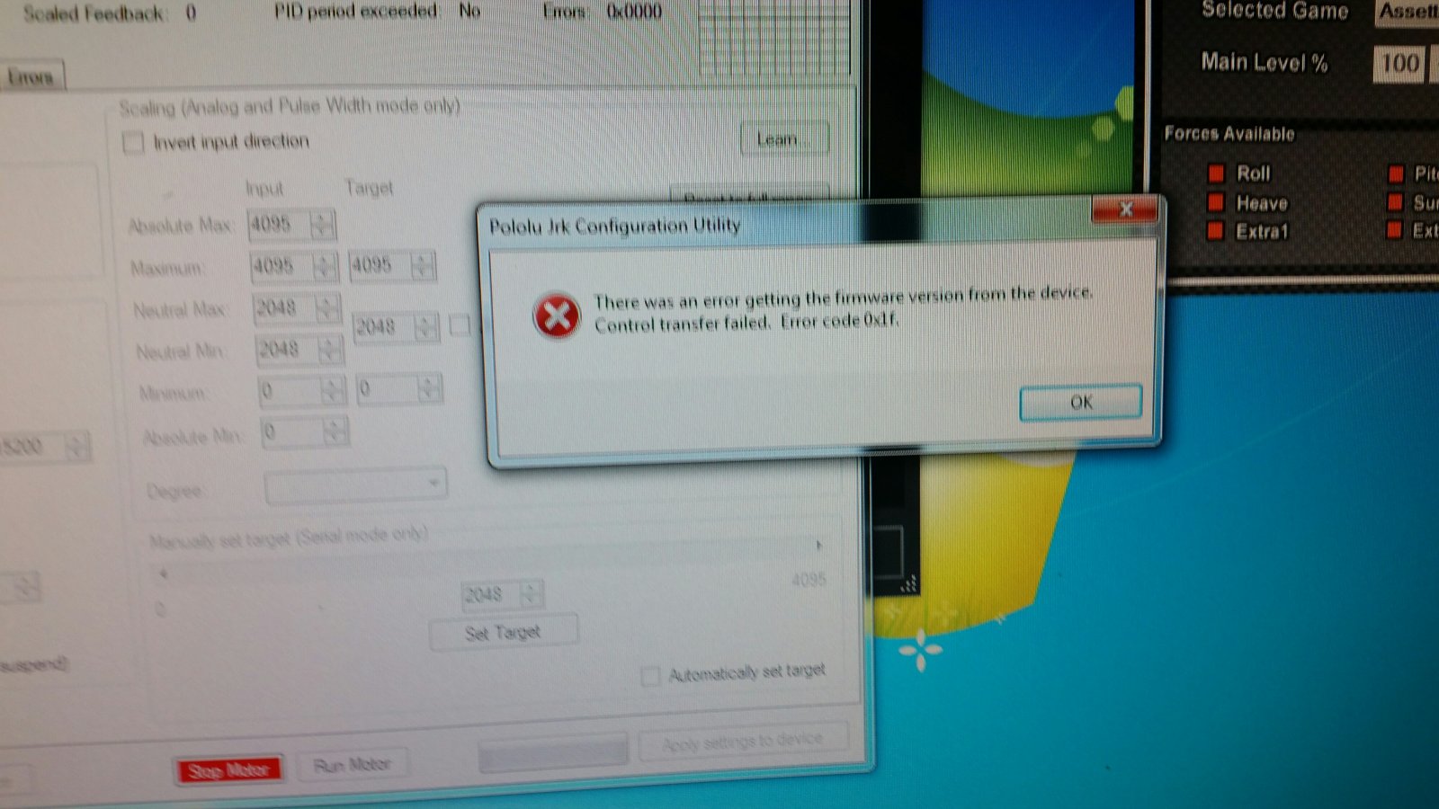

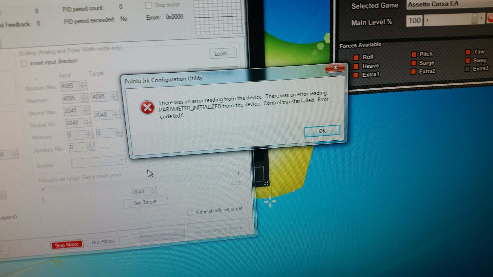

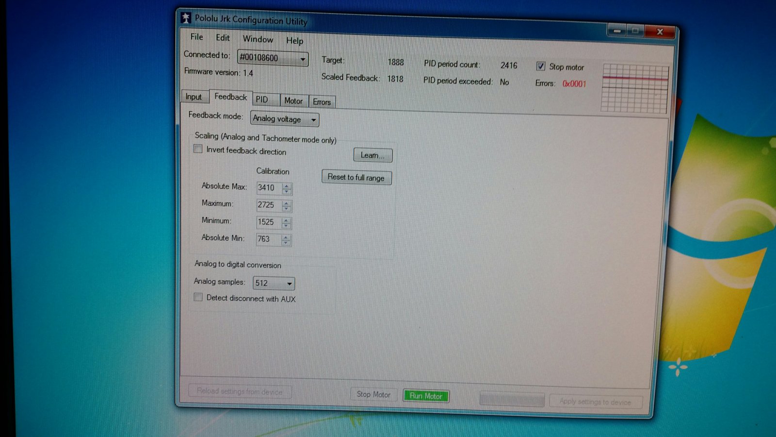

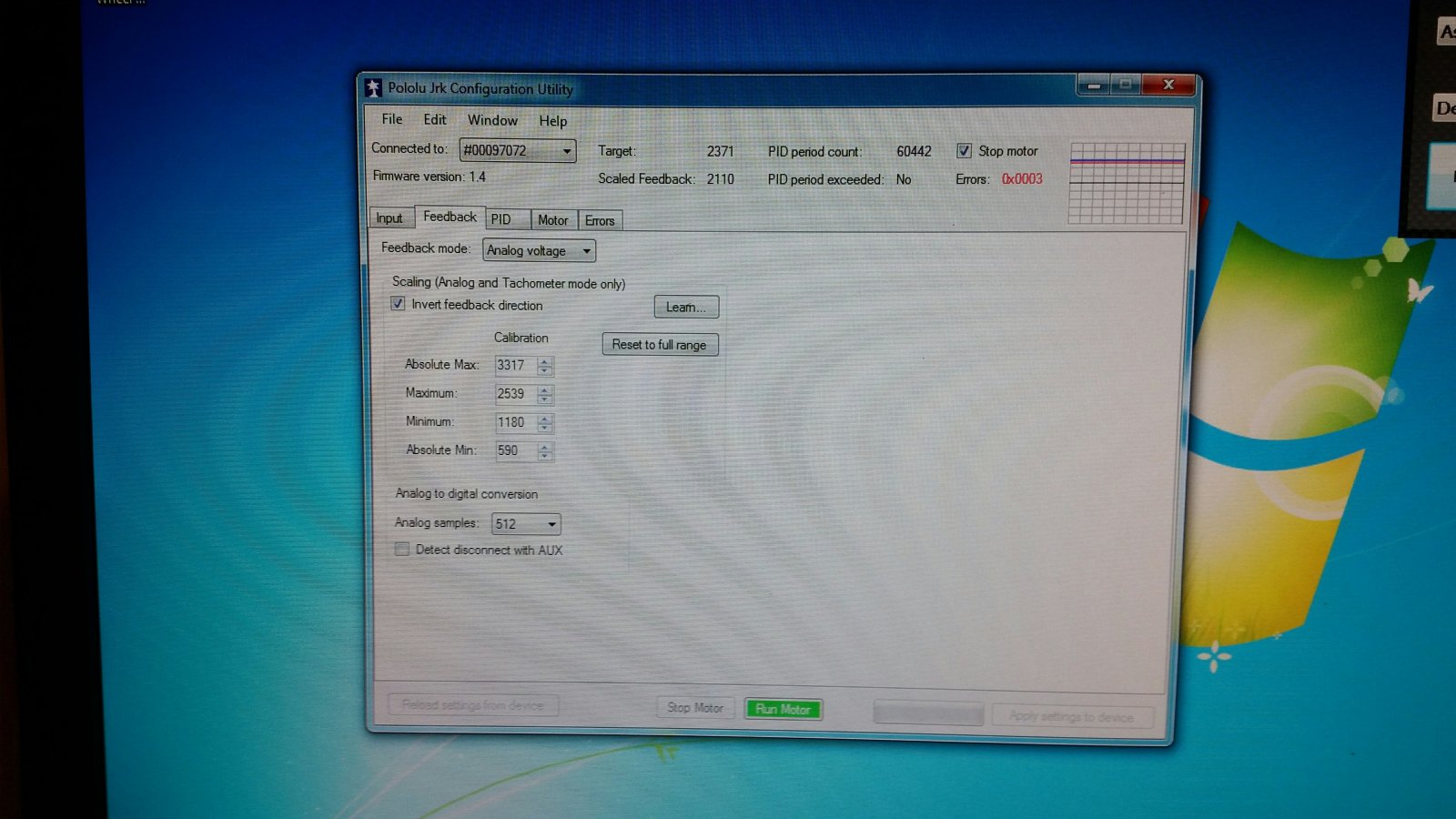

    The power supply has not shut down but instead the JRK seems to lose signal or something as soon as I crash or the motor has to do some quick movement then the JRK stops responding, I see a blinking green light and if I try open the jrk utility it gives me some error about there is an error getting firmware from the device etc etc, If I unplug the usb and then plug into jrk again it boots up fine again
    I set my game engine settings to exactly 100% across 5 forces
    Ill post all my jrk utility screenshots
    #00097072 is rear left 50:1 motor
    #00108600 is rear right 50:1 motor (has the battery in parallel now)
    #00097103 is the surge 25:1 motor
    #00108615 is the traction loss 25:1 motor
    20150617_201907_resized.jpg 20150617_201920_resized.jpg 20150617_202100_resized.jpg 20150617_202111_resized.jpg 20150617_202123_resized.jpg 20150617_202206_resized.jpg 20150617_202215_resized.jpg 20150617_202224_resized.jpg 20150617_202235_resized.jpg 20150617_202245_resized.jpg 20150617_202256_resized.jpg 20150617_202306_resized.jpg

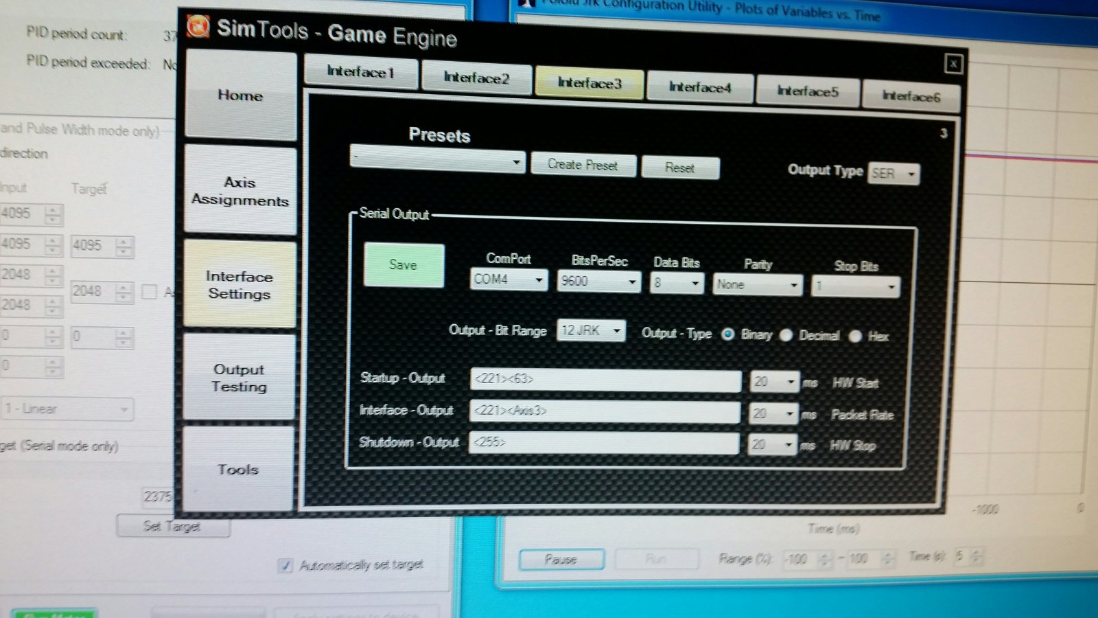

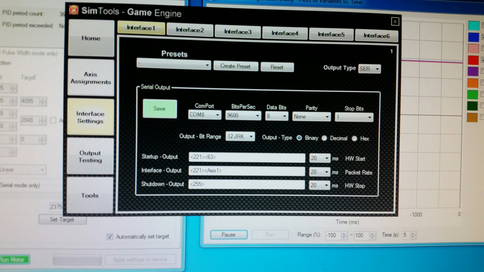

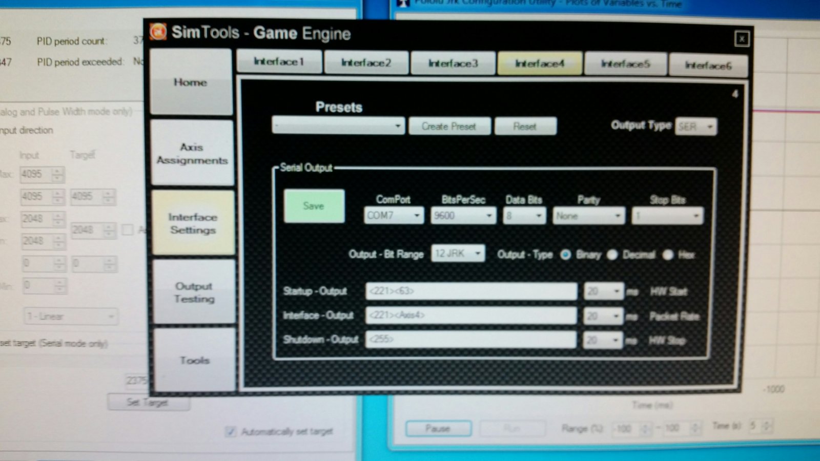

    game engine
    interface 1 is rear left
    interface 2 is rear right
    interface 3 is surge
    interface 4 is traction

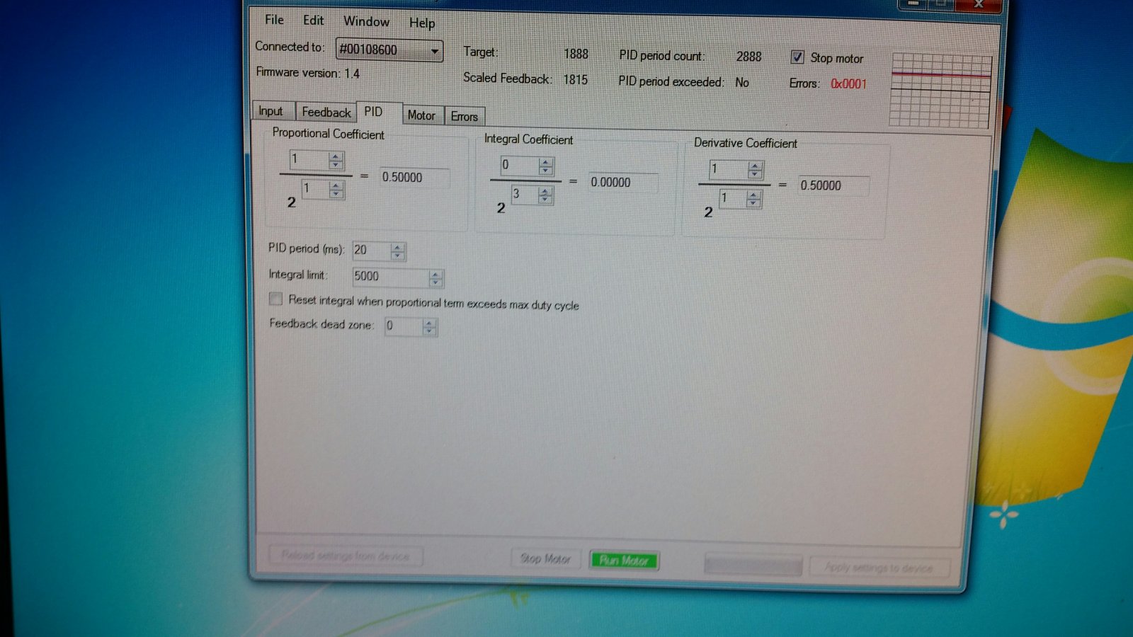

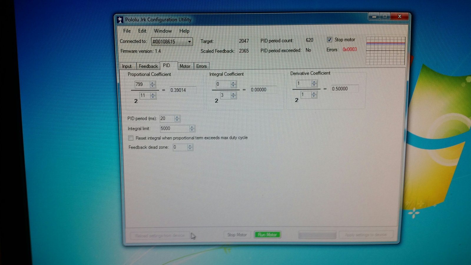

    I'm almost certain its something on the simtools end as when im manually moving the motors in jrk utility I can go way crazy and the jrk doesn't cut out but once running in Assetto corsa it stops working after hardly any movement during a crash or going off the road generally
    Could it be a tuning center issue?

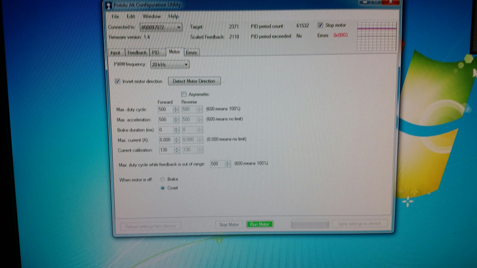

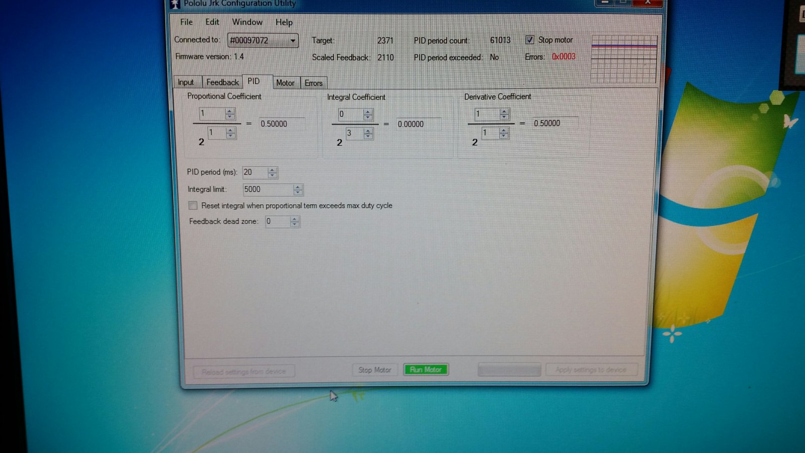

    My guess is something is overshooting or there may be a usb issue, though I think it was @bsft who found batteries actually caused some odd issues.
    Try backing the duty cycles down on the 50:1s to 400 and drop the P in the PID settings and test.
  12. Boomslangnz
    Oct 26, 2014
    346
    4,167Coins
    +243 / 1 / -0
    @noorbeast I dropped max duty to 400 and PID to 0.39 and it's not cutting out now and I was purposely slamming into walls and going off track.
    What does the max duty do?

    From the JRK documentation: https://www.pololu.com/docs/0J38/all#4.f
    Duty cycle target: Represents the duty cycle that the jrk is trying to achieve. A value of -600 or less means full speed reverse, while a value of 600 or more means full speed forward. A value of 0 means braking. In no feedback mode (speed control mode), the duty cycle target is the target minus 2048. In other feedback modes, the duty cycle target is the sum of the proportional, integral, and derivative terms of the PID algorithm.
    Duty cycle: Represents the duty cycle that the jrk is driving the motor with. A value of -600 or less means full speed reverse, while a value of 600 or more means full speed forward. A value of 0 means braking. The absolute value of the duty cycle will always be less than the absolute value of the duty cycle target. The duty cycle is different from the duty cycle target because it takes in to account all of the jrk’s configurable limits: maximum acceleration, maximum duty cycle, maximum current, and also brake duration (Section 3.e).

    Ok well the good news is it seems to run well at 400 duty cycle and with the battery in parallel for those current spikes with the server psu, now I guess I will need 3 more batteries and to re-wire my rig a little but not a huge deal
    Might be easier then trying to get new power supplies when this will work anyway

    I still think you should work more with PID though on each motor, but if its working, up to you

    Yeah I did play with PID a bit and put max cycle back to 500 now and doesn't cut out at all
