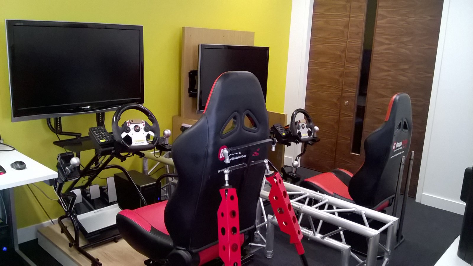

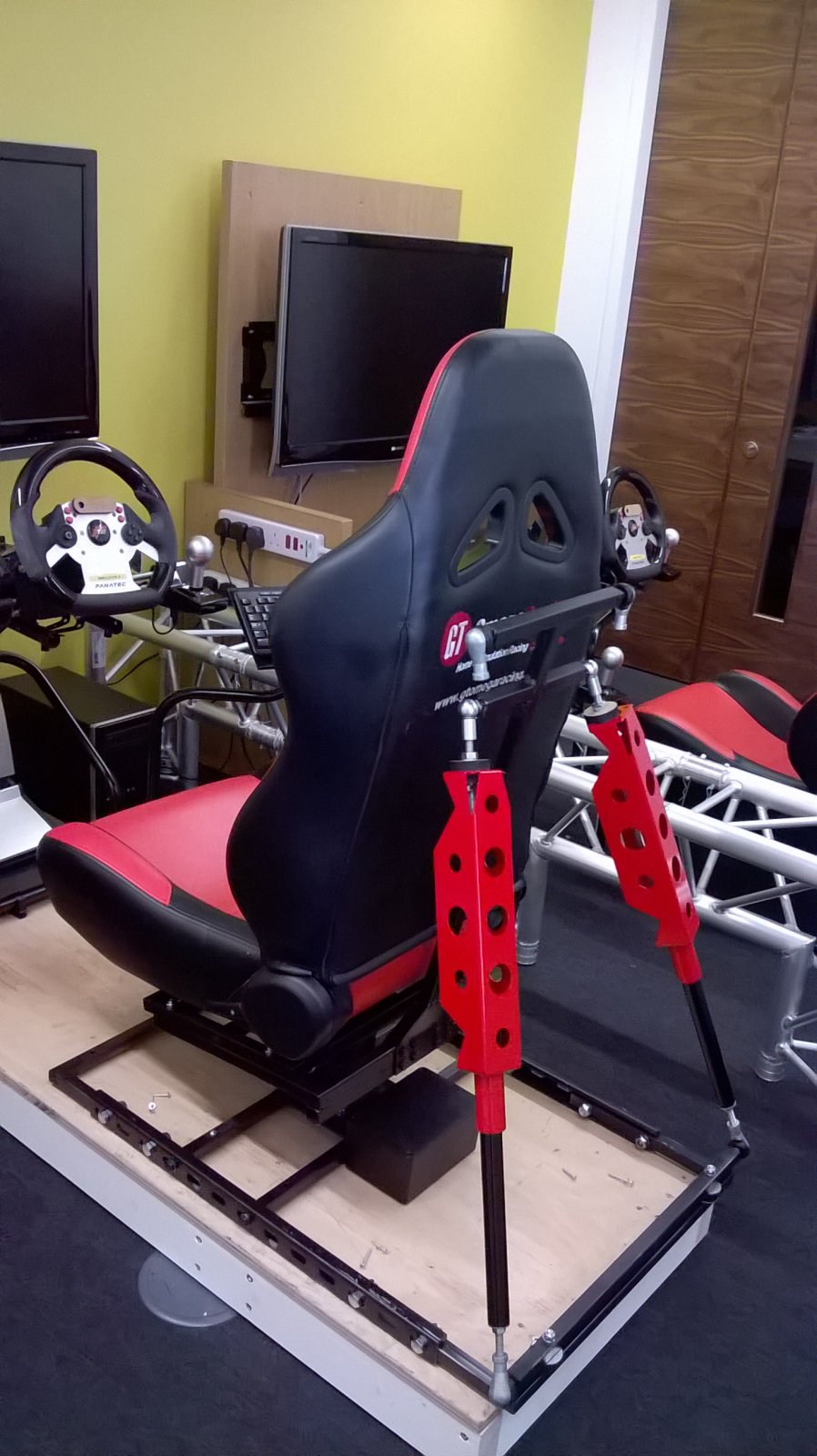

    I am using 2 Dyadic SCN5 actuators with my motion control software, RFactor, Live For Speed and City Car Driving. So far only got motion on Rfactor but only one actuator. Using TTL serial sub adapter.

    Looks nice! Are you running two simulators side by side? Also it looks like you have a second set of ball joints higher up. Is that for switching between two configurations?

    Hi, yes exactly right. This simulator is on a pivot with 2dof, the other is going to be on a spring and have 3dof. The other ball joints are for different motors.

    It's great that you see my rig as being bought complete, but I used Solidworks to design this and got it welded up at work . The universal joint under the chair comes from a Lorry. The rig its self is fully adjustable, please have a closer look. The basic design concept came from SimXperience so I guarantee this is not for sale. The second of my rigs I will use a car front suspension spring for the centre mount to get the heave DOF. I will design Further cad on the first rig to achieve loss of rear traction.

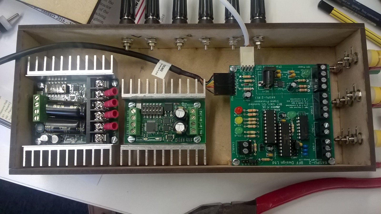

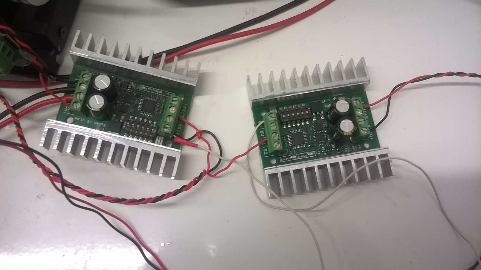

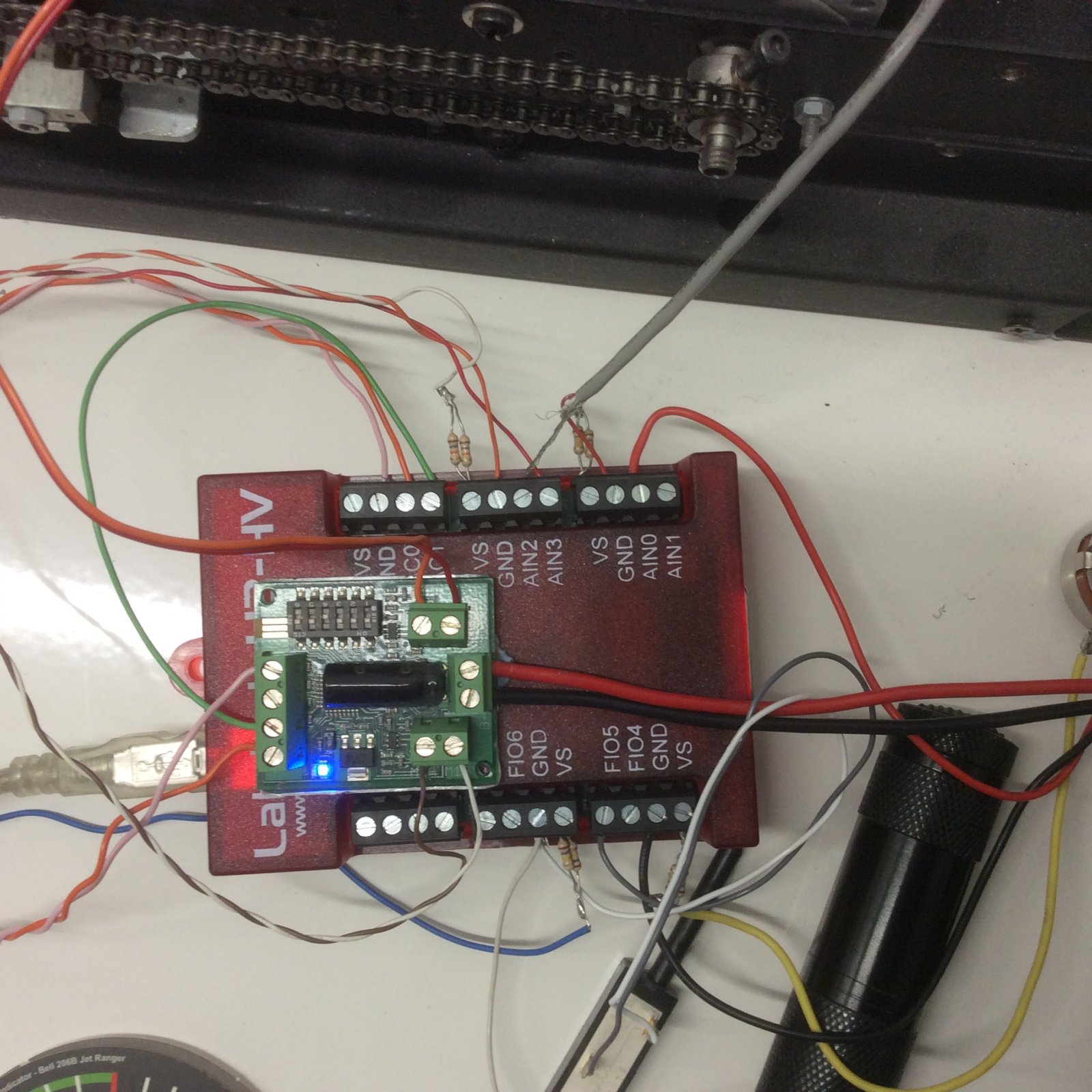

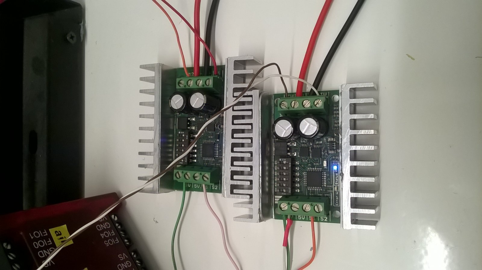

    Hi my apologies, yes indeed the red parts are from SimExperience but the seat frame and mount are home made. Not quite sure yet wether to go with SCN5 actuators or keep going with my original design using a pid controller from bff and 2 sabretooth motor controllers .

    Working my way through several iterations of control, thus so far.
