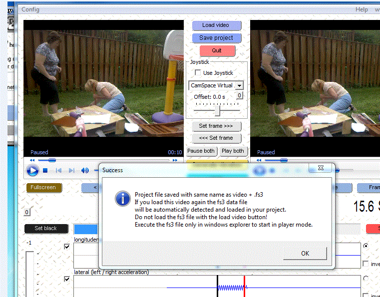

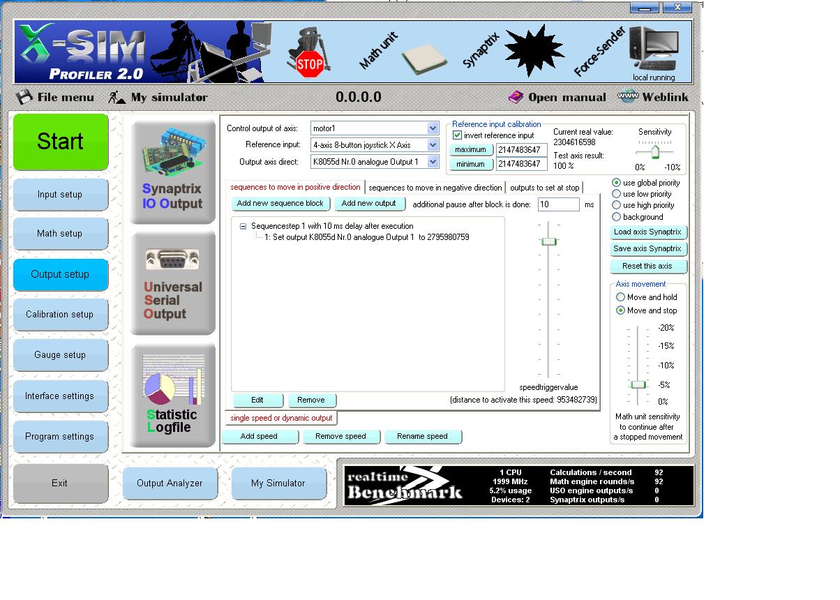

    Thanks Frakk! I've started down the path of using the video plugin. Unfortunately, I have not gotten very far :? .
    Here is what I've done so far:
    1.) Open sender and profiler.
    2.) Open video plugin
    3.) Load video and add effects to frames of video on left and right.
    4.) Save work as .fs3 file in same directory as the video.
    From this point I am not sure what to do.
    I have tried immediately hitting 'try send data' and playing the video.
    I have tried loading the .fs3 into the sender as if it were a .fsd file and hitting 'try send data' and then playing the video.
    One thing that confused me was when I saved my work as .fs3 it says execute from windows explorer. What should be the default application for this?
    I tried using both the sender and profiler and nothing really seemed to happen except the software started.
    See image
    Thanks for any help
    JIM

    Check 'use simulator' and locate the force sender location on the plug in. It will work
  7. JimSim
    JimSim New Member
    Feb 12, 2011
    11
    Data Warehouse ETL Solutions Architect
    1Coins
    Thanks for the help! I finally have success!

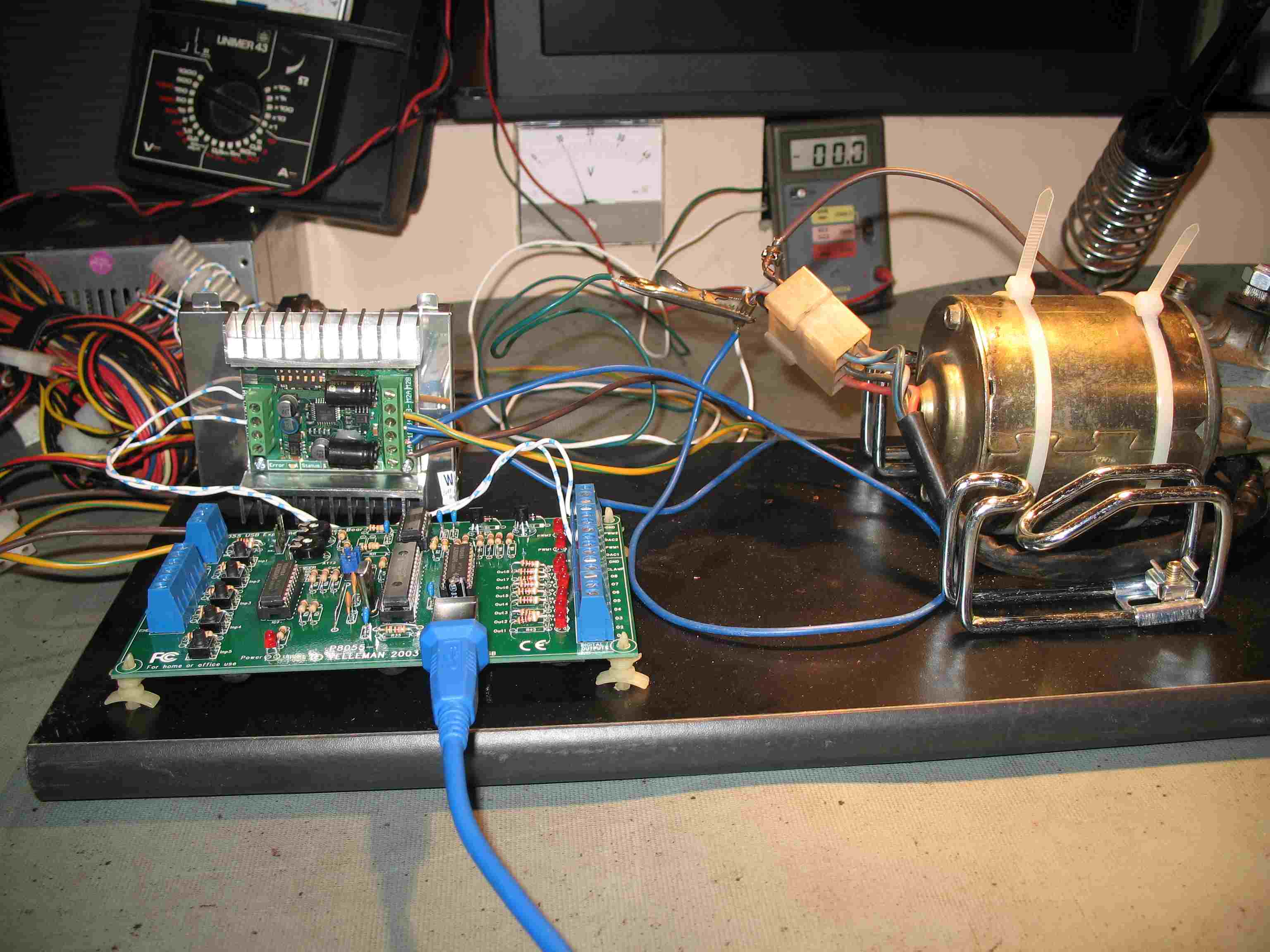

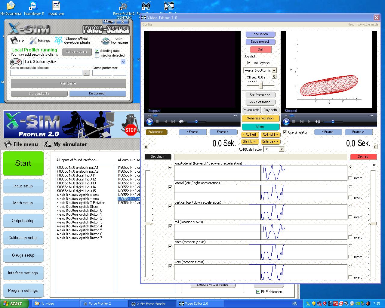

    I also attempts to make a motion video and testing with k8055 and sabertooth 2x12a
    From Xsim profiler 2.1 wiper motor work OK for calibrating or testing a joystick
    all look simple from this manual ....
    http://www.x-simulator.de/beta/video_plugin.html
    my video work OK on both screen and I use a joystick control and simulator check box
    after creating a .fs3 file I double clicking a .fs3 file from explorer , but motor not make any move
    Force Sender is opened all time and I click on Try send data (before I start a .fs3 file)
    Do you have some ideas what is false in configuraton or procedure? :(
    Do I need start also Xsim Forece Profiler and make some configuration inside Profiler?
    Thanks in advance

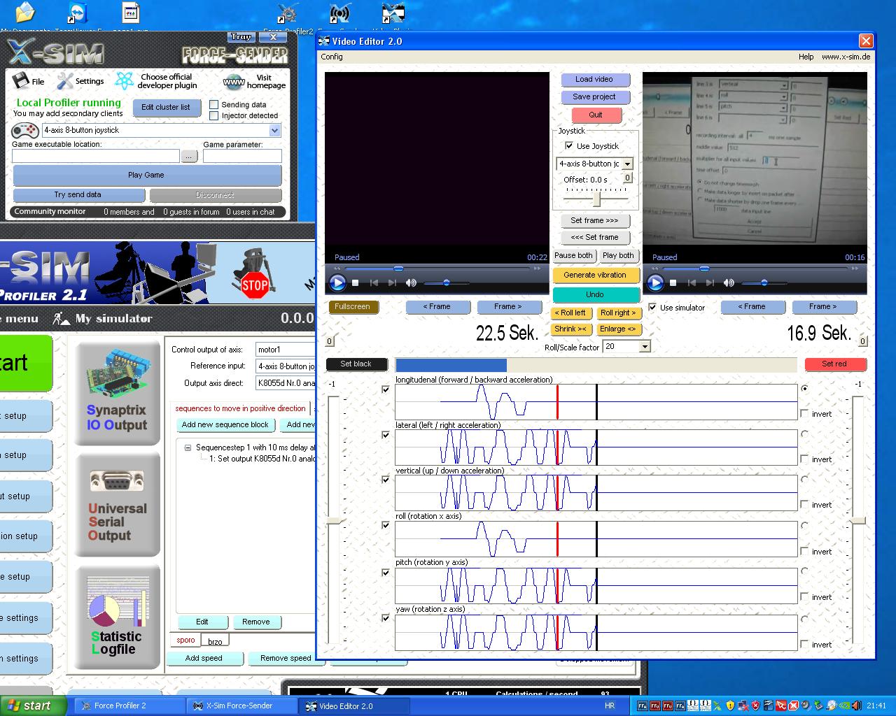

    what you mean Go to the input setup, there must be action in the area 20 to 40.
    Where is that setup? Is that Roll/Scalle factor in Video Editor?
    My screen is in attachment
    Regards
    Igor
  10. igorhr
    igorhr New Member
    Jun 9, 2011
    18
    computer technician
    Zagreb, Croatia
    405Coins

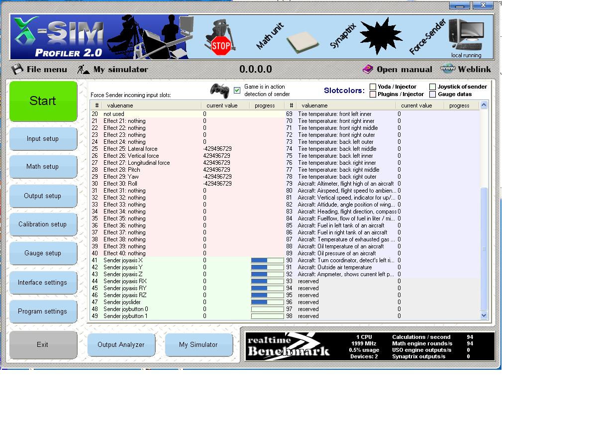

    OK, I was full concentraced on Video Plugin screen... :D ..it was to big button
    Yes, I have action in area 20-40, like you see on screen att., when I start a .fs3 file
    maybe is something missing or is wrong in math or output setup?
    On Calibratio section motor work OK
    Igor

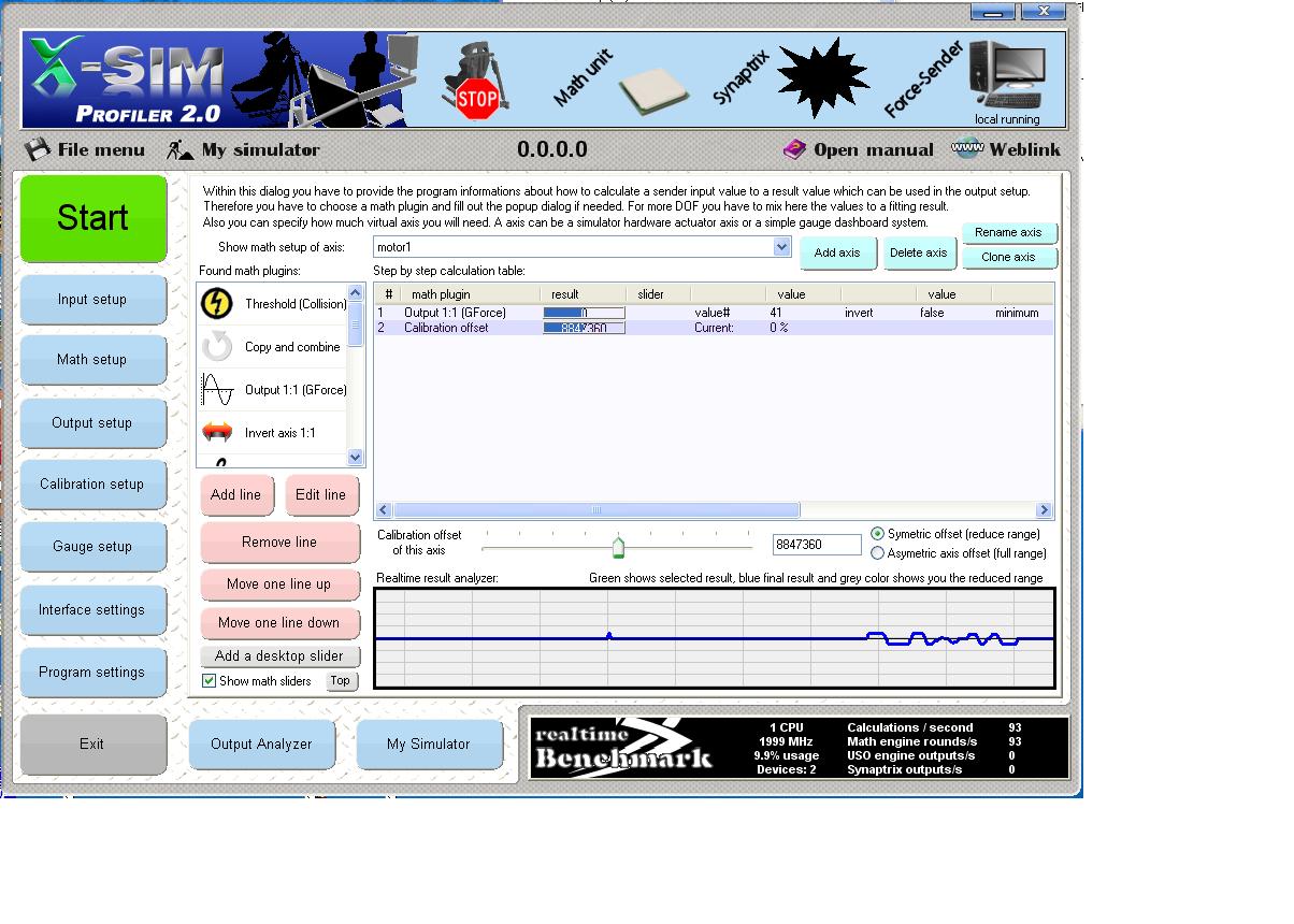

    How I can get blue scale line in the math graph to move from minimum to maximum range?
    can be problem in joystick....
    I was change in Output setings -Sequences to move
    in positive/negative direction slider to 0% / 100%, but the graph is again small
    My HW setup is in showed in .jpg graph
    Is posible that PID bug will fixed in near future in new version of X-Sim ( I am very
    satisfied with X-sim so far) , or I must leave K8055 and go to AMC board with H-bridge?
    Thanks for helping so far...
