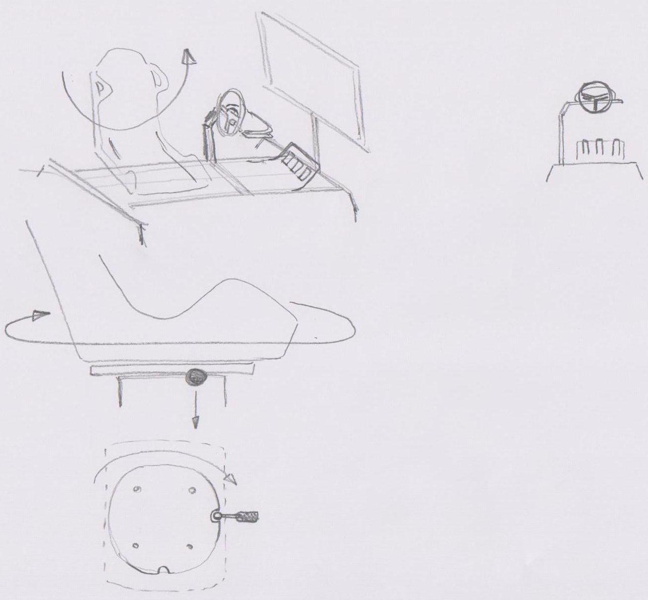

    Hi Orion and Frakk,
    If it is true that with a simulated type joyraider is easier to find the balance, but would complicate the way up to it, I think we should think of some design like Deriy to support the wheel on the right or well supported from the front just above the pedals, leaving the leg room, could get a car seat and make some system to turn to board the simulator ...
    I hope I was clear with the ideas ... Traslator use

  8. fermevc
    fermevc Member
    Jun 16, 2009
    126
    Networking and telecomunication
    Serbia
    5,956Coins
    +60 / 0 / -0
    Exactly what I had in mind :)
    There could be some seat mechanism that would allow the seat to rotate horizontally (90 deg's) and lock into proper racing position when you get in it. And the wheel stand should be on a console, eg. at the left side if you rotate the seat to the right to get in.
    Of course, if you decide to go into motion later whole platform should move including pedals (Deriy style simulator, but I would include the monitor on it).
    I'm sure there someone who could make a quick sketch (I'll do it if I find some time) so others can contribute with ideas.
    BR, Igor

    Yes Igor, your drawing is perfect, that's what I meant as is the seat and steering wheel support :highfive:
    I believe that together we will draw a good design !!!

  13. fermevc
    fermevc Member
    Jun 16, 2009
    126
    Serbia
    5,956Coins
    +60 / 0 / -0
    No, I meant only to tilt the seat so you can get in easy.
    After getting into the seat, you yaw the seat into racing position, and wheel stand don't get in the way for your legs.
    Whole setup can be made movable later, or if you like, motors could be designed from the start (slight modification of my sketches needed).
    And for third axis (yaw), I know it can be done (search for 3DOF posts). IMO 3rd axis is maybe needed for flight sims, but few people have built it for racing (drifting), so ...
