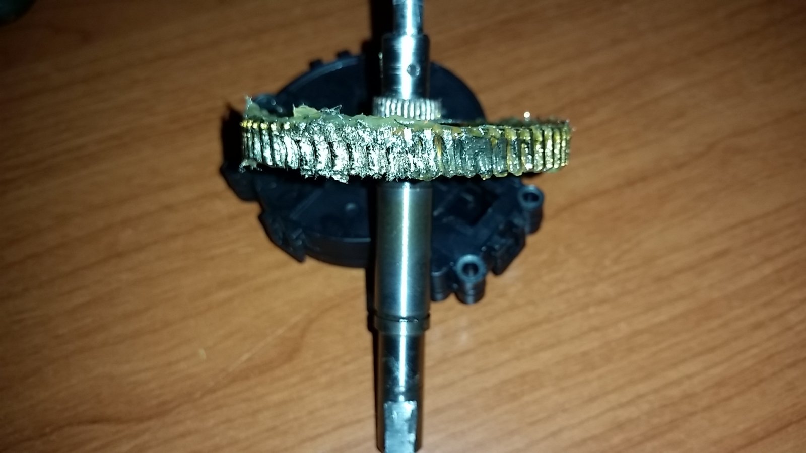

    As for the next video, I think it takes a little time before you post it because I saw that the lever system by 20cm I have adopted is not the best ... because having so many stress is weight to move ruined the 'gear motor ... in conclusion I would like to change this system with gear chain instead of the lever by 20cm.
    This gear is ruined:

    I am guessing that is the momentum of the rig being too much on fast reversals which damaged the gear.

    The real problem that broke the gear is precisely because they are the reversing weight fast is to be moved, the surge with the lever system in my opinion is not the best ... because you have too much stress all the time and having too levers long creating a spring effect that with a pinion and chain I think this should not happen. ;)

    I think part of the issue is the sheer fact he's using Wiper motor's VS the Standard PGsaw/MD gear boxes which have proven to be much stronger in the nylon gear dept.

    Total 30cm , 15 cm for part ;)
    For the moment I settled with the same engine by adding a damper on the lever, by cushioning the blows dealt by the property forward it is back.
    Until now the tests I'm doing seems a good solution :)
    No wiper, but the motors 24V 70 RPM 15NM with metal gears.
    what is left
    The problem was too much weight of the structure with 20cm of leverage, but as I said earlier, seems to be resolved with a damper center.

    This is the result with the damper, as you can see from the video, cushions the blows in both directions.
