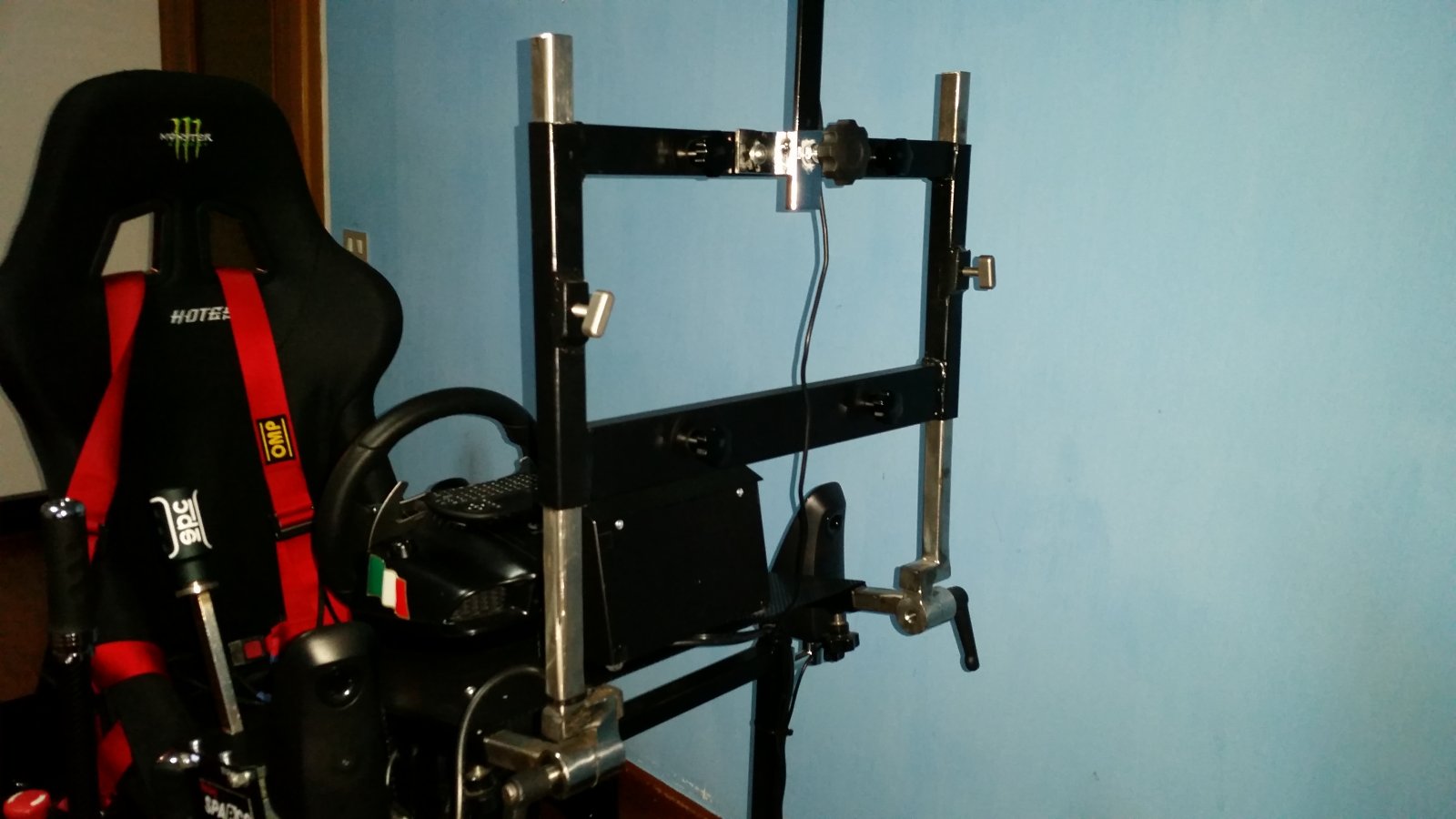

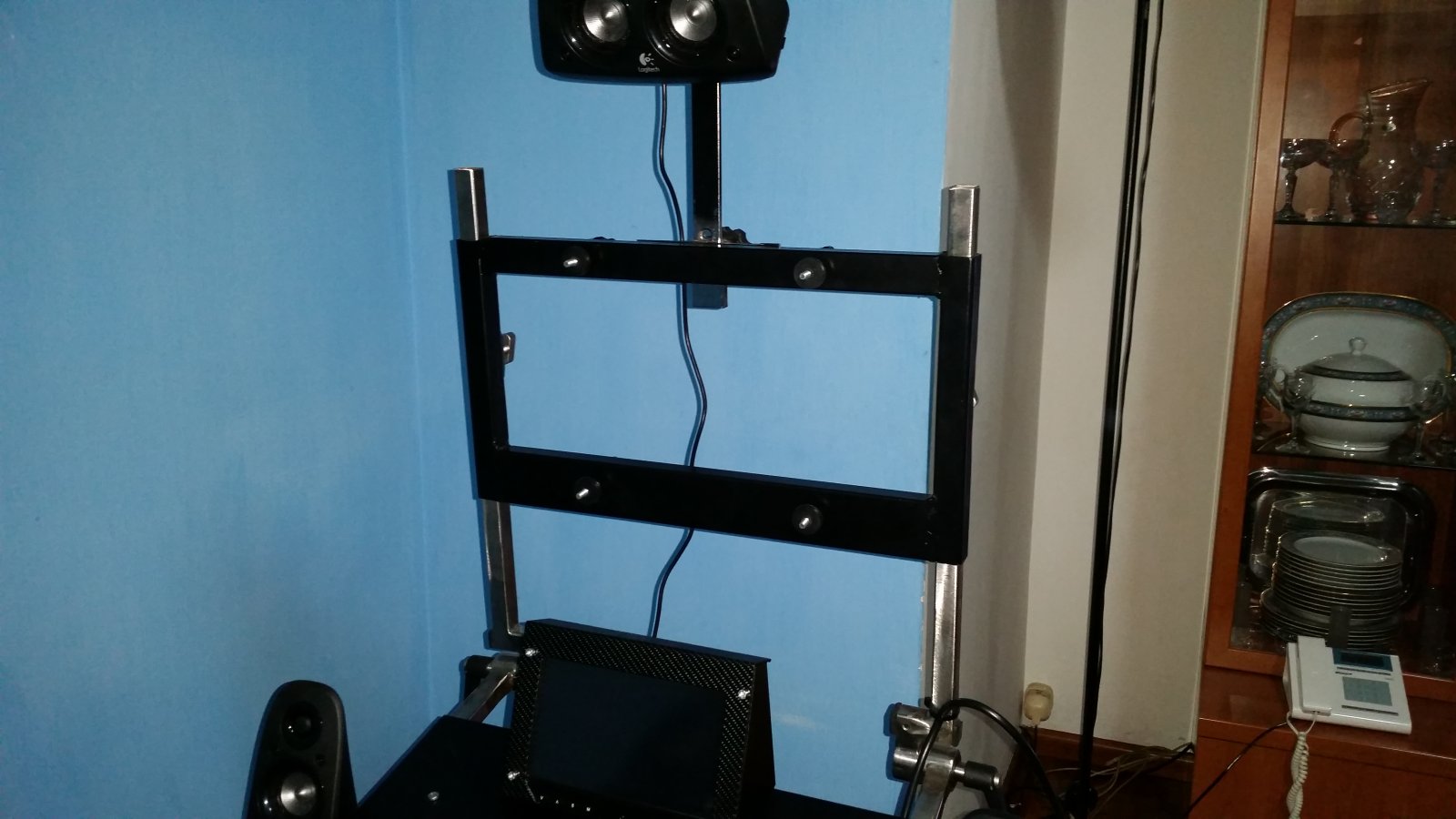

    Hello @ferslash , unfortunately not, I was so focused to build it and finish it as soon as possible ... that I did not think to take pictures during construction. If you have patience, I have to do upgrades to make it 4 DOF, but this I do next summer, I have to insert one engine to lose grip, and 1 motor for acceleration and braking, so this means I have rismontare sim and they can do all the pictures of the property. In the meantime, I put the photo of the TV bracket, then when I have time I do a drawing with the dimensions of the frame and place it on the forum.;)
