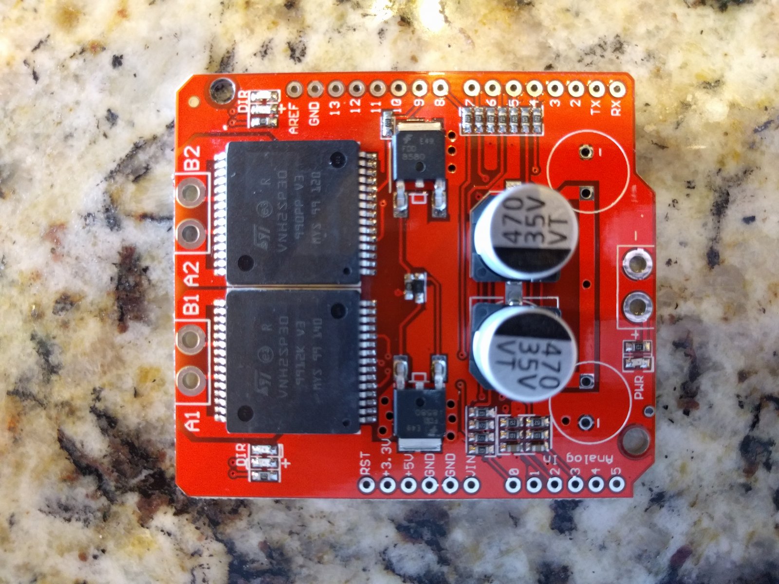

  10. CLEOPHUS
    CLEOPHUS Member
    Apr 12, 2016
    47
    229Coins
    +69 / 0 / -0

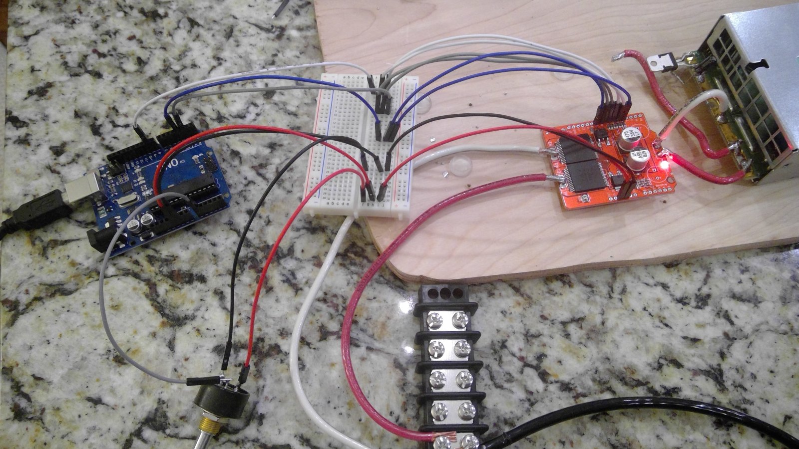

    Hi Guys - looking for some help! I have wired my test setup to my motor and I believe it is wired correctly, but still having some major issues. I guess my issues only are apparent while using SMC3 Utils, but I thought I would check with you guys first just to make sure its wired correctly before I post in that thread.
    Everything shows up in SMC3 Utils, and feedback is recognized from my hall sensor, but as soon as I raise the PWMmax to 5 or 10 (from 0) the chips on the MM's get so hot that I cant touch them - and short out within 30 seconds.
    Motors are 350 Watt. Power supplies are 900 Watt. SMC Ver 0.7 and utils version 1.01
    I planned on using 2 MMs per motor but I got tired of shorting them out so I decided to just try to get one working first.
    Thanks in advance.

    Before I'm going to use the MMs as a single driver I test each channel or output separately. As @noorbeast suggested cooling is a mandatory.

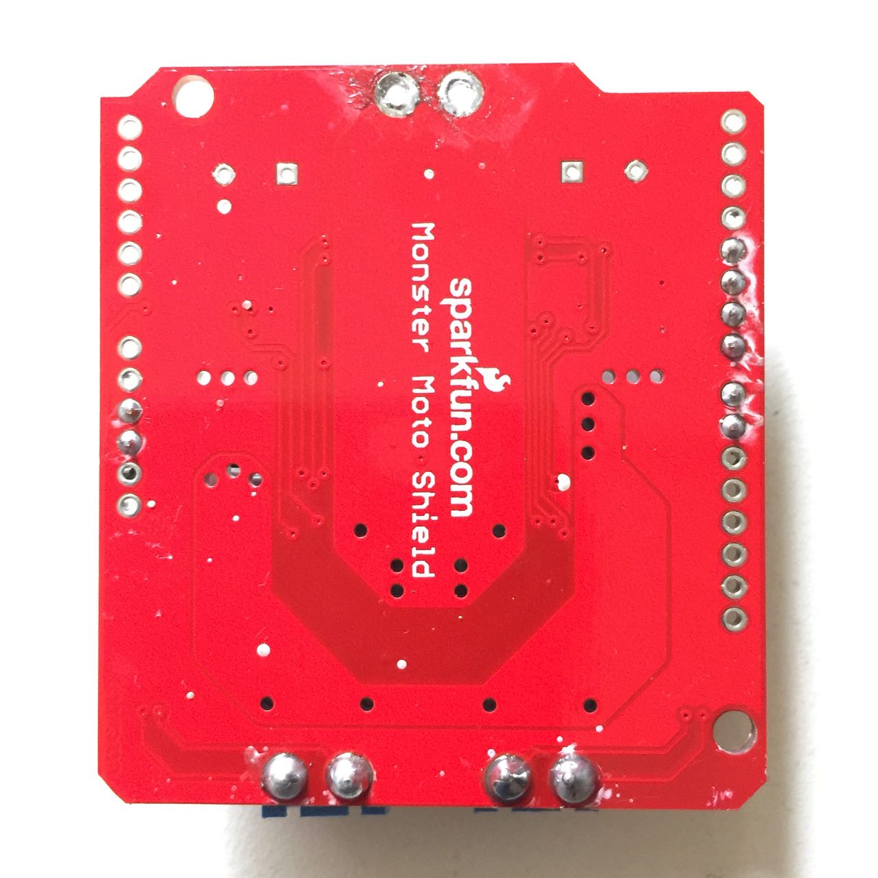

  14. SilentChill
    2,645
    20,592Coins
    +3,567 / 34 / -0
    There are some dreadful vnh2sp30 chips on these Chinese clones lately. I cannot use any of them, they burn out within minutes of use. Lots and lots of smoke and sometimes fire lol :D
    I need to take pictures of what I have bought but all in the last 5 months have been pure garbage. They have different logos on the PCB I think 1 was QUFIE. I will start a new thread on it when I get back of holidays.
    I have 8 original MM's I bought over a year ago that still work perfectly but these new ones are S H I T.

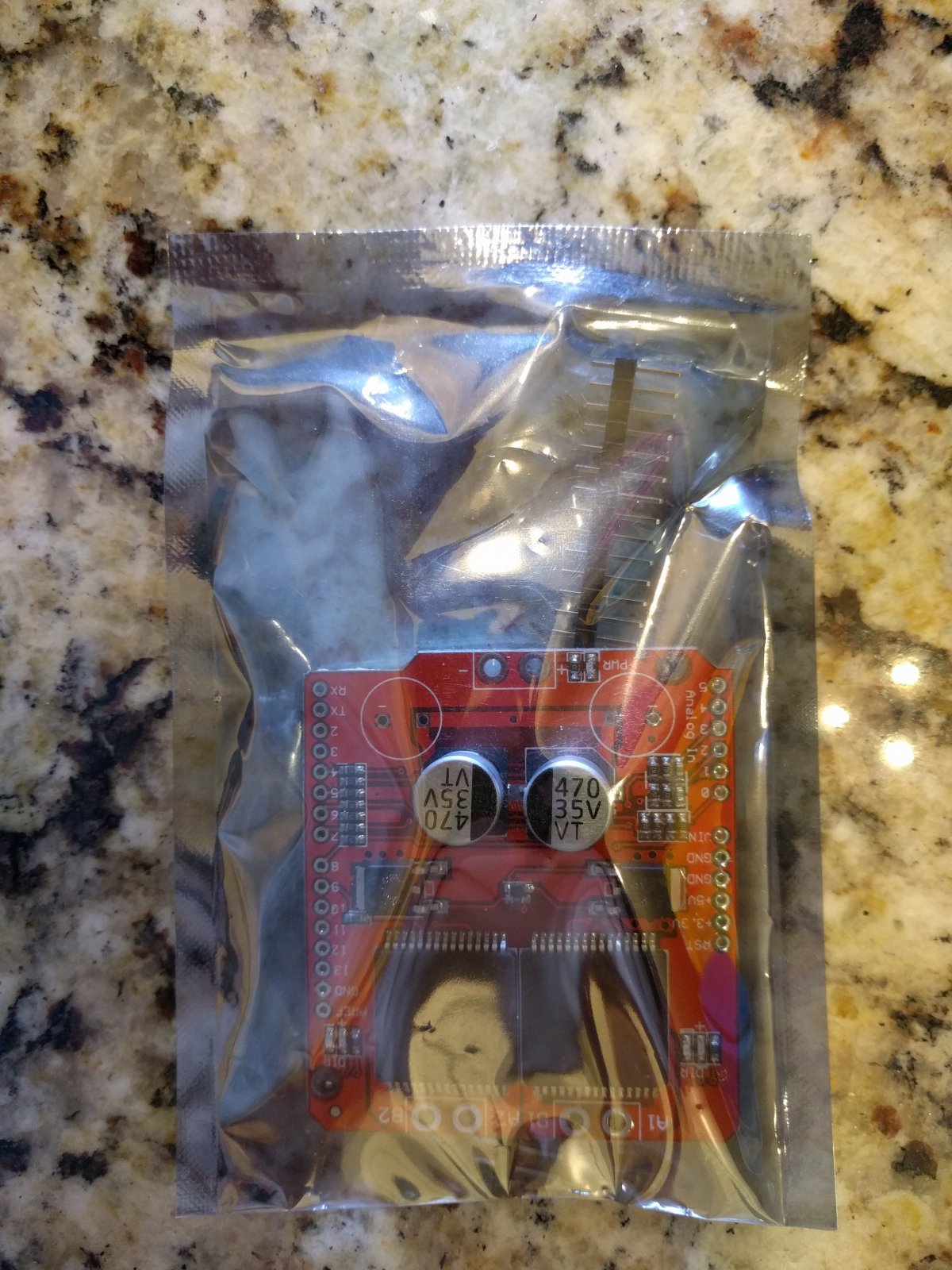

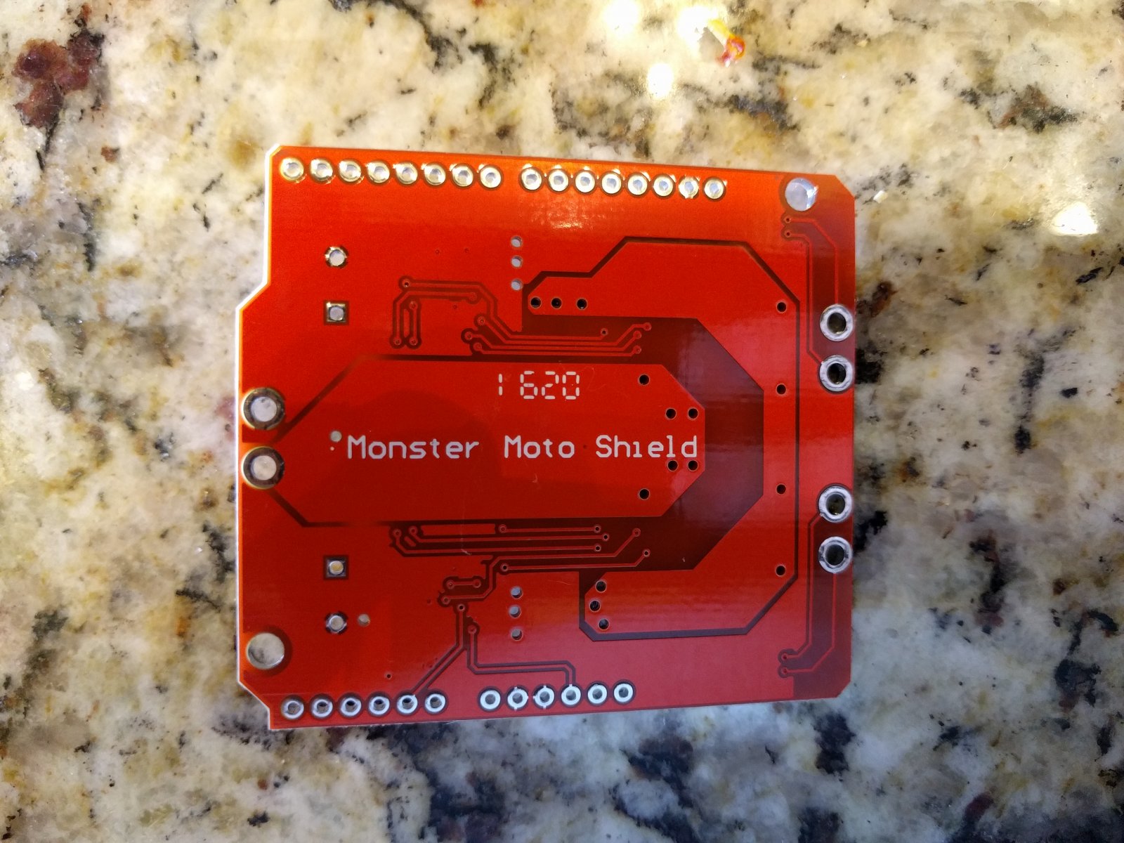

  15. CLEOPHUS
    CLEOPHUS Member
    Apr 12, 2016
    47
    229Coins
    +69 / 0 / -0
    I have had similar things happen to me. Seems like the chips catch fire really easily.
    Here are some quick pictures of the boards. I purchased them from this seller on ebay: http://www.ebay.com/itm/191674295987?_trksid=p2060353.m2749.l2649&ssPageName=STRK:MEBIDX:IT
  16. SilentChill
    2,645
    20,592Coins
    +3,567 / 34 / -0
    @CLEOPHUS yes I'm sure I have those with 1620 printed on. They get really hot really quick as soon as any amps are put through them. They work perfectly with my little 12v RC motor for testing but with the big boy motors they fry.
    No cooling will help they are just bad bad bad

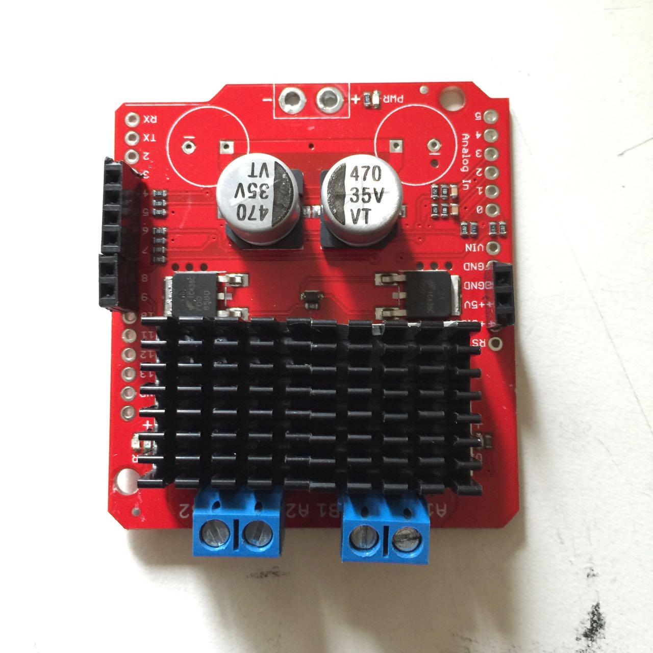

  18. CLEOPHUS
    CLEOPHUS Member
    Apr 12, 2016
    47
    229Coins
    +69 / 0 / -0
    I didn't measure the amperage - but it was very little. My guess is 2-5 amps because the motors just started to turn at a very slow speed with no load. I keep an extinguisher next to me now.
    I just installed northbridge coolers purchased here: http://www.ebay.com/itm/271953403238?_trksid=p2057872.m2749.l2649&ssPageName=STRK:MEBIDX:IT
    I haven't tested yet - but hoping for the best.
