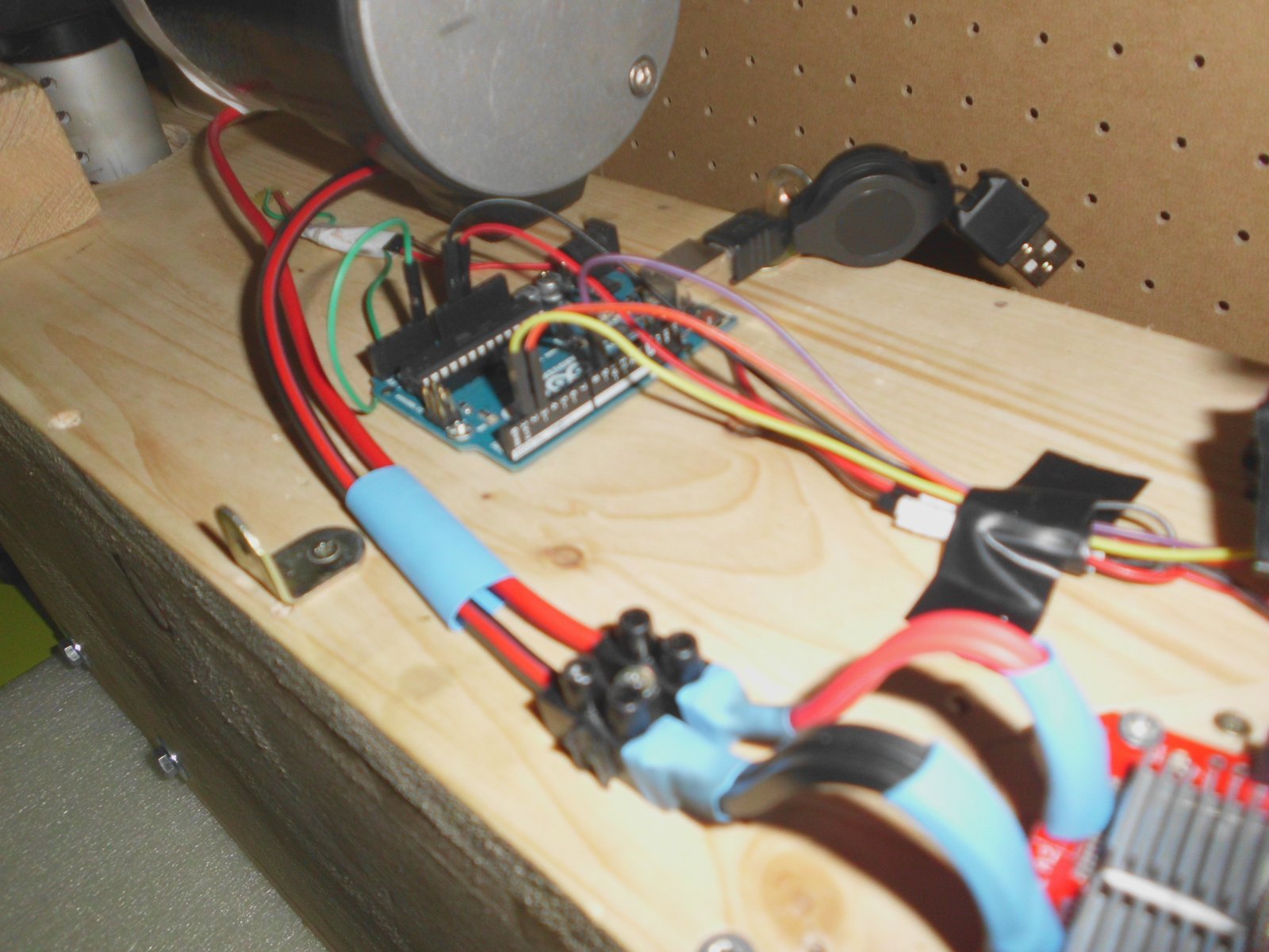

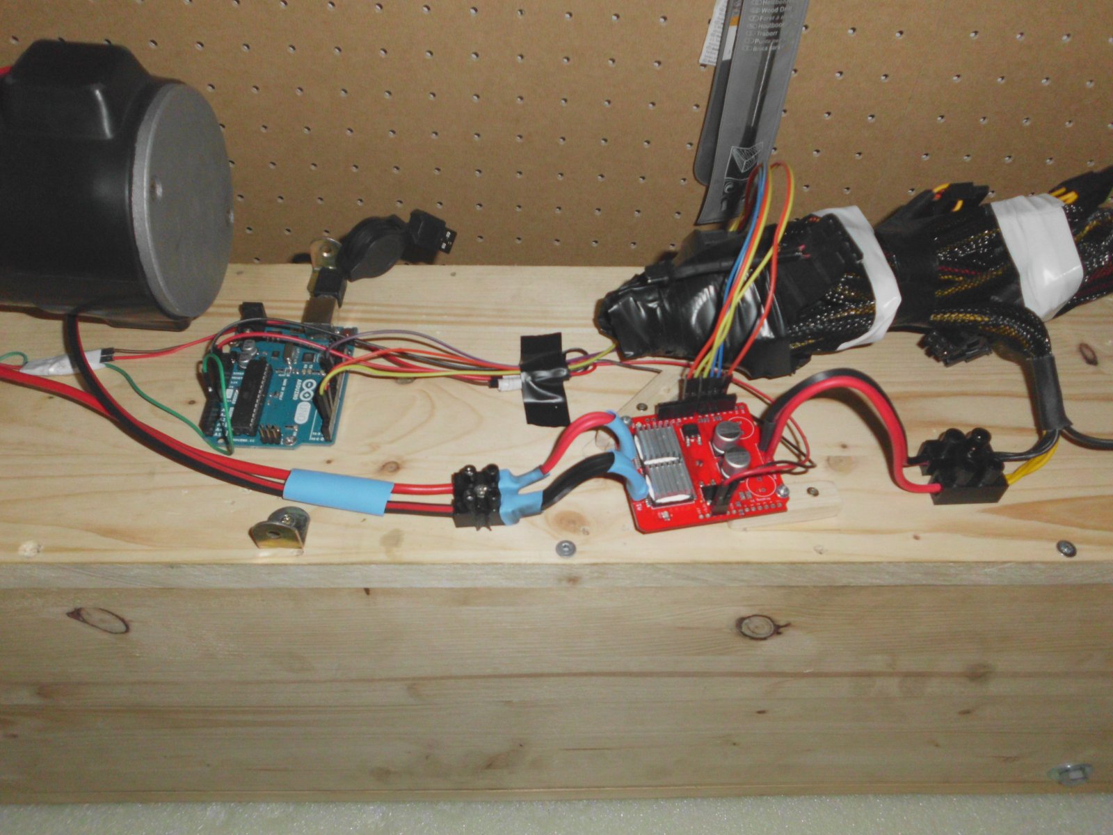

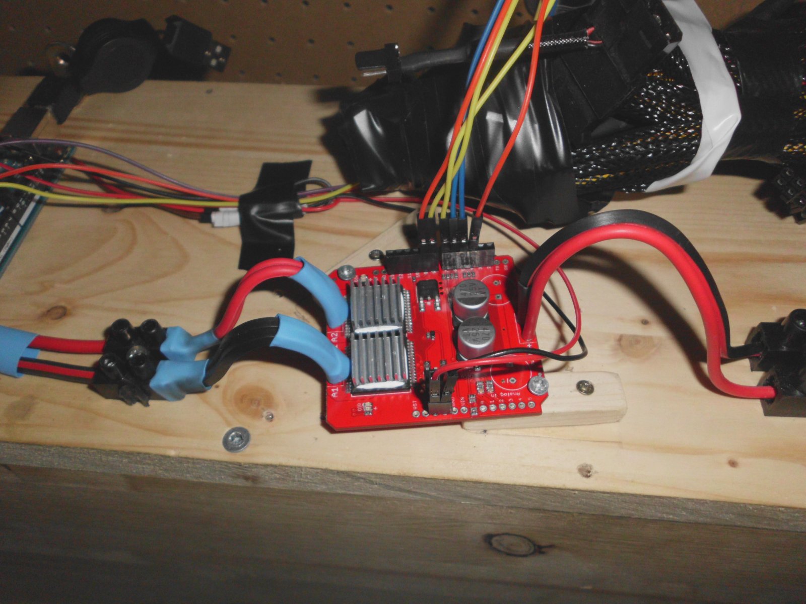

    Woaah got it working.
    Voltmeter test sucessfull on my last mm with the RC battery.
    Then connections with PSU and big motor worked fine.
    Using same config that with the 5019, seems to return and brake better with mm. more power out of the box. Now time to raise Kp and PWMmax(120)
    Thanks Guys!! and specially @Pit for sharing and trying it.
    PS: my wiring ( hope to be clear to see )
  3. Pit
    3,012
    30,490Coins
    +3,100 / 31 / -0
    Glad that it works for you, nice :)
    PWMmax 120 is very low, but for testing with OK. As I can see in your photos your coolers are very small, so take care and use big and fast fans!

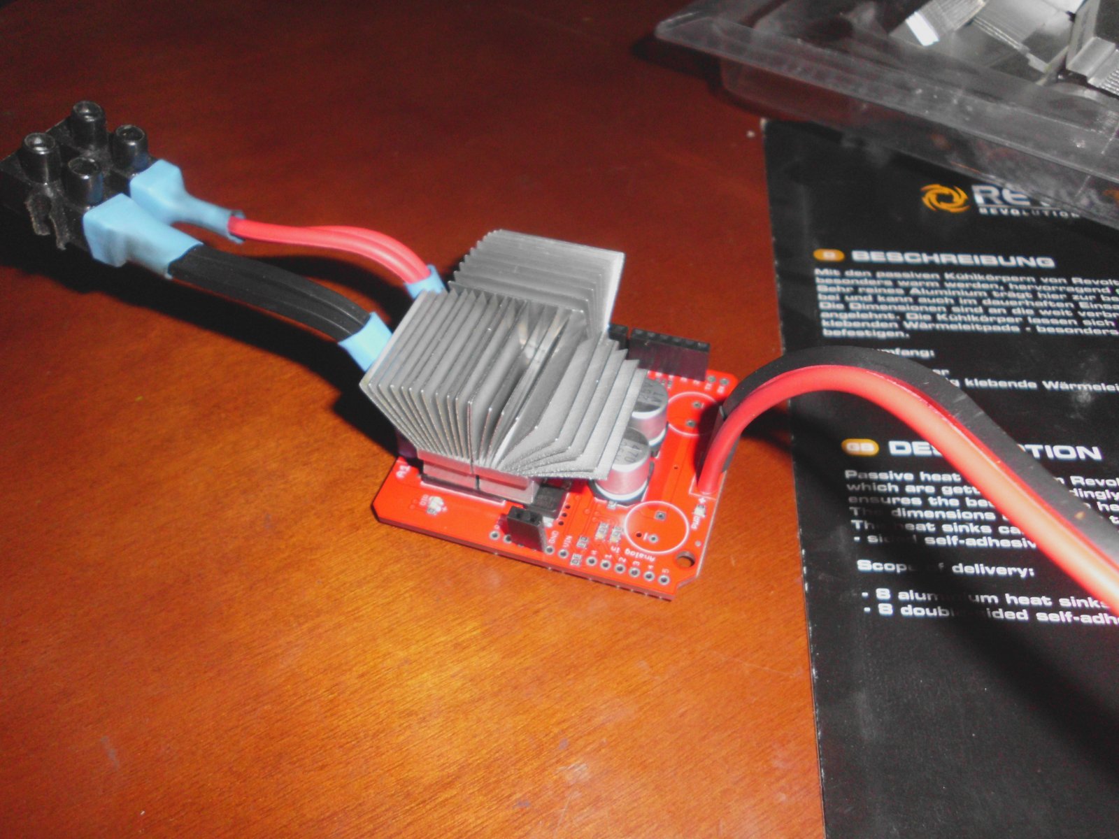

    Got these ones!!
    http://www.ct-systemen.nl/product_i...cts_id=3175&osCsid=60uddodknsjm11es75hqkvpr74
    After seeing yours, i went away to check all stores near me, found that in the last one, the one closest home :S 4.5 €, 8 units
    You can open them as you want, they are moddable. I think this is the best heatsink i've seen here, I will show you. Its like a passive CPU cooler on the mm. Installed 3 units, opened them, and took a nice photo. You are going to love it.
    My syster took the camera away before I could download the photos haha
    Like it??
