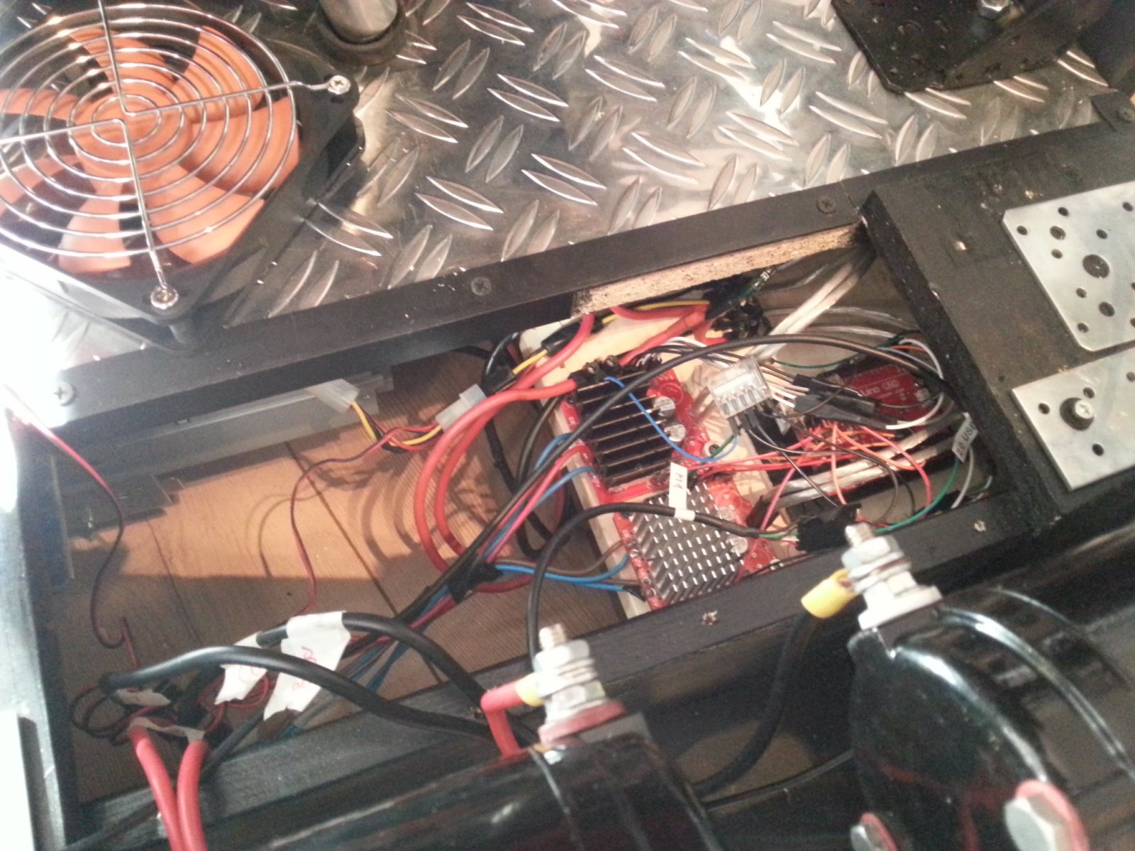

    Hi @Pit I have also used the MM as a single driver but I can't get them to work as you have in your final diagram with one side driving negative and one positive it was just shorting out all the time. I have had to wire both up as you had in your original diagram where each side has a negative and positive output.
    I am pushing easily 40 amps without it cutting out and my psu's are only 43amps anyways so all is good.
    Before it was cutting out all the time was really annoying. I will post some pics and a video hopefully as soon as I get my traction loss addition completed.
  15. Pit
    3,007
    30,512Coins
    +3,098 / 31 / -0
    This is very dangerous. It works for the moment but a short circuit is more than likely. Please make s photo of the wirings so i can help you to guide through it.
    Good luck, but don't forget you will run into an issue if you will stay where each side has a negative and positive output.
    PS: I have successfully wired 3 MM!

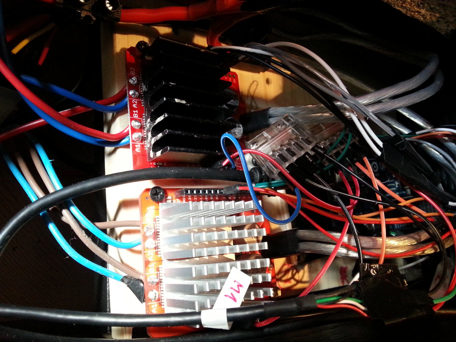

  18. Pit
    3,007
    30,512Coins
    +3,098 / 31 / -0
    This one? Sorry for the spaghetti syndrome :p I would do it better, but so long it works - never touch a running system :). The color wiring is NOT like it should be, the wiring was soldered BEFORE I switched to single mode.
