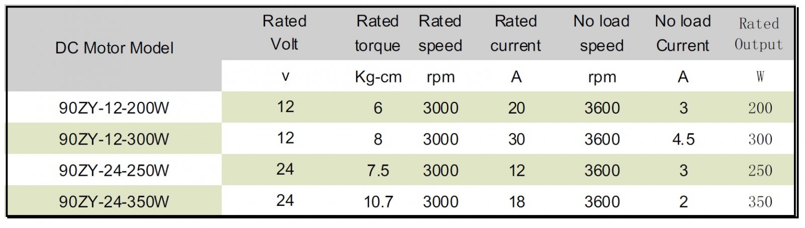

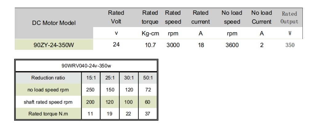

    Thank you Noobeste!
    I'm thinking of buying this gearmotor.
    90ZY-24-350W 10.7 3000 18 3600 2 350
    My Platform is a little heavy.
    So I believe that this Gearmotor would be enough.
    Could you tell me which Gearmotor you are using on your Platform???
    I need detailed information.
    Thanks for all possible help.

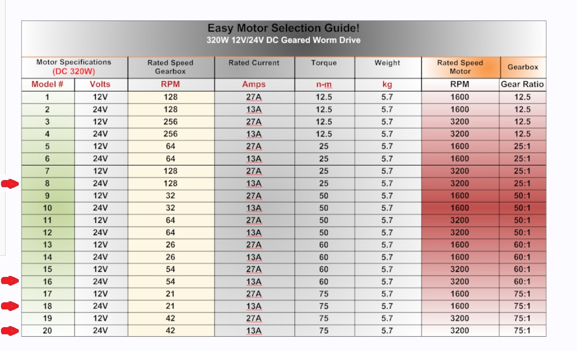

    I am in Australia and we have easy access to DC motors via Motion Dynamics:
    Mine is a compact rig so needs lots of torque, I use specs very close to Model # 15:

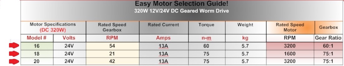

  4. Joqueson
    Joqueson New Member
    May 5, 2020
    19
    66Coins
    Thanks Noobest, for this table.
    I can get any of these Gearmotors Importing to my country Brazil.
    I still have doubts which gearmotor I should buy.
    Please I need you to help me make the right decision.
    As I told you.
    Mine will be a Compact device, so I believe I will need a lot of torque, just like your Simulator.
    I'm in doubt between (8, 16, 18 or 20)
    I am sending you a Photograph of your Table with a red arrow, indicating what I intend to buy from these Gearmotors.
    Which do you think would be the best?
    (8, 16, 18 or 20)
    Or can you tell me another number from this table?
    Thank you very much Noobest for your help.
    22,185
    154,732Coins
    +11,194 / 57 / -2
    As per previous advice you can use SimCalc to help evaluate your design and required motor choice: https://www.xsimulator.net/communit...-sg90-simulator-3dof.17201/page-2#post-230593
    If using 24v make sure you select a suitable control board.
    From those you have selected without knowing the actual design parameters I can only guess, and that is likely 16, unless the top frame mass is heavy, in which case you may need to consider 20.
    Importing heavy gear motors is pretty expensive, so be mindful of considering all costs before committing.

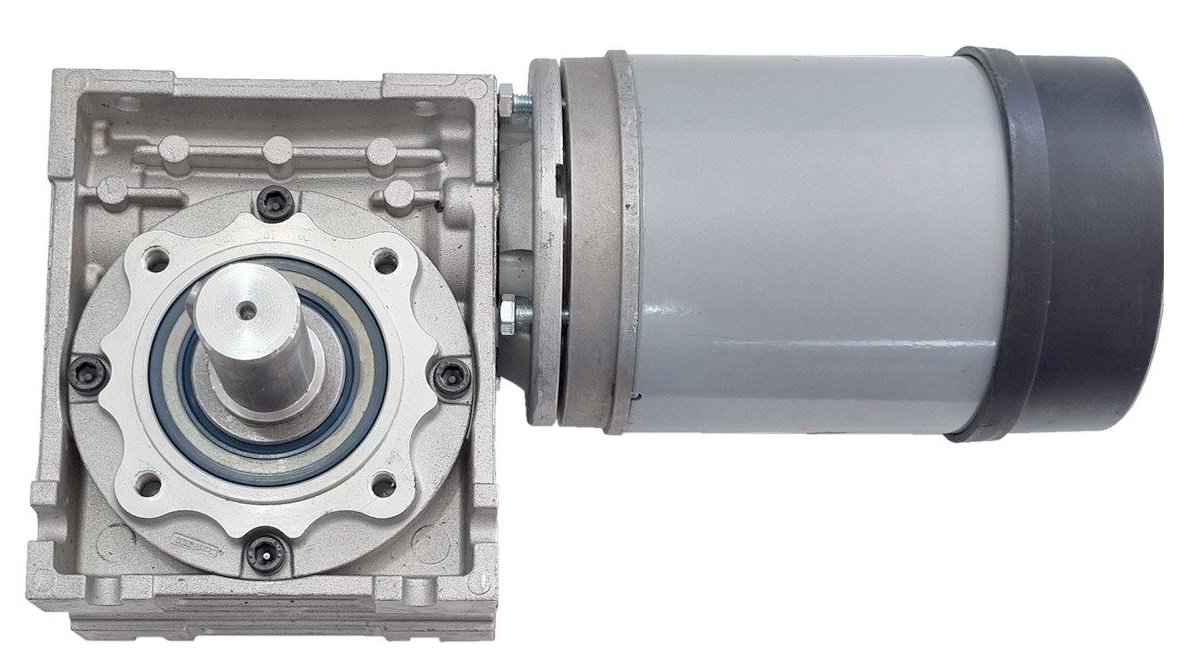

    Hi Noobest.
    I'm looking for the best 24volt gearmotor with the highest Torque and Output
    Speed possible in my country Brazil.
    I found this model of 24volt, 250Watts and 12 Amper Reducer Motor.
    It has all these features and settings
    Please I need you to check the settings of this 24volt, 250Watt and 12 Amper gearmotor.
    I hope that this Gearmotor is close to the settings of your Gearmotor, referring to your Table, which you sent me.
    I am sending you an Image of the Reducer Motor of 24 volts, 250 Watts and 12 Amper
    Here is all the descriptions and configurations of this 24volt, 250Watt and 12 Amper Geared Motor.
    1 - Motor Input Speed in RPM.
    (3,300 RPM)
    2 - Gearbox Output Speed.
    (40 RMP)
    3 - Thickness of the Gearbox Shaft.
    (Diameter 18 mm)
    4 - Gearbox Output Torque.
    For Output speed at 40 RPM the Torque is equal to (30 Nm)
    5 - Motor Voltage:
    (24V voltage)
    6 - Engine Power in Watts.
    (250W)
    7 - Motor Amperage.
    (12A)
    This Gearmotor, I found here on my own more Pais Brasil, the price is very good.
    I'm asking you for help.
    I need you to confirm if these Gearmotor settings are good for me to deploy on my 3DOF Platform.
    Thank you very much for all your help and compression.
    22,185
    154,732Coins
    +11,194 / 57 / -2
    I have no experience with that particular motor, nor am I sure what specific design parameters you intend using, hence the previous advice to use SimCalc to model your design and check motor requirements.

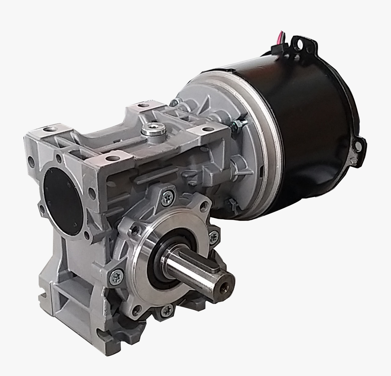

    93350
    Hi Noobest.
    I found this other Gearmotor here in Brazil.
    I am sending you a Photo of the Gearmotor.
    According to the Seller, this Gearmotor has all these characteristics and configurations.
    I am sending you this information to know from you if this Gearmotor is close to the characteristics of your Gearmotor.
    (2800 RPM)
    (46 RPM)
    (25mm)
    (100 Nm) According to the Seller.
    5 - Motor Voltage
    (24volts)
    6 - Motor Power in Watts:
    (500 Watts).
    7 - Motor Amperage.
    (25 A)
    8 - Reduction Box:
    (60:1)
    Thank you for your kindness and understanding.
    I need to be sure from you, if this Gearmotor is really great for my Project.
    Thank you very much.
