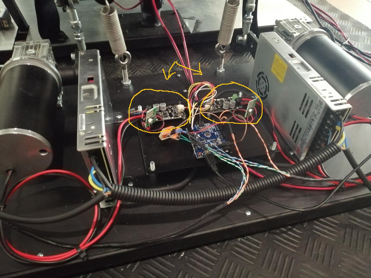

    2DOF, DC motor, SimforceGT
    Hello people of the forum, I wanted to ask if anyone knows what function these plates perform, they are the same as the 2dof box from the company DOF REALITY

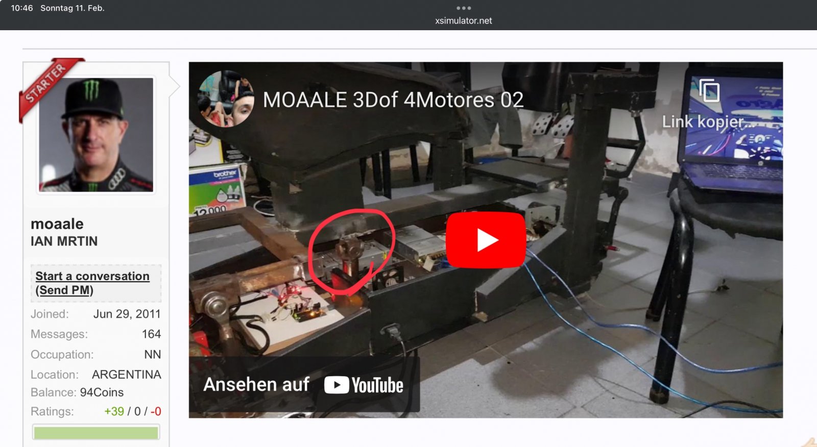

  11. Michail
    Michail Member Gold Contributor
    Jan 5, 2022
    165
    731Coins
    +28 / 1 / -0
    Please, can you explain how to manage to fix the unjoint and make it up down movable? Found your videos on YouTube and I am happy to find you here as well.
    thank you in advance.
  12. moaale
    moaale IAN MRTIN
    Jun 29, 2011
    170
    NN
    ARGENTINA
    126Coins
    +41 / 0 / -0
    Hello friend, nice to meet you... in the part you show me, I welded a tube of the same diameter to the gimbal and at the moment when the four motors or two motors go up, the gimbal is inserted into another larger tube. They have to be well adjusted so that there is no play and they function as shock absorbers.
