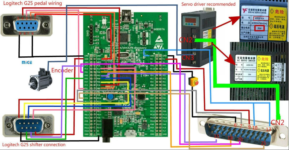

    Hi folks
    I have tried to connect my G29 shifter to the STM32 but it seems not work.
    Maybe the wiring is wrong or there is a bigger difference between these shifter:
    G29: G29-shifter.jpg G27 / G25: G27-shifter.jpg
    I have used the standard wiring:
    Does someone know how to connect a G29 to the STM32?

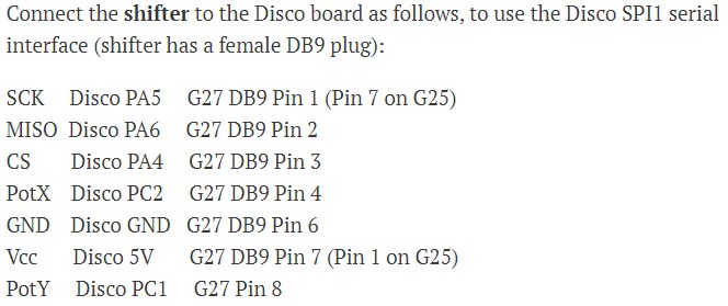

    Hi
    i found one thing that could be a problem.
    There is a difference between G25 and G27
    Pin 1 and Pin 7 are changed:
    But which one will work with the G29 shifter?

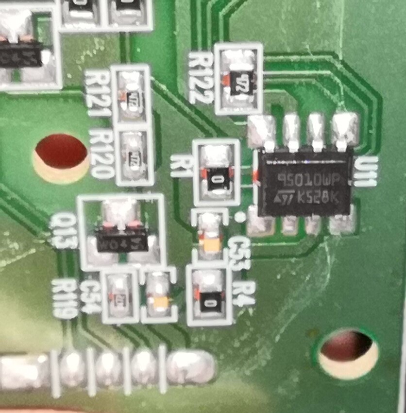

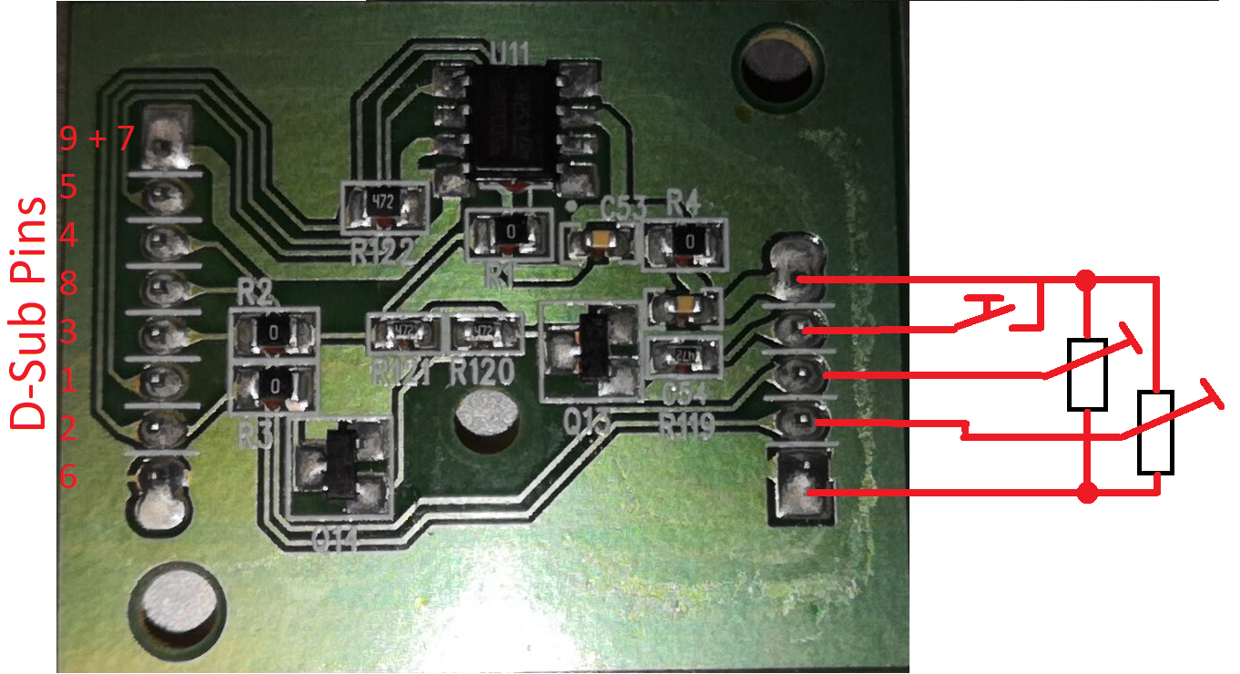

    Cause there is no Pinout of the G29 in the Internet i made it by myself ;)
    The G29 seems to work completely another way.
    It looks like, it is working not like I2C, it is working analog an has an EEProm inside.
    Its a "M95010-W 1 Kbit SPI bus EEPROM with high-speed clock"
    https://www.st.com/en/memories/m95010-w.html
    For whatever reason...:think
    But i made a small connection diagram:
    As you can see, at pin 4 and 8 are the analog outputs.
    Pin 2 seems to be the "revers"-switch.
    Maybe someone has a good idea?

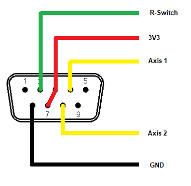

    Hi folks
    Only a short update from me.
    I have connected the G29-shifter to a Arduino Micro at the moment.
    The connection is like this: (shown is the male mating connector)
    There is a free joystick library which i used.
    Only when 6th gear is set and the switch is active (active means high at the pin) the R-Gear is active.
    If you press the shifter to activate the switch in any other gear, nothing happens.
    Hopefully it will be also work soon with VNM Wheelbase.
    @Hoantv : What do you think? Will you put it in your Software?
    Kind regards
    Peer
  8. noSaint
    noSaint New Member Gold Contributor
    Jan 9, 2021
    23
    160Coins
    +13 / 0 / -0
    I guess it is different resistance for each gear.
    Hope this link can help you:
