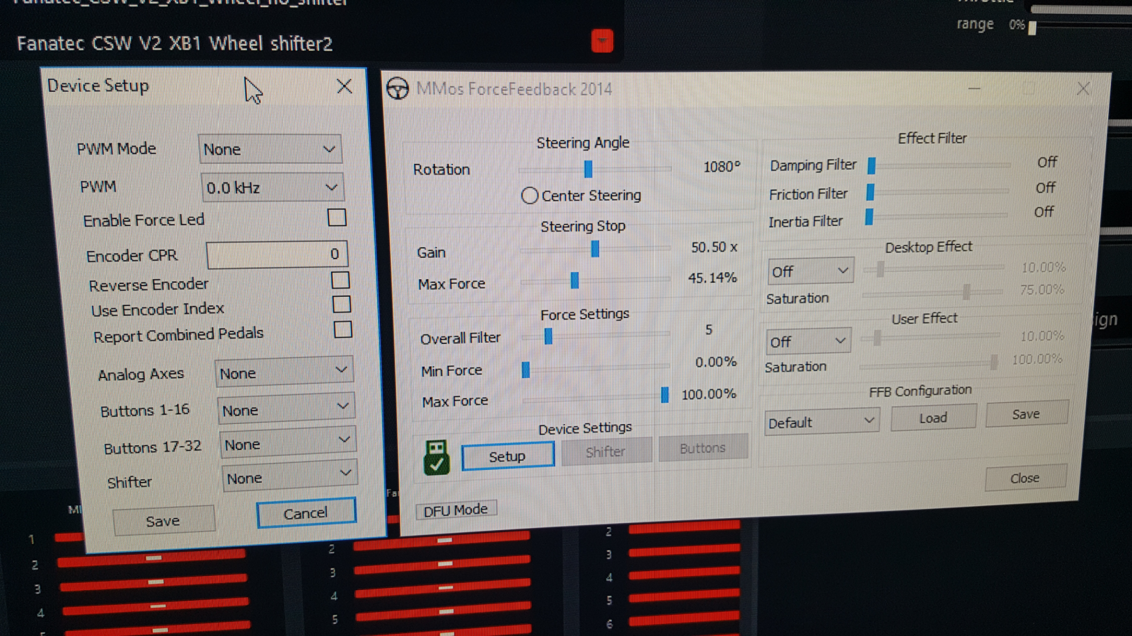

    Hi guys :)
    As most of you are, I am pretty satisfied with my OSW.
    But I do find one thing pretty annoying
    Is there a solution so you dont have to calibrate the steering wheel in MMOS everytime you start up the computer?
    Furthermore I need to set my OSW ingame everytime so the game knows that it is my OSW I will use as a steering wheel?

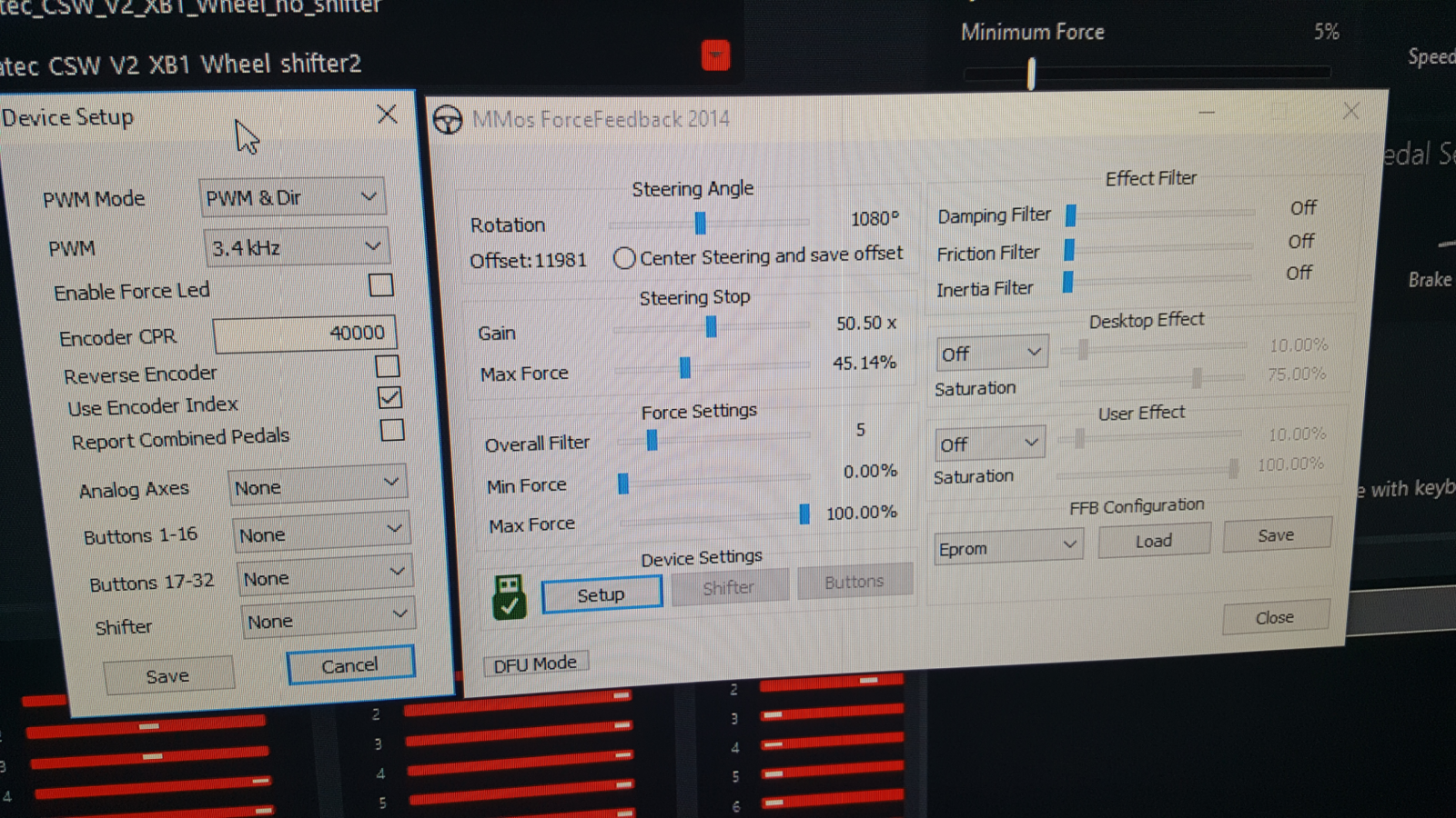

    I have attached two pics at my mmos.
    Everytime it recognizes the settings as steering angle, min and max force etc. So they are saved.
    But everytime time I start mmos all the settings in setup are cleared? Even though I have saved them to eprom and default.
    Asume they are correct in setup tab?
    As you can see it says "center steering wheel and save offset"?
    But how?
    If I save it to Eprom, default or at the gameprofile it still says "center steering wheel and save offset"?
    WHAT THE HELL AM I DOING WRONG? :)

    once you have set the centre with the offset it will remember this. when i turn mine on it rotates slightly and is always off centre but the setting still remember where centre is if that makes sense.
    you should only have to centre once and save to eprom. after that you never to to save to eprom again.
    ill try and find my instructions for you. When centreing the wheel you dont actually have the wheel on the shaft so you can stay with in a limit which i think is under 3000 on the offset

    Yes. First off I didnt save to eprom in MMOS.
    That worked so the OSW was saved as the steering wheel inside the games, but wasnt calibrated correst everytime.
    But when I calibrated the value was around 12000 in MMOS.
    The value has to be between -3000 to 3000.
    So refitter my QR so it is now around 600 when the wheel is centered.
    Saved the value.
    And now it works perfect everytime :)
