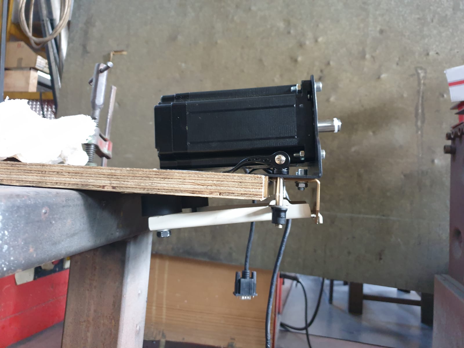

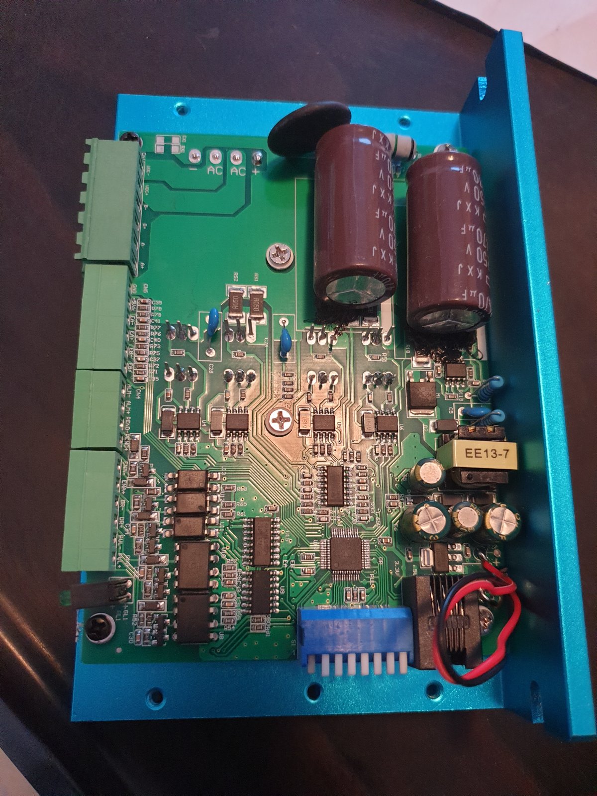

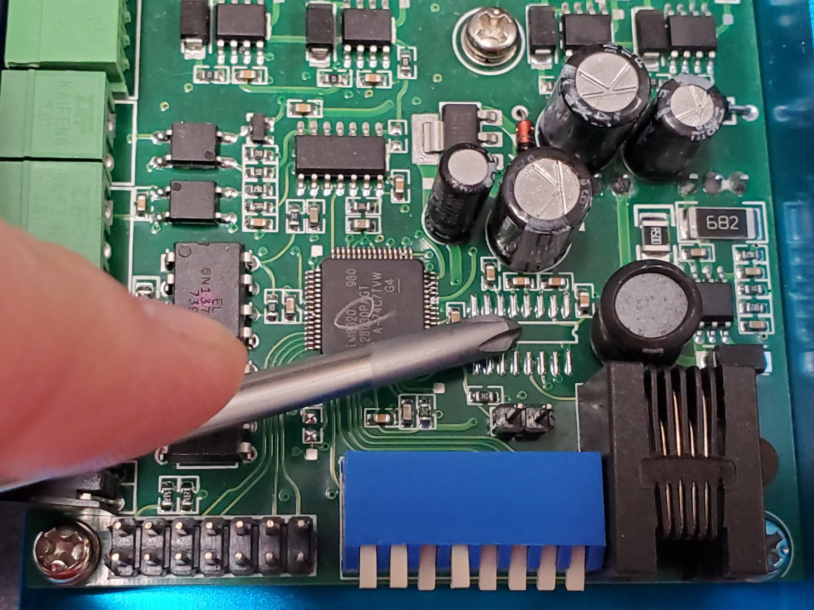

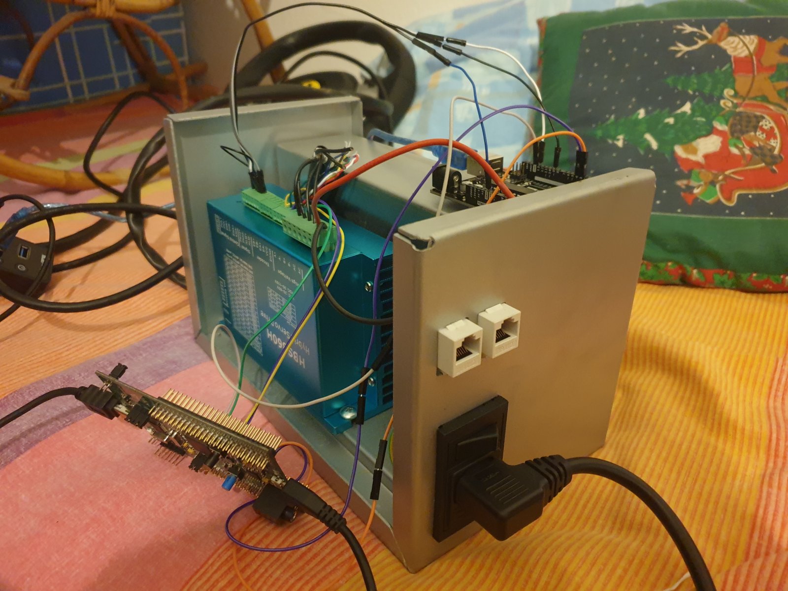

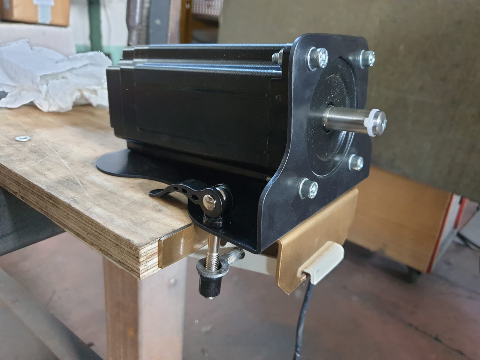

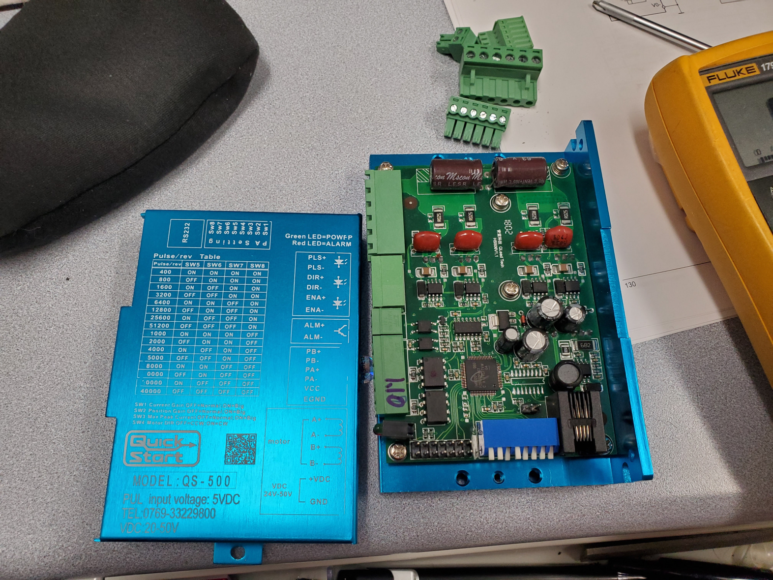

    Hi everyone, it's been a while since I've been trying to self build my DD steering wheel following this guide, I managed to interface the arduino board and stm in fact I can use the steering on ACC, but I have a very big problem, I can't to interface the hbs860h drive of my stepper motor with the pc, so I cannot enter the values indicated in this forum, the result is that the stepper motor blocks and cancels any resistance from it. I tried everything, I bought both the cable with built-in usb adapter and the cable with db9 output for the pc board, every time I try to pair them the pc doesn't see the serial connection with the stepper motor drive. Maybe it's the drive output that doesn't work, I'm thinking of replacing it, but first I'd like to ask some advice from you. It's a nice project I would like to see it work properly. Help me.

    Maybe there is a problem with the cables you are using to connect the PC to the driver. The first one I bought didn't work, then I bought one of better quality, and that worked OK. Also, the cable that you plug into the hbs860h is not a standard cable, the connection is specific for the driver. Best thing is probably to get that part of the cable from the company that sold you the driver.
    Also, the software you use to change the servo driver settings has to be specificly made for the driver, best thing would probably be to get that also from the company that sold you the driver.
    Just a few suggestions, hope it helps...

    The usb cable is recognized by windows and all the required drivers are updated, but the driver of the step motor is not detected, I tried to change the PC but I have not solved it, I know that in order not to abandon the project I have to buy a new driver for the my engine, I thought I was taking hbs86h same as the one you used in your project

    Many of these cheap stepper drives, are missing the RS232 interface chip inside, even if they have the rj12 connector... they won't connect to PC no matter what.

    I checked, it seems that the RS232 interface is there, I'm waiting for a new driver to arrive
