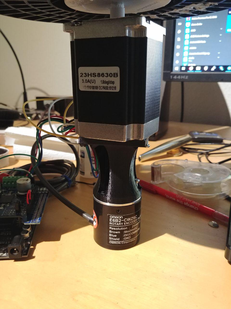

    Okay little update on stepper drive wheels.
    I might have an idea how we could build one better and probably even cheaper than with these old drivers that don't even work for that application.
    Its a shame that mmos is closed source. It would make the project so much easier if it wasn't.
    I plan on making a similiar standalone controller -open source- with a more modern stepper driver that can drive inexpensive high power steppers instead of hard to get servos with super expensive drivers.
    The biggest problem is currently to get any kind of documentation on usb hid descriptors with force feedback. Tell me if anyone has more info about that subject.

    This is probably true that steppers are not the best choice. But afaik the simxperience accuforce uses a "hybrid stepper drive" too which is also just a stepper with a closed loop drive. Maybe they have some advanced regulation to make it smoother.
    If they can do it i am sure there could be demand for an open version.
    If it does not work out at all there might be some other options.
    The choice of motor and how it is driven can also greatly reduce the cogging feeling of a stepper so it does not always feel like you are grinding phantom gears.
    My test setup currently only features a nema23 which feels pretty smooth when freerunning with something wheel sized but a nema42 would be the ultimate goal and that could become a bit rougher.
    Maybe someone with an accuforce can confirm how it feels.

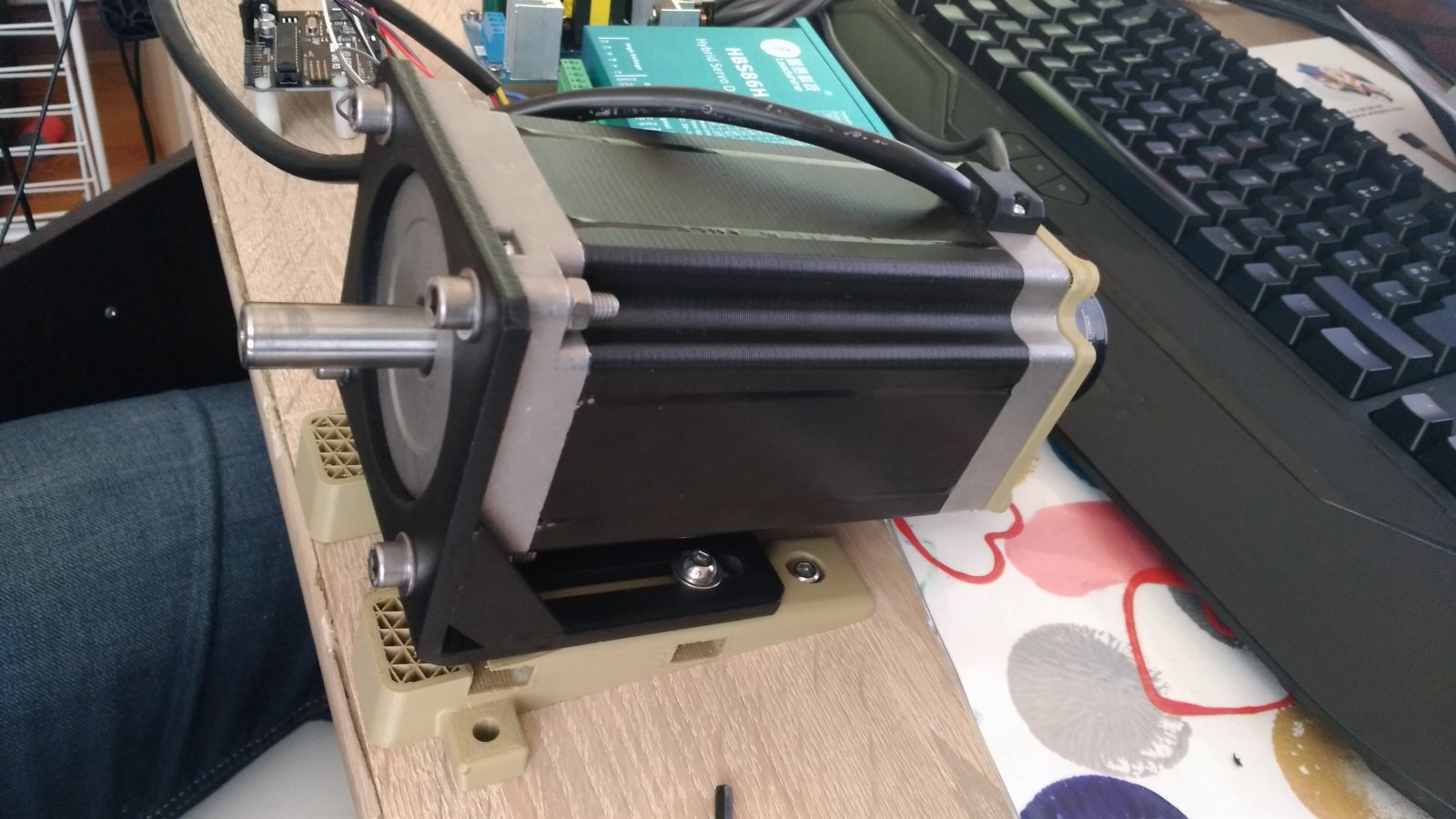

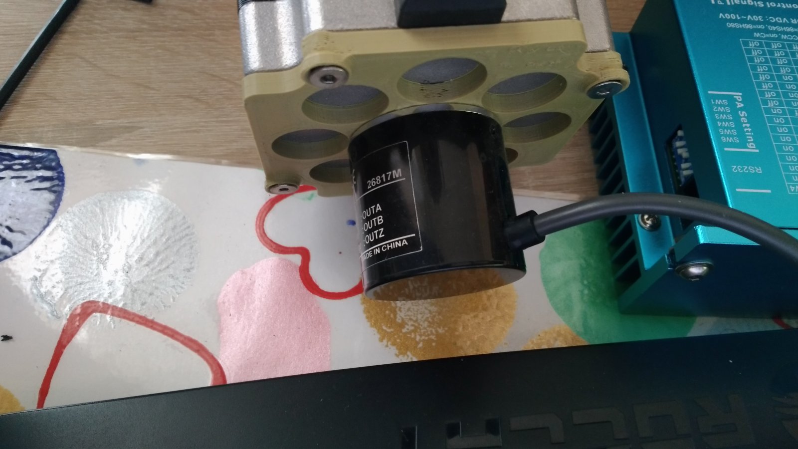

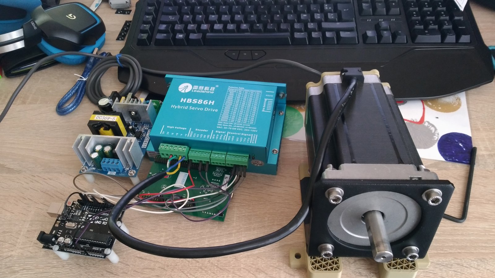

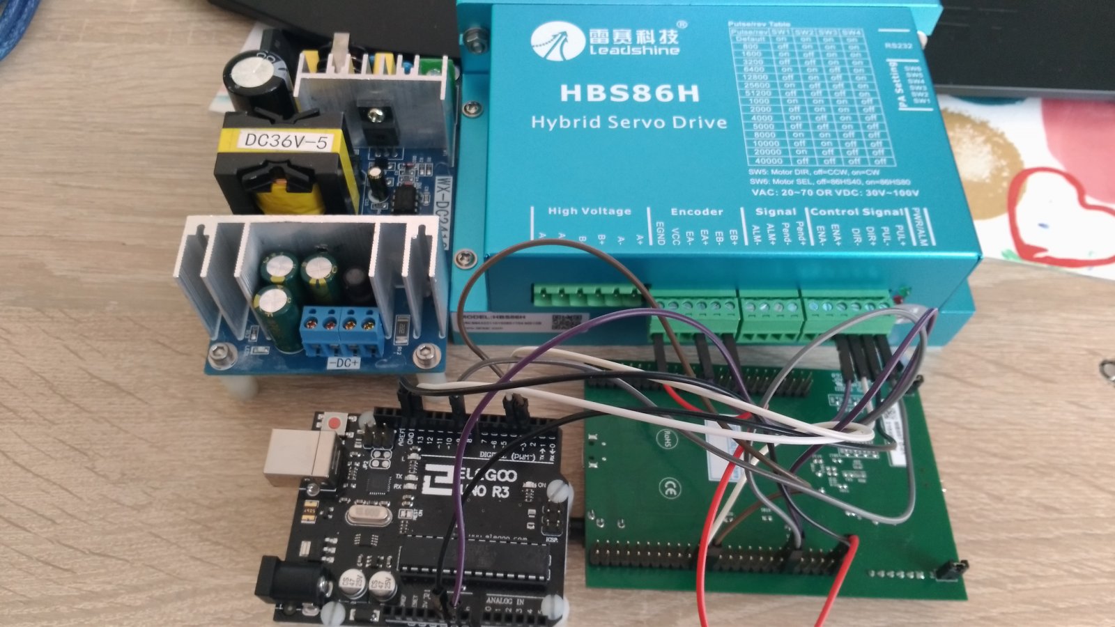

    Hello, I have the same components you have. HBS86H, the NEMA 34 8.5 Nm, I am using an Arduino UNO and a 60V Power Supply.
    How do you wire from the Arduino to the driver?
    For me this seems to work, except whem I change the steps per revolutions. This just work for some of them.
    Pul + to 5V
    pUL - to Pin 2
    Dir + to 5V
    Dir - to Pin 3
    When I asked in other forums I was told to wire in a different way, but didn't work for me?
    I was told to connect:
    Pul+ to Pin 2
    Dir + to Pin 3
    GND to Pul -and Dir -
    But this connection doesn't work for me.
    Thank you.

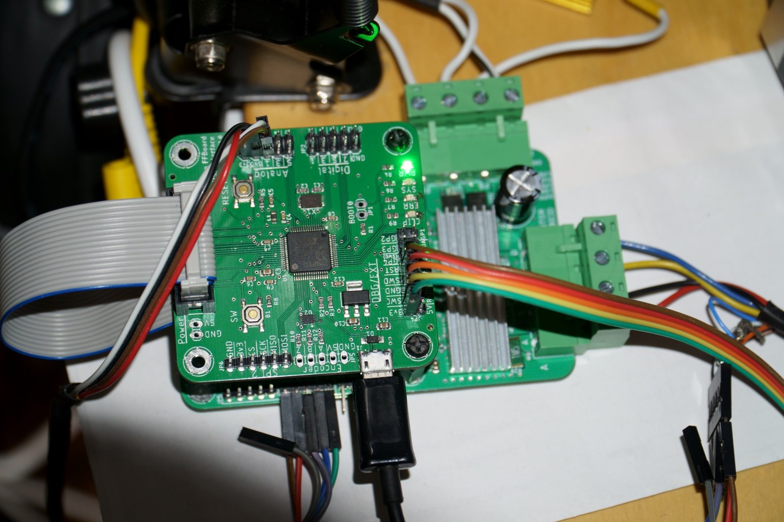

    Since the last time i posted here my project had some major changes.
    It evolved into the Open FFBoard and a new and much more capable motor driver was developed and the project shifted to a universal FFB interface direction with support for different setups, motor drivers and applications.
    The motor driver supports 3 phase servos, 2 phase steppers and DC motors and can even be stacked for multiple axes.
    The software will be modular and allow for many different setups.
    There is a prototype with functioning FFB again:
