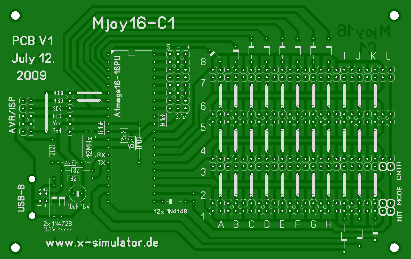

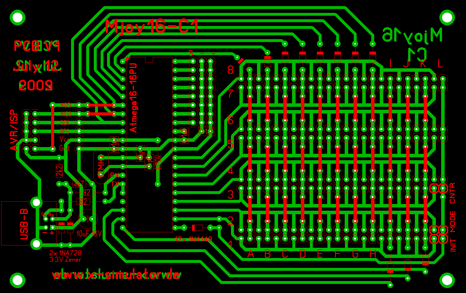

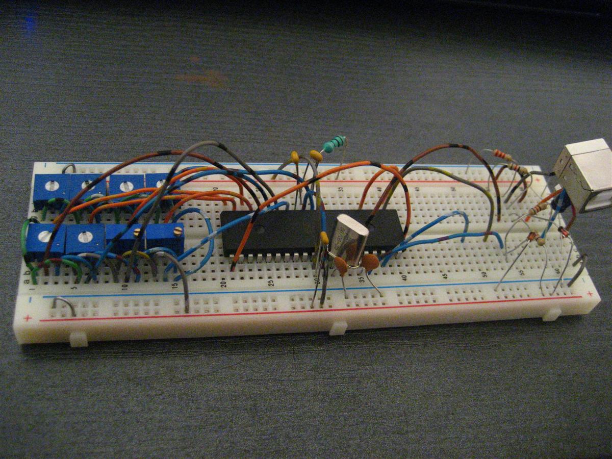

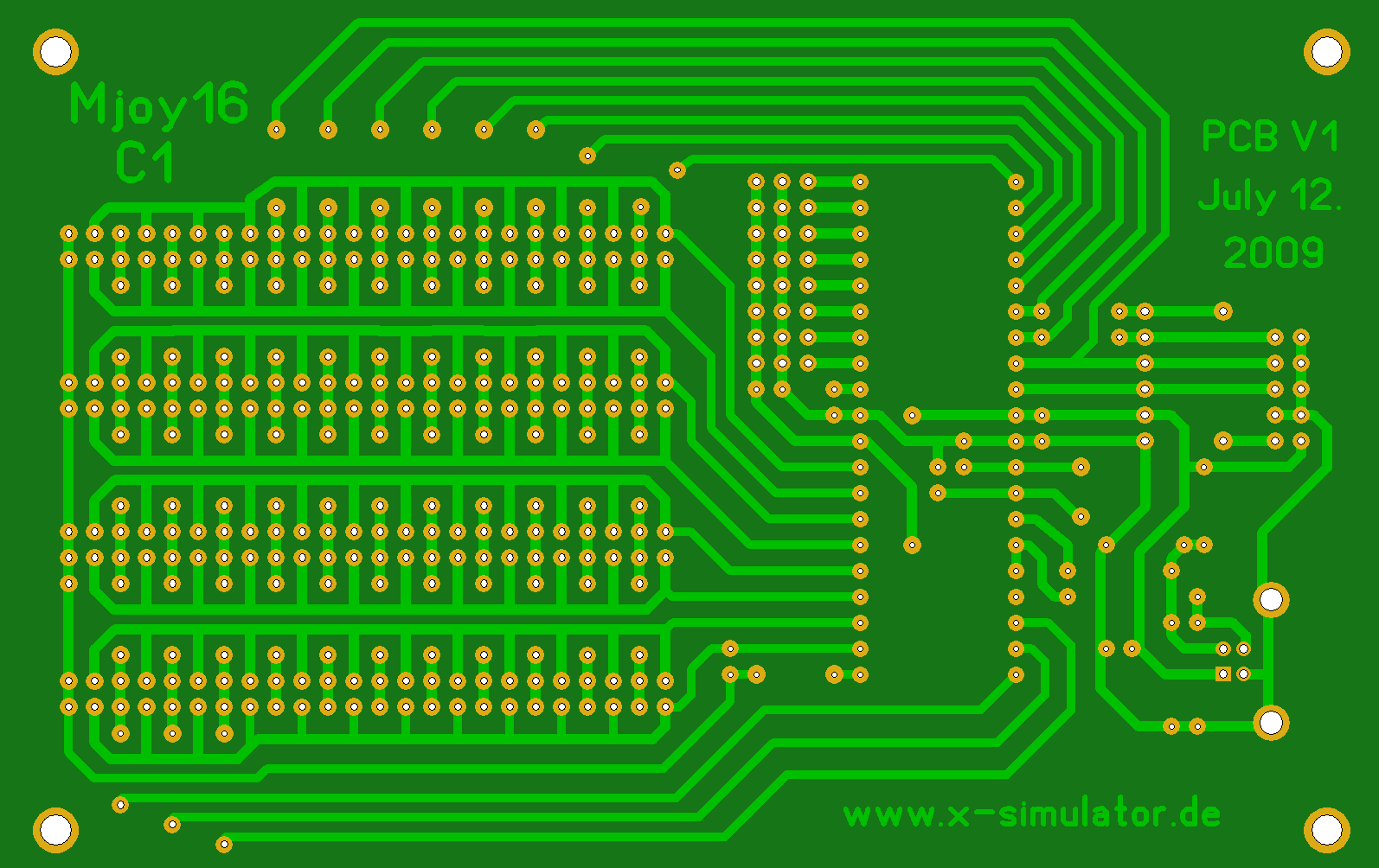

    Here is what I would say the first official version of the redesigned PCB. I made it so it would be easy to make at home with minimum trace width and copper distance of 0.8mm (except at the USB connector), even more where it was possible. I reduced the number of diodes to 12 to make it even simpler and included pads in addition for an INIT pushbutton. The pins for the analog inputs are also changed as Sokol suggested, now a jumper can simply disable them connecting to ground. The crystal capacitors and the inductor are placed inside the IC socket to save room and tight pads/traces.
    The next step will be a separate controller and matrix board.

    Thanks gregers, if you post that board about 2 months ago I may not have started to do this one. There is only one problem with the board you posted, and that is getting it made. For a 2 layer pcb with plated through holes and such tight traces between the pads, this board has to be orderd from a pcb manufacturing company. I designed this board specifically for those who want to make it at home with only what is necessary. It is only 1 layer, minimum copper width and distance is 0.8mm and reduced number of components, and it still only measures 13.5x8.5cm. I could add the additional 8 pulldown resistors without any significant change in the layout too, although that is not necessary because they are connected to ground internally when not high anyways.

    Please note that all my answers are based on my tests with the breadboarded circuit and my theoretical knowledge. I haven't noticed any ghosting or unnatural operation without any diodes or the 8 pulldown resistors, but that doesn't mean anything.
