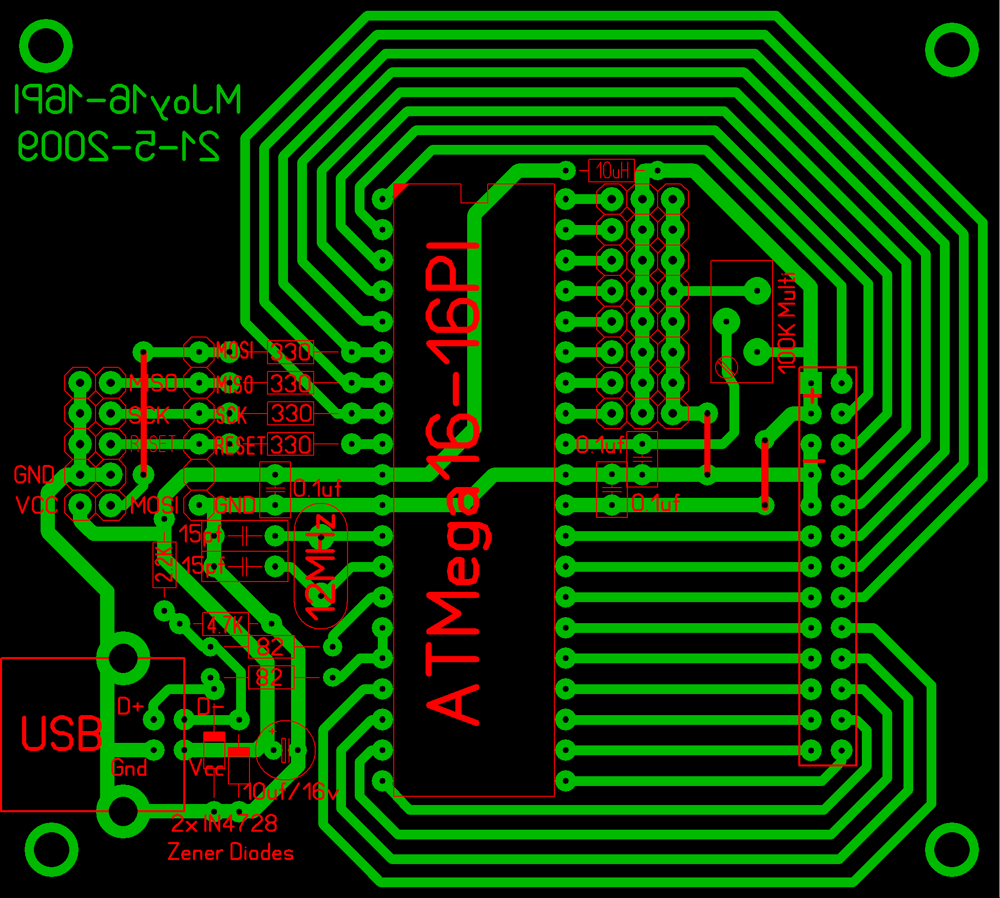

    Hi George,
    You could mount the MJoy 16 board ( without the Matrix ) into a plastic case and mount the D-sub and other connectors on the case, and wire from the connectors on the case to the MJoy with wires. With a lid on the case it would look neat and tidy and then just plug the cables into it.
    Regards Senetor.
  4. GeorgeBoles
    GeorgeBoles Member
    Apr 27, 2009
    66
    4Coins
    +2 / 1 / -2
    Use AVcc instead of Vcc
    Hello Chaps.
    This might be important. I notice on Mindaugas' schematic and on his PCB that the analogue ports are fed their voltage from AVcc - from pin 30. On the PCB that we have been playing with, the analogue pots are being fed by Vcc ... I think a lower quality, less filtered voltage source. Perhaps that should be fixed.
    If we are going to fix that, should we also make the 100k trimmer potentiometer work on AVcc rather than Vcc?
    Hope this helps.
    George.
  5. Senetor
    Senetor Member
    Oct 23, 2008
    90
    Australia
    595Coins
    Hi George,
    Like this,
    Regards Senetor.

    595Coins
  8. GeorgeBoles
    GeorgeBoles Member
    Apr 27, 2009
    66
    4Coins
    +2 / 1 / -2
    Dear Senetor,
    Yes, that looks better.
    Regards,
    George.

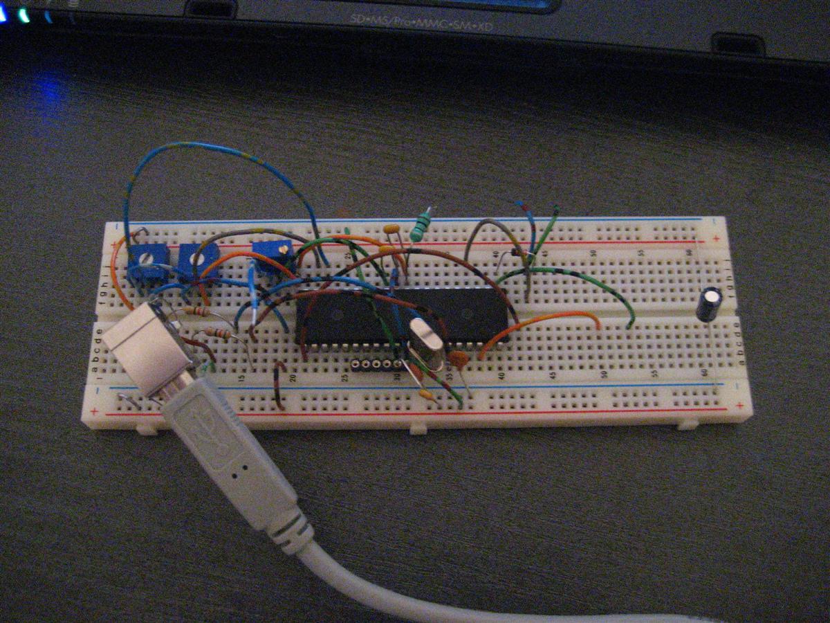

    Has anyone tested the schematic?:) I'm getting the parts tomorrow if all goes well. I'll try to get everything together in the next couple of days and see how the firmware works. Btw, is there a programming file available with the source code (other than the hex file)?

    Allright! I just programmed the circuit and it seems to be working properly. Just a quick glance, I still have to test it more thoroughly.
    Windows only recognized it with 32 buttons + 1 hat switch by default. So far I hooked up only 2 analogs at the same time, the second one controls the rest of the 8 axis. I also noticed that the Voltage at the ARef pin doesn't respond according to the pot, it is either at 0 or 5V +-1%. At this point it is completely useless, I'll try to get it working if possible.

    Senetor,
    Some comments about you PCB revision:
    The 10 pin header and associated (4x) 330k resitors of original Mindaugas layout is usefful in PCB only if a ATMEL Programmer is used.
    If you dont have a ATMEL Programmer and instead use a LPT1 cabble, put the four 330k resitors in cabble. Like in this cabble assembly by Tsinik:
    http://aviasimrus.spb.ru/forum/showthread.php?t=1014
    Note his miniaturized PCB (52x34mm).
    So, you reduce some traces an can use these resitors to programm more than one Mjoy16. :yes:
    To avoid gosth buttons, is usefull put a (8x) 10 resistor bridge between collumns (pins 22 to 29) and +5v.
    Like in Sundowner (Poly) revision, see under ATMEGA16:
    http://obrazki.elektroda.net/4_1237862153.jpg
    Is usefull too put jumpers with diodes (1N4148...) between pin 21 and 22, 23, 24 to select Init, Mode and Center functions (see in Mjoy16-C1 manual). Or put these jumpers in key matrix board, if used.
    Note: all these PCBs revisions/variations use the same original Mindaugas eletrical scheme and firmware (MJoy16-C1_SW_v1.3).
    I see that you put a 100k Multi (trimpot?) between +5v AVCC and Ground, what advantage in use these?
    Edit-Find the answer in the topic: 2. Analog reference adjust pot is definitely in order, since there are some sensors out there that can be used and output only 3.3v (some ratiometric hall effect sensors for example). With reference adjust pot you can measure the full range out of them!
    Thank you.
    S!
    Sokol1

    Sokol, thanks for your input!
    About the svmapper: The firmware already has the toggle switches and encoders programmed so it only sends a short pulse for a change on the designated input. It is useful when using a single button, which also saves 1 input. Definitely good to have the extra options.
    About the circuit: I have already made changes to the last drawing posted to implement the changes you mentioned. The number of diodes could be reduced to 12 or 8 instead of 112. Currently I'm using no diodes or resistors whatsoever on the protoboard for the key matrix and I haven't experienced any ghosting. The 100k trimpot is there to set the reference voltage for the ADC of the IC, but as I mentioned it does'nt seem to have any effect. It either goes to 0V or 5V so I also have it removed until I can get it working.
