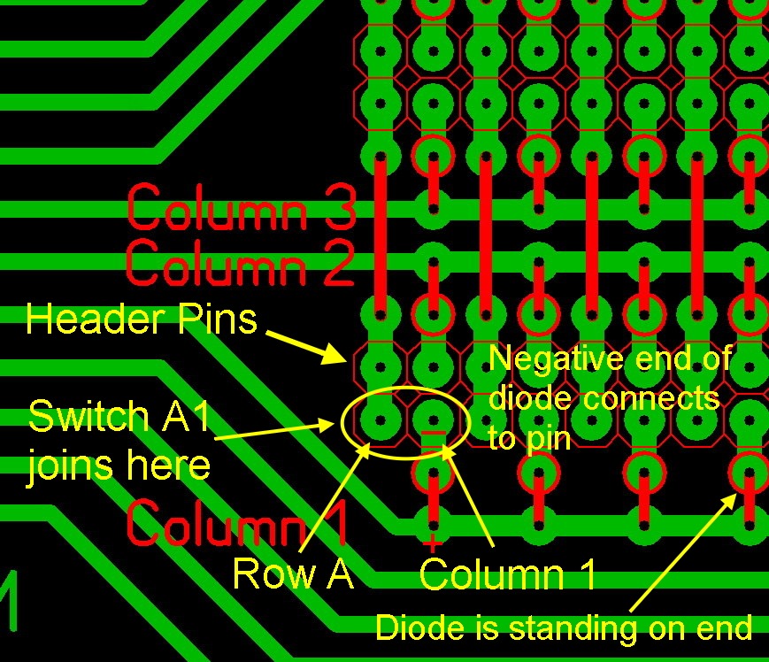

  3. GeorgeBoles
    GeorgeBoles Member
    Apr 27, 2009
    66
    4Coins
    +2 / 1 / -2
    Good Evening Folks,
    I have just started drawing Frakk's and Senetor's board onto Circad 98 (the program I use to draw and print circuit boards). I have been going to make the MJoy16 for a long time and I only just starting drawing it as Mindaugas did in the original work.
    Some questions:
    1. What trace width do you recommend for the connections between the 26 pin jumper and the Atmega chip? I use Toner Transfer to burn my circuit boards and Mindaugas looks like he used 0.5mm traces which do not turn out too well with that process.
    2. Have you drawn up a table of button presses for the Matrix board yet?
    3. I hope that an Atmega16-16PU will work, even though the original code was for Atmega16-16PI which I cannot find.
    4. Is there anything new in the .hex file which I saw earlier, or is it there to help someone else out?
    5. Don't you also need a .eex file too, like Mindaugas originally published?
    Please continue this good work. The MJoy 16 looks really useful.
    Regards,
    George.
    (Australia)

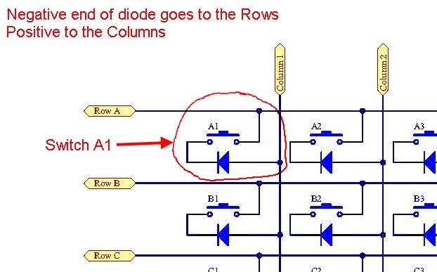

  16. GeorgeBoles
    GeorgeBoles Member
    Apr 27, 2009
    66
    4Coins
    +2 / 1 / -2
    Hello Chaps,
    I have not quite got my head around the diodes and matrix thing. I am just trusting everyone's advice.
    I have been busy designing my version of the project. I am going to have to use mainly hard-wiring of the switches in my old CH Joystick and throttle (otherwise there will be too many wires between the joystick and the throttle), but I will have the option of a smaller matrix for later additions.
    My question:
    On the matrix diagram it appears that the diodes only go on the columns, with the anode of the
    diode facing the column and cathode facing the switch. In other words the diode comes on the postive
    side of the switch, like this:
    Column --- (+Diode-) ------- Switch ------ Row (As in Mindaugas' original diagram)
    Does it matter if I put the diode on the negative side of the switch does it, as long as the diodes
    are still anode to Column and Cathode to Row? Or like this:
    Column --- Switch------- (+Diode-) ------ Row
    Would this option work, or would I get phantom button presses coming up?
    All advice greatfully appreciated,
    Regards,
    George
  17. Frakk
    Frakk Active Member
    Apr 15, 2009
    1,144
    328Coins
    Hi George
    The position of the diodes doesn't matter, only the polarity. The matrix key system is basically a scanning operation. The IC progressively outputs a voltage (high) on the columns, and scans on the row's for any high input. If a voltage input is detected, it records the column that the output was high on, and the row that the input came in at that particular moment. These two numbers define the exact switch that was pressed and this data will be sent to the pc. The diodes will prevent any reversed voltage and current, and also introduce a .7V forward drop to block any noise and interference under this voltage.
  18. Senetor
    Senetor Member
    Oct 23, 2008
    90
    Australia
    595Coins
    Here's a couple of diagrams,
    Regards Senetor.

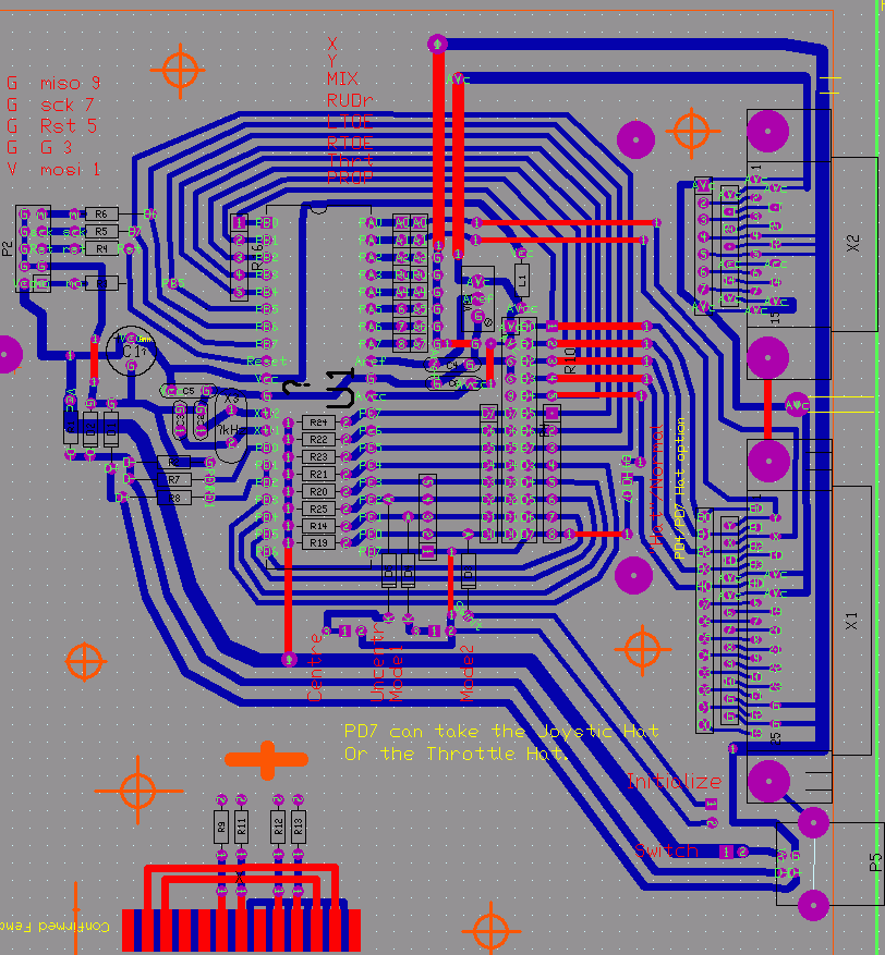

  20. GeorgeBoles
    GeorgeBoles Member
    Apr 27, 2009
    66
    4Coins
    +2 / 1 / -2
    A PCB design to put MJoy in CH ProThrottle
    Hi Folks,
    This is my project as attached. The board sits within my CH Pro Throttle base. The top 15 pin Dsub takes information from my CH F-16 Fighterstick, the lower one takes information from my rudder pedals and up to 25 other buttons (none of which I have) and the other connectors take the information from the Throttle itself. I think the wiring is correct, but if anyone would like to check it I would appreciate it. (I have yet to join the Ground wire to the USB pins. I also have to put in jumpers to cope with Centre, Mode, and and On/Off button - the last one so that I do not have to connect/disconnect the USB port to work the initialize and re-centre functions.)
    I am going to have little flying jumpers (made from ribbon cable) for many of the connections from the 15 pin Dsub connections, especially if I stay with a single sided board.
    As for the diodes, you are saying that they are just to help eliminate little spikes as buttons are pressed and released? That would make sense, because otherwise I could see no logical reason that we should need them. (Edit: see later posts. The diodes and some hidden 10k resistors are very important)
