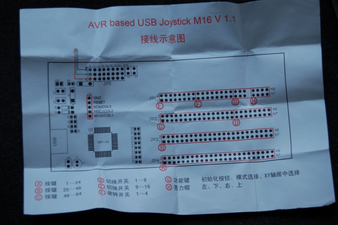

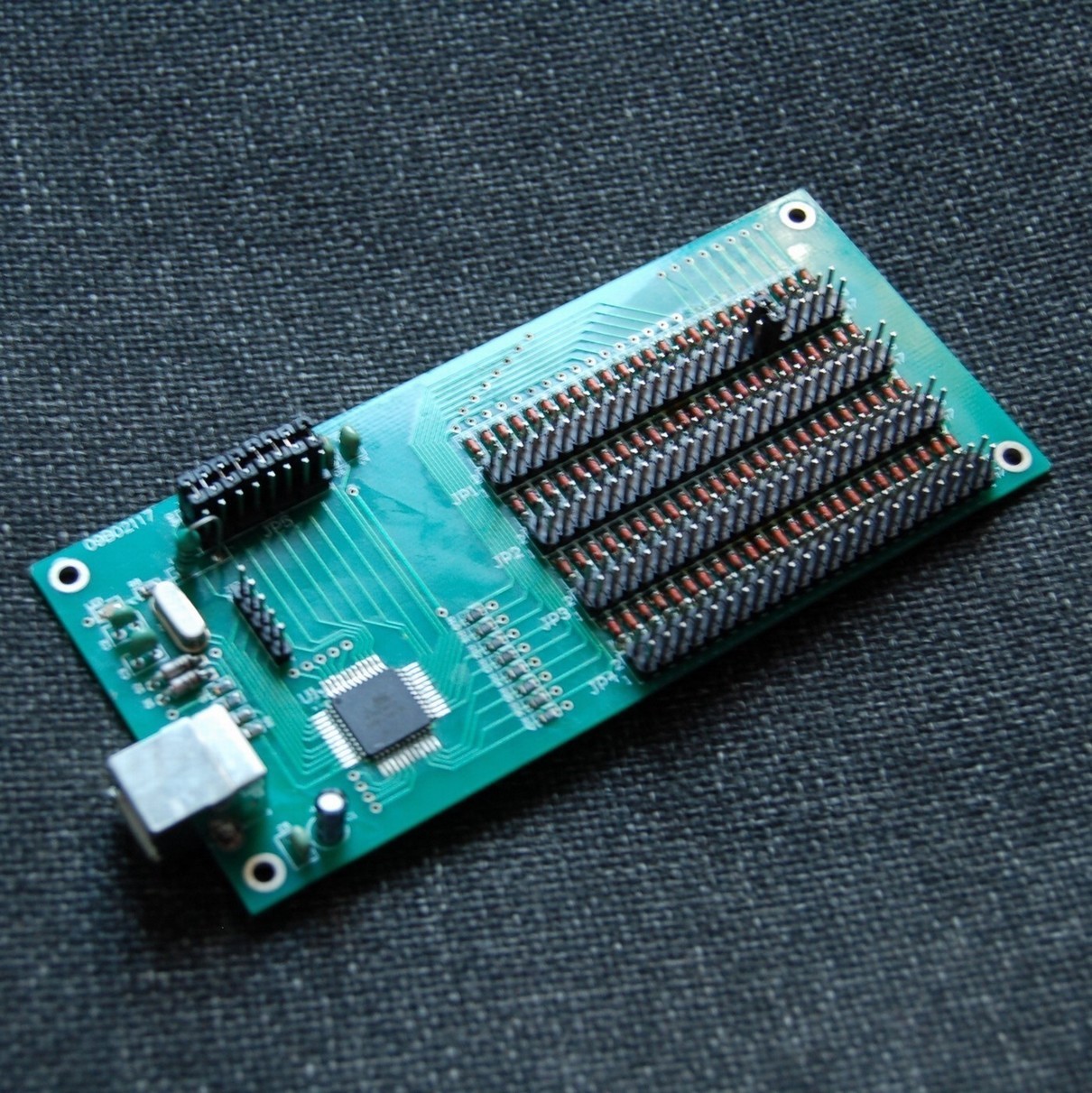

    Good Morning/Afternoon all.
    I came across a website which appears to be selling a prebuilt MJoy16 out of china. I've tried using a google translator as it is in chinese, but it works poorly at best. I have a neighbour who has relatives that may be able to find out more. If you look at the pictures, the second covers the headers, so I think it may have 8 analogues, 64 buttons, ?16 toggles, a ?hatswitch. minimal components, an ISP header. Seems to cover all bases. For those interested, here is the link:
    http://ershou.taobao.com/item.htm?spm=2 ... 0450432927
    There is another product that they sell, but seems to only cover the analogues
    http://ershou.taobao.com/item.htm?spm=2 ... n_list.htm
    Anyone read chinese?
    Thanks,
    Rob.
  15. Rjfon1
    Rjfon1 New Member
    Aug 21, 2012
    1Coins
    Here are the pictures of the device in the attachments
    Rob.
