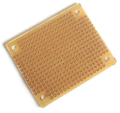

    Tirta, complementing:
    Yes, the suffix dont make difference, PU is the latter revision, to attend
    European legislation - doesn't use lead.
    Original CH pots are 100k - you can continue use them, with shield cables.
    Is the the thing labeled I=10uH, above 4,7k resistor.
    Some clarification: My layout is based in Tsinik one, optimized for components that I find locally - a little big of some that he used. And intended to fit inside josytick base - including the narrow base of Suncon F-15.
    Tsinik layout: http://www.aviasimrus.spb.ru/forum/show ... php?t=1014
    In Mindaugas layout these 8 x 10k resitor (pull-up) are in the board Keymatrix.
    I just move these to Mjoy board. Work in the same way.
    Note that original Mindaugas layout are oriented to build control panel for Flight Simulator. So is convenient use keymatrix.
    Sample: http://img90.imageshack.us/img90/8483/img9381.jpg
    Keyboard matrix is desirable if you build a panel, but not if you are rewiring joystick
    because increases the amount of wires a lot - two wires leaving USB board to every button/HAT. Without Keymatrix you combine wires, ie Row 1 go to button 1, after to button 2... 8. You wire the butons and HAT of CH Flighstick with 10 wires (HAT use dedicated Row) , if use keymatrix you need need 16 wires.
    330 Ohm is used only for programming (write firmware), so is no reason to put this permanent in Mjoy board. I put in LPT1 cable, that allow me to use the same 330 Ohm resistor to program vary boards, Mjoy8 or 16.
    Is convenient put these 330 Ohm resistor in Mjoy bord, if you have one ATMEGA Programmer, so your cable match with 6 pin connector in Mjoy board.
    If you dont have, you need build a LPT1 or Serial cable, so put these resistors in him.
    My LPT1 cable, with 330 Ohm resistors inside DB-25 case:
    Plugged in one Mjoy16 board;
    Or you can build a programmer board only with a 40 pin soket and 330 Ohm resitors: like:
    This programmer explain that major errors found in Mjoy is not related to programming.
    Is related to hardware: fault in Mjoy board assembly.
    Same explained above, these diode for jumper Center (to turn of autocalibration) stay in Mindaugas Keymatrix. I move to Mjoy16 PCB.
    I dont leave place for jumper Mode (invert position for toggles switch and encoders) - for joy rewire is useless.
    Note: are a bug in Mjoy16 firmware, in MODE2 some buttons dont work: 73 to 112 and HAT - but this mode is oriented to prioritize use of Encoders and Toggle Switchs.
    Put two pad for remote place of Init (reset) Jumper - dont make sense put this Jumper in board inside joy. How use this if is inside?
    Ooops, my mistake, are only two 15pf capacitors, I labeled one 3,3 Zener diode as 15pF... :blush:
    Better labeled:
    Is these connected to 1N4148 diode. Autocalibration is active for default, if you close these jumper is disable.
    Pins for connectors to buttons, pots, called PCI pins, I think.

    The black base is 40 pin IC socket , listed in Mjoy16 part list as JP2, fit in any Mjoy16 layout. Prefer machined type.
    Is used to avoid solder in ATMEGA pins, that with manual solder probable damage the MCU.
    Sample: http://www.soldafria.com.br/popup_image.php?pID=574

    I have opened the base of CH flightstick today and measure the space where I am going to put mjoy16 pcb.
    I am sorry to tell you this, but I find that your layout width 35mm is slightly too long,
    could you draw the layout again and make the width 30mm?
    The length is OK, 70mm or 80mm, no problem.
    I think I am going to use your layout since others are bigger,
    so it makes it harder to fit inside the joystick.

    tirta, have you thought about making the circuit on a perfboard?
    http://www.westfloridacomponents.com/mm ... board2.jpg
    They sell these in different sizes and you can always cut them. You can put the components on the board basically anywhere and make it whatever size you want. There are of course practical considerations, but in general you can make surprisingly compact circuits on these with through hole components.
