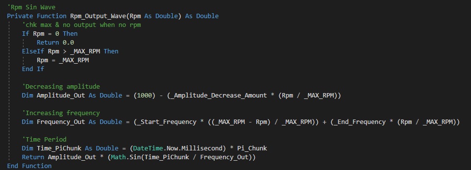

    I'll see what I can do buddy!
  3. yobuddy
    51,769Coins
    +5,206 / 19 / -0
    I think i got it for LFS.
    Here you go @Thanos!
    (This is the dll only)

    Just playing with your solution on x-plane
    I had to adapt some variables to fit my cessna 2500 max rpm and increased max and min oscilations
    I use 3 percent on heave axis and 3000 value in Tunning Center
    Well done Man. congrats!

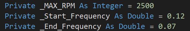

    short RPM test:
    I reduced to 1 percent on heave axis and 2000 value in Tunning Center
    We would need a code which cuts down the sine below a certain frequency as its wired when it continue to oscilate with engine off as well or even when the game is paused.
    Anyway I think its a valuable feature.

    Try This,

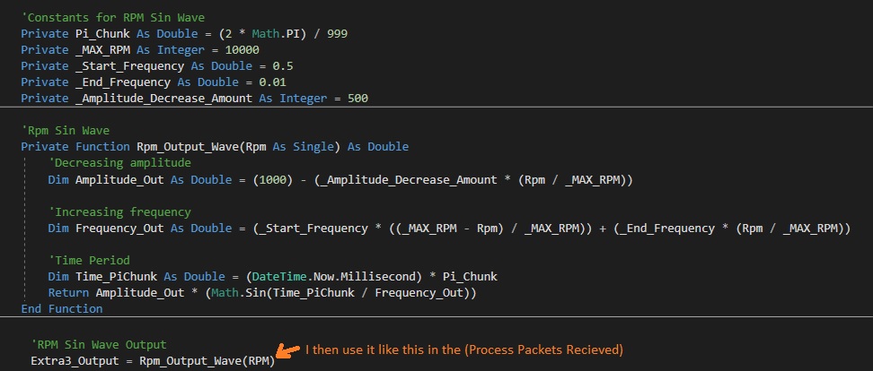

    Concerning X-Plane, I can finally get great results readapting 3 variables this way:
    In this plugin (2.1.0.0), I moved the yaw accel. from Extra3 to the Yaw slot (Yaw pos.) putting RPM in Extra3 now.
    I have a very good RPM vibration response for propeller aircrafts using 10 percent in the "Game Engine" and 50000 in the "Tuning Center"
    For those who care, I recommend updating min/max values to avoid confusion.
    Also, please change the UDP port from 4123 to 49000.
    Thank you @yobuddy for making it possible.

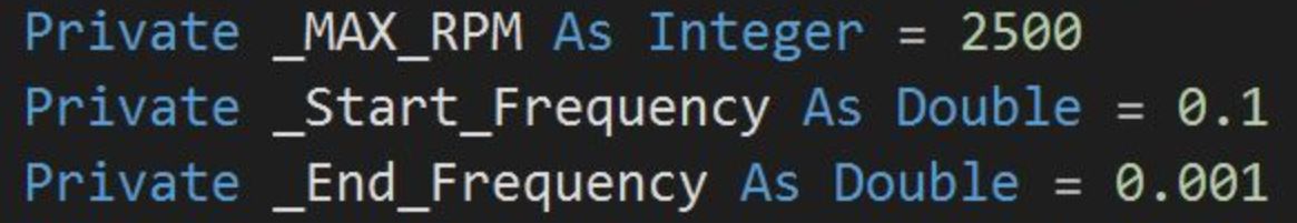

    I can confirm that this experimental Dirt Rally plugin works with Engine RPM - I used a Max/Min of 7000RPM and about 15% axis assignment in DOF.
    I would say the output seems to me too low frequency, especially when idle, although it does speed up with the car moving off the line.
    I initially had max.min at 900 RPM and the actuators in the menu/car idle were like a trampoline. The engine rumble at idle should be of higher frequency.
    Overall a really encouraging start @yobuddy !

    The start and stop frequency is totally adjustable in the code.
    We just need to know what works best is all.
    Same with the amplitude.
    Maybe do an auto capture on the RPM output as I don't think it goes up to 7000?
    If you only assign 1% of it to an axis it should not be to trampoliney.
    LFS would be a huge pain, but I could do any codemaster game for a test.
