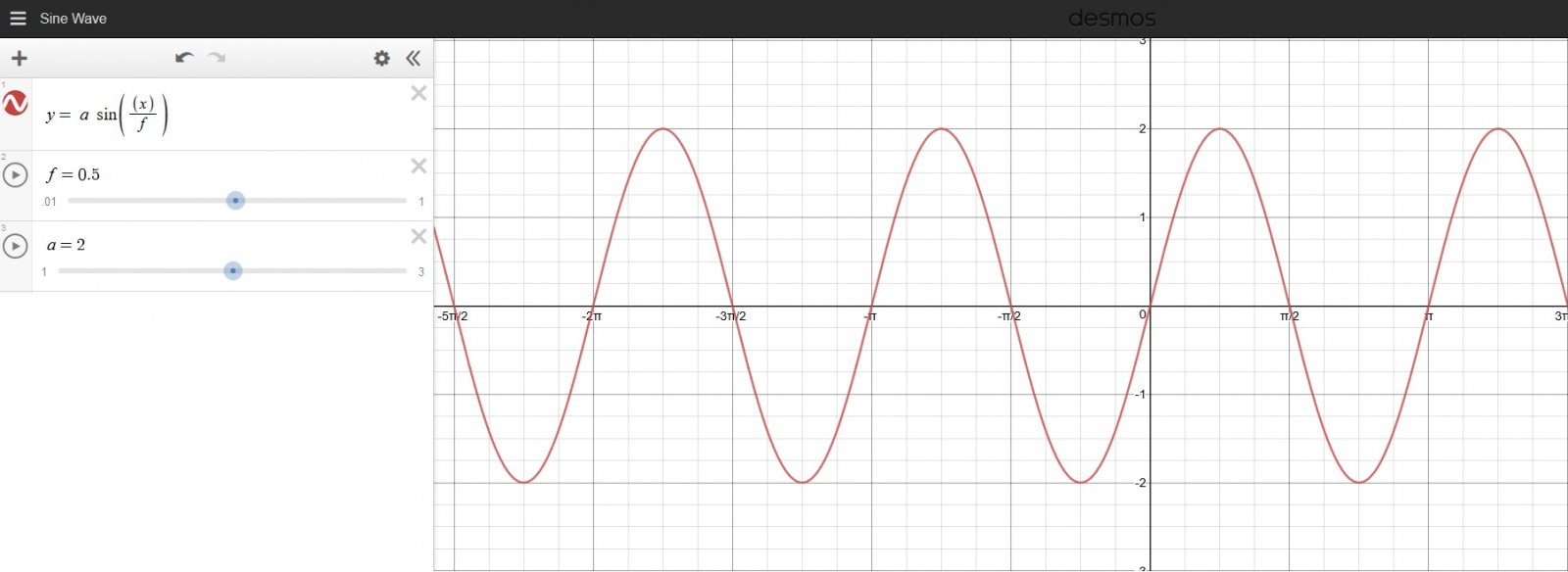

    I was directly referring to games that can output tire suspension information that is a little more detailed and different on each of the four actuators if used on a 4dof:
    Each of the actuators will be able to reproduce tire suspension vibration motion, as it not so much high frequency, perhaps up to 75hz in low amplitude levels. But if you mix normal roll, pitch, heave axis data into the actuators as well, the higher amplitude sustained positions that these provide will not allow the motors to be within 50% of total travel for the lower amplitude tire suspension motion to be visible. It will simply clip out.
    Think of a normal sound speaker, if you place your hand on it and hold the membrane displaced from its center, the sound comes out muffled.... same thing happens to the vibration motions.
    The solution would be if we can shift the small amplitude vibration signal up or down following the larger sustained motion of the actuator while mixing.

    Yes buddy, this is what I am saying, it will work just like your drawing.
    Yes, it will work like this.
    (Say we only need heave on a acuator as to make this example easier.)
    If in axis assignments we assign "heave" at 70% and we then assign "ride height" at 30%, we have exactly what your graph is showing and no clipping will occur.
    I was trying to explain that we need to find the best way to create this "vibration data" as to make it available as an extra dof in the plugin.
    For RPM we could maybe try a sin wave?
    For Road Noise, "Ride Height", or whatever you want to call it we just need some experimentation to see what works best.
    (take an average of or use the biggest input etc..)
    You actually need to (take an average of or use the biggest input) the 4 suspension corners and move them all the same.
    Or your sim will kick like a mule, and at times, only 2 legs may be touching the ground.
    In short, we just need to do some experiments to see what works.
    Take care,

    We need to figure out a formula for turning rpm 0 thru 10000 say into a sine wave.
    Something where the frequency of the way goes up with higher input, but the amplitude maybe falls a bit with input.
    So maybe it outputs a sine wave with a amplitude of -100 and 100.
    But at a rpm of 10000 it is at -75 and 75.
    And the frequency should go up with higher input.
    The output from something like this could be sent thru a plugin as a dof, and we could see what happens.
    So, do you have any idea on the formula needed?
    We may need to brush up on geometry a bit. lol
    Chat soon,
  7. yobuddy
    51,741Coins
    +5,205 / 19 / -0
    Here is the formula for RPM I believe.
    Where (a) is the amplitude we want
    (f) is the frequency we want
    And (x) is the looping input between 0 and 2π.
    Next is to figure out how to get the amplitude and frequency we want when RPM is zero, and when RPM is maxed out.
    Take care,

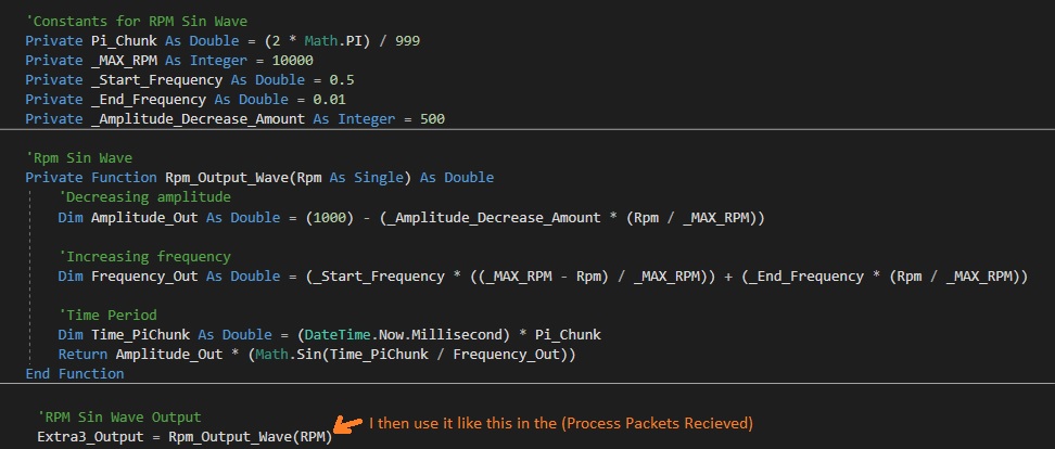

    I think something like this would work.
    ‘Constants
    _MAX_RPM = 10000
    _Start_Frequency = 0.5
    _End_Frequency = 0.01
    _Amplitude_Decrease_Amount = 500
    ‘Mock Code
    RPM = Current RPM input
    If RPM > MAX_RPM then
    RPM = MAX_RPM
    End if
    ‘Decreasing amplitude
    Amplitude_Out = (1000) - (_Amplitude_Decrease_Amount * (RPM / MAX_RPM))
    ‘Increasing frequency
    Frequency_Out = (Start_Frequency * ((MAX_RPM – RPM) MAX_RPM))) + (End _Frequency * (RPM / MAX_RPM))
    Then with the constant vars, we could tune in what works best for the output.
    _Amplitude_Decrease_Amount can be adjusted to loose as much amplitude as we thing we need it to. (at 500, it will loose half its amplitude at rpm = 10,000)
    Same with the rest, once we find formulas that work well.
    Take care,

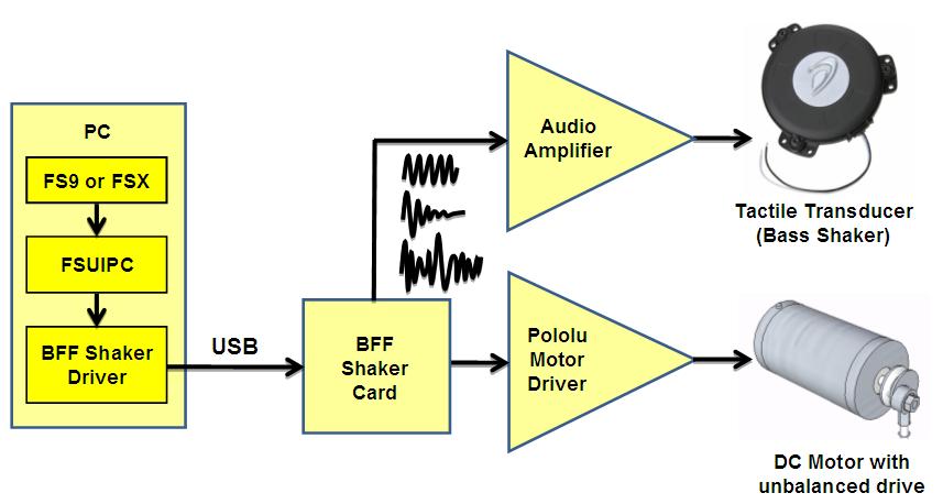

    @yobuddy I don't know too much about flight sim, but like to learn and build one too.
    In terms vibrations, Ian Hopper already did mixing freq from the games, that feed via USB to the BFF card. I guess one may not need to use the card, you and Ian Hopper can write a plugin so that his output can be via SimTool. Can you?

    This won't work though. There's a missing operator and brackets are still open.
    It appears it should be:
    Frequency_Out = (Start_Frequency * ((MAX_RPM – RPM) / MAX_RPM)) + (End _Frequency * (RPM / MAX_RPM))

  14. joe extraknow
    joe extraknow Member Gold Contributor
    Jan 4, 2017
    111
    United States
    1,550Coins
    +40 / 2 / -0
    I meant SW, not HW. See the video at 8:30
    The plane cabinet vibrations are very complex, which are “event driven”, not simply “rpm driven”.
    However, for engine vibration, it sees you are doing similarly, but you use only two frequencies instead of three.

    @joe extraknow,
    What up buddy,
    Always nice chatting ideas, let me go over a few things and see if this makes more sense.
    Keep in mind that all of the outputs already affect the main telemetry stream. (roll, pitch, heave, yaw, sway, surge).
    So all of these actions would already be on the sim in some fashion already when tuned correctly.
    We are simply testing out amplifying the RPM vibrations (for some geeky fun).
    Rpm is event driven also as it depends on the users input?
    Come to think of it, everything is event driven, as it all depends on the users actions?
    I'm using 2 end frequency's, but the output would be all frequency's between these to values.
    Chat soon fellas,

    I see now what u r trying to do.
    I don’t think you shall use all frequencies. Using one or two, or max 3 freq would be proper. The “engine vibration” is a resonance frequency of chassis/cabine due to engine rpm.
    If you use all, then feel like “white noise” though. Anyhow, great work, enjoy your stuff!

    Here is a Dirt Rally Experimental plugin with RPM enabled as Extra 3.
    For those of you that like to see code, here is what I used.
    As you can see, I'm using the milliseconds from the PC as to achieve a constant loop timer.
    Now we just need to find the best overall Start and Stop frequency to use.
    And how much the amplitude should decrease when the engine is revved up.
    I would suggest you add 10% or so to the axis of choice to start with.
    (I think with this, less is more.)
    And maybe auto capture some Min / Max values for Extra 3, as none are provided with the plugin.
    All feedback is welcomed, as i have only tested that it spits out the data like it should.
