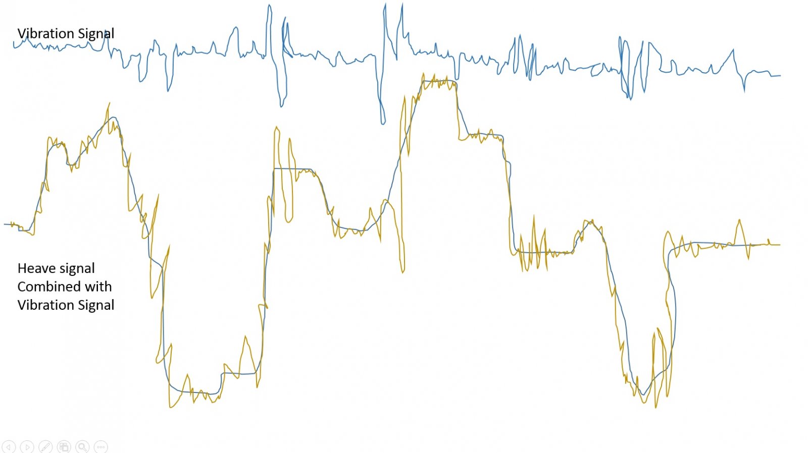

    I'm not sure if this is the correct place to ask this, but is there way to mix vibration data from tire suspensions into normal axis? Let me explain:
    Because of the limited acceleration of the motors, some vibration data might filter out or clipped or not appear at all if mixed to normal motion cue data like heave for example. What it needs to be done so all this extra vibration effects to be able to appear on the actuator along the normal heave effect, is to have the vibration data with limited height and offset them to follow the mean value of the heave motion line. See this "hand drawn" example:
    Right now such options does not exist that can do such mix of axis. Is it possible to be implemented? @yobuddy

    I'm not saying it can't be mixed, I'm suggesting a way to mix it that makes sense for the motor, since otherwise the acceleration delays will filter out the vibration motion. I'm just suggesting adding a special field that the user can define how and where these vibration data can be mixed.
    for example:
    game effect: "Vibration1 "
    Effect Height: 10% of axis
    Effect Center +5%, -5% of axis
    Follows value line of: Axis 1
    "Axis 1" filtering: Filter frequencies peaks above 10hz.

    All I'm talking about is an idea to implement a special filter that would mix low amplitude signals with higher amplitude, in a way that would not filter out the lower amplitude signal because of the difference in height.
    It doesn't have to do with frequencies of the two signals. Just looking for a way to have the smaller signal follow the trajectory of the larger signal.

    When you mix the 2 dof's in the axis assignments section of GameEngine, it would do exactly what you are looking for.
    Say you mix 70% heave and 30% RideHeight, it would mix them just like your example drawing.
    Take care,

    Did anyone pay attention to the drawing i made in the first post? The issue is the larger amplitude of the larger signal, naturally clipping out the smaller signal because of the difference.
    Mixing could work for audio where the center is fixed, but for sustained positions of the actuator, say ROLL during a turn for example, will not let the actuator perform the smaller signal that naturally needs the motor to be near the center...
